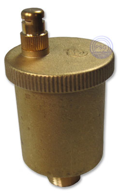

Thinking outside the box, literally :rofl2: ... would one of these work in the return line, rather than butchering the lhm box spiggot?

Great. Fantastic. What is it ? :-D

electronmirror

Unread post by electronmirror »
It's an air eliminator used in hydronic heating/cooling systems :)

Its an air bleed you'd get in your central heating/solar heating system.. it bleeds air out of the system..I know this one is probably only good for water, but maybe there's one that's oil compatible?

This got me thinking that ther must be a commercial oil air separator.. there are but much too big for this requirement. I ran a search on EBay and came up with this.
http://www.ebay.co.uk/itm/390690984189? ... 1423.l2649" onclick="window.open(this.href);return false;
Would this work to separate the LHM and air?

The problem I can see with an external air separator (apart from where do you squeeze it in beside the tank ? Space is limited and the pipes have pre-formed bends) is that even if the oil flow through the pipe is air free the high velocity of the oil entering the tank and the small catchment area inside the filter means that the oil is highly agitated (vortices circulating within the filter) causing the oil to become aerated within the tank itself.
I think part of why cutting the return pipe short works is because it keeps this turbulent vortex higher up in the oil away from the bottom where the pump draws its oil from - the oil and air bubbles swirl around in the top of the tank (with bubbles escaping through the oil surface) but the bottom where the pump pick-up is is relatively calm and free of bubbles.
It's not clear how much of the air bubble problem is this turbulence within the tank and how much is air bubbles in the return line - I think it's a bit of both. An external air separator only addresses one of the possible causes.
The ideal solution would be a redesign of the tank - the small size and shape of the return filter, the layout of the tank and return and pickups is not well designed and does not have sufficient de-aeration ability for the flow rate. If you look at the tank in an older Citroen (GS/CX vintage) the tank design and internal layout is totally different, not to mention the lack of anti-sink makes the suspension fully self bleed each night. That's why it was never a problem until the Xantia.
Anti-sink severely limits the self bleeding ability of the system combined with a poor tank design that doesn't give sufficient isolation between return and inlet. (Although there are two gauze filters in between the return and inlet they are very close together in the tank, only an inch or so apart, near the bottom) All you need is a bit of extra air to get in somewhere like a leaky return line and start circulating around and around and things spiral out of control.
There should have been a partition between the inlet and outlet in the tank with a convoluted path for the oil to flow around the long way - or inlet and outlet on opposite sides of the tank.
