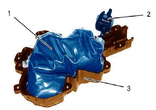

I don’t think this is possible because with the refillable tank you have venting for the air to escape whilst filling that you don’t with a bag. The bag needs to be disconnected and replaced and can't be filled in situ as far as I can tell:

That's very useful picture. What is figure 2?
I think there's no need to vent air from the bag. As the liquid quantity in it decreases, the pouch collapses and doesn't let any air in... So if you get refilling bottle connected via pipe you basically transfer liquid from one container to another without air being involved... Just a thought...
My concern would be one way valve which is probably on the bag's side of the connection...

That’s the additive pump at number 2.

So pump would have to be disconnected from the pouch prior to connecting the refilling kit. To do that, at least in the presented by you case, you need to disassemble the housing anyway... PSA never make things easy...

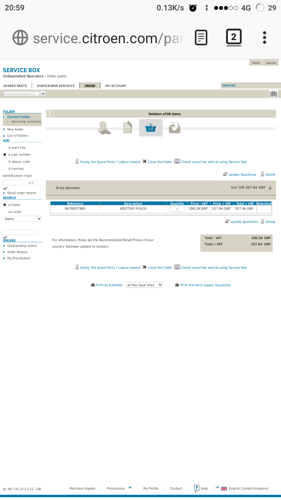

I absolutely agree but you also have to be careful topping up your tank... I would say it's even safer to top up the pouch as you connect the pipe to it. You don't pour anything into a hole. No risk of big spillage. From my point of view, worth a try if you put your gloves and glasses on. If I succeed, it would be a saving of about £200. A new pouch for c-crosser costs about £300 itself...

I agree with you. Tank is meant to be topped up, pouch is meant to be replaced. However to replace the pouch you need to take the pouch casing off the car, put it on your workbench, open it, disconnect empty pouch... So if I have empty pouch in my gloved hands, I check its condition with my eyes behind my safety glasses...
You know what I mean... If I can save £200 I'd rather put it aside in case I need to get a new FAP...
Believe me or not, I wouldn't bother if it wasn't so expensive to replace it...
