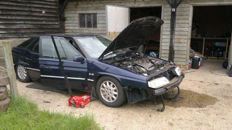

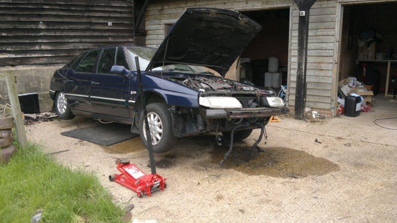

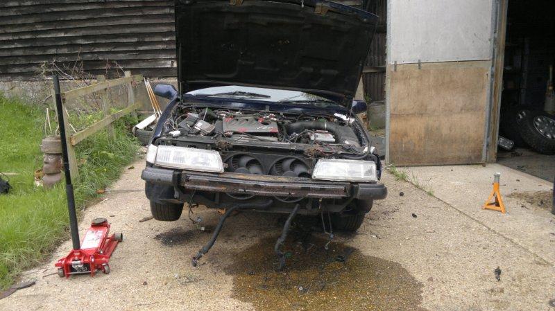

Page 8 and here she is...
getting out of bed for the first time in 8 months....
One Leg at a time...
then the next
Then being a typical Citroen, she sits on the Jack and refuses to lift
Please note the pool of fluid under the bonnet, well after 8 months of sleep you'd need a visit to the loo as well ;) (in truth it was a leaking union, now solved)
The incontinence is also the reason she wouldn't lift, so pipe replaced and we had an issue where i had 0 hydraulic pressure, was my fault i hadn't put a jubilee clip on the feed pipe from the tank so the pump sucked air instead.
Long story short though.......
She moves under her own steam (no steam though) the gearbox is silky smooth and the engine purrs happily and the suspension seems supple enough :)
For the more eagle eyed viewer you may have noticed that the arch liners are held on with cable ties, i'd decided to see how the car was (and to indulge myself) this will of course be addressed in due course.
