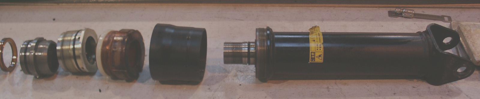

This weekend I finally had all the parts to rebuild the strut, and hopefully have it leak free. I've not taken any photos of stripping the strut down (as it's a big oiley job once you get started and I'm loathed to cover my phone in oil!) but I will take some photos of the strut I've stripped down today when I get chance over the coming weeks. But essentially what I discover on stripping the strut down is how brilliant my chain whip come mole grips come sphere tool, is. I managed to completely strip the entire strut using only my chain whip style sphere tool, a 32mm spanner, and a vice. Perfect. Upon stripping the strut the first time a good month or two ago I had discovered that the chap I bought "every seal to re-seal the strut" off, hadn't provided every seal! One was a very specific oil seal that is only available from Toyota within a large gold nut, the cost is £38 + VAT, so not the end of the world, and I have replaced the first strut with a new nut and seal. But after doing this I decided I'd have a go at removing the leaking seal from the nut, with some success, I have a make and part number. I can't seem to source any information on this particular seal however :x The seal is a NOK seal (NOK = the make), and the 'model' is a BR4647E. If anyone out there knows anything about seals or a supplier of said seal I would very much appreciate it - a few replacement seals would go down very well!! Assuming the cost is less than the nut + seal from Toyota that is!
Before I first stripped the strut I had a feeling that the bump stop was buggered, mainly because around a fast roundabout on the way to work the front offside wheel (the corner I have so far rebuilt) seemed to bottom out on the wheel arch! Upon stripping the strut I was removing all this disgusting stuff from under the gaitor, thinking it was mud I was just binning it, we then found this ring of nylon that was looking very very mullered! I looked on a photo which showed the bump stop attached to a piece of nylon, it turned out the crap I was throwing in the bin was the remains of the bump stop! :lol: See the photo below. From the right you have the nitrogen filled part of the shock (on the bottom on a Soarer), think of it as the Citroen sphere, then you have a big black collar which the gaitor mounts on (and collects all the bits of the bump stop when it starts to fall apart!), the next bit is the bump stop, I only had the nylon ring left, all of the rest of it was mush!! The next part is the big gold nut, which houses the seal I mentioned, the next part is the bushing (all very replaceable as you can see!). Not sure what the next part is but it is made of a VERY cool material, a very red and very hard plastic type material. Very unusual.

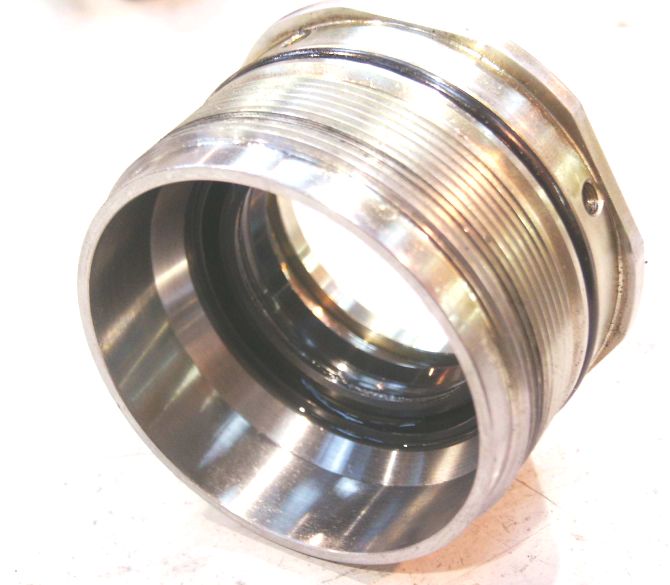

And here is the gold nut, it's hard to see the seal but it is in there, with a spring around it as are most beefy oil seals:
Incidently the new nut from Toyota was silver and not gold, I'm hoping the seal isn't a new revised design. But that would explain why I can't find any replacement seals for the part number I have...
I'd decided that because the oil inside the first strut was such a bad colour that I would strip down the other three struts too. As the front was already in the air I decided to start with the other front strut. On stripping this down I'd discovered that the bump stop on this strut was also ruined, so it looks like I'll have to replace all four bump stops and not just the one I had decided on originally.
