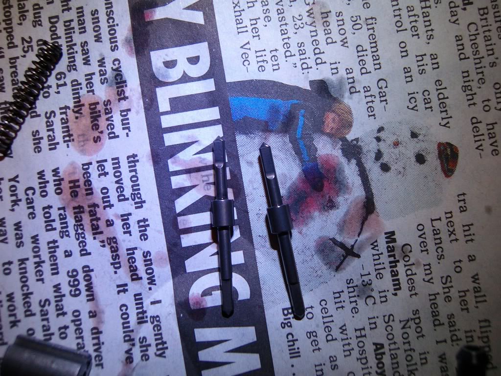

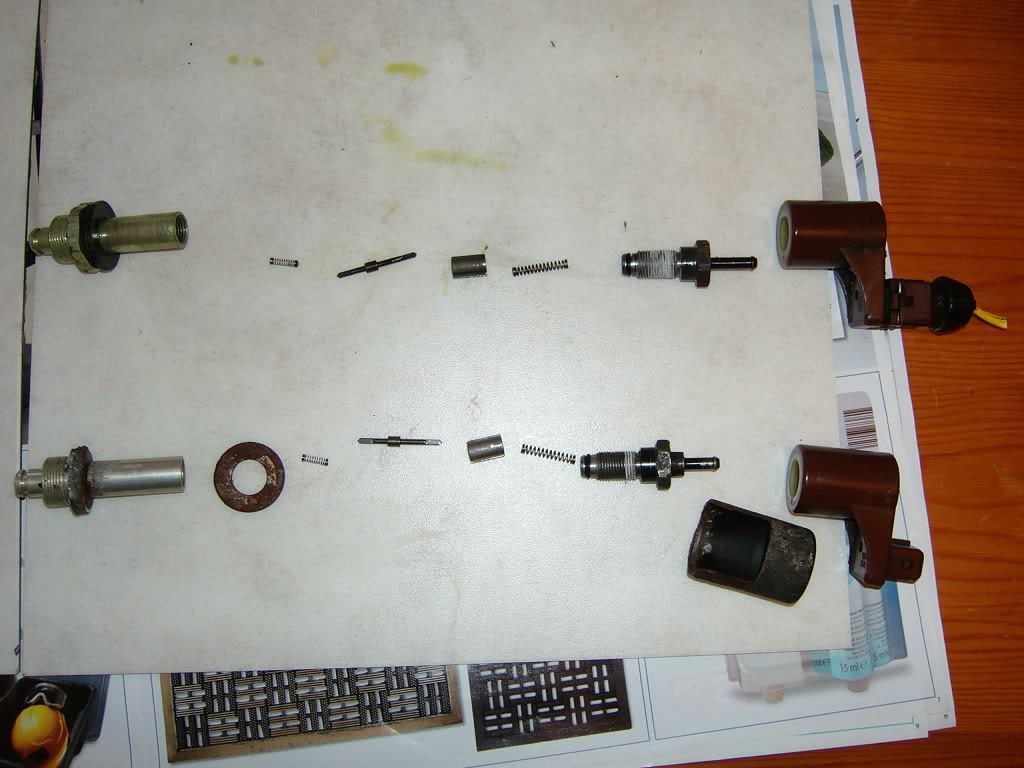

We had the electrovalves apart today, from what we can tell the only differences are the flat section closest to the sphere body on the bit the slug slides over, and there is 0.7mm difference in the coil length and presumably in the alloy part too, I forgot to measure this but I can do if needs be.
0.7mm doesn't sound like much but it's enough to make a gap where the crinkle washer is so the crinkle washer isn't flat, if that makes sense. It means there is movement between the coil/cover and the internals. I don't know if this is normal but I'm assuming not. The crinkle washer that came off the activa electrovalve with the 0.7mm larger coil was totally flat, no 'crinkle' left in it.
Top is a hydractive electrovalve, bottom is an activa electrovalve

The main problem is the difference in length between the flats on the pin in the valve. There's 1mm difference between them, the activa one is 6.9mm and the hydractive one is 5.9mm (measured from the start of the flat to the pin tip.
The effect this could cause is allowing more LHM to leak passed the pin and out through the leak off pipe, ie, not just when switching between hard and soft. Possibly it's supposed to leak passed all the time when it's on hard mode. We checked the alloy part and have determined that they are the same.
The only way to prove or disprove our theory is to pop off the leak off pipes on both the hydractive and activa electrovalves and compare the flow rate. Any takers on that job?
