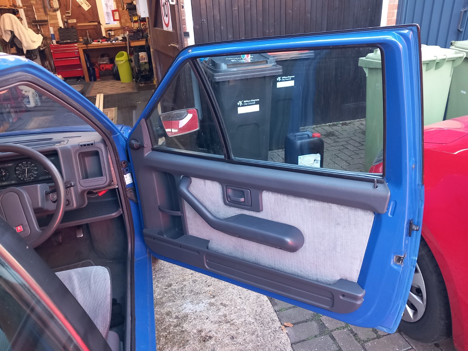

I refitted Bluebell's driver's door card after checking the central locking actuator was properly linked to the mechanism and working...
Mick did a fantastic job of sticking the fabric back on to the card and it looks an order of magnitude better than it did
Thanks Mick!
I then realigned the door on the striker as it was always a bit out. A final job on the door was to lubricate the window channels with a bit of silicone spray...

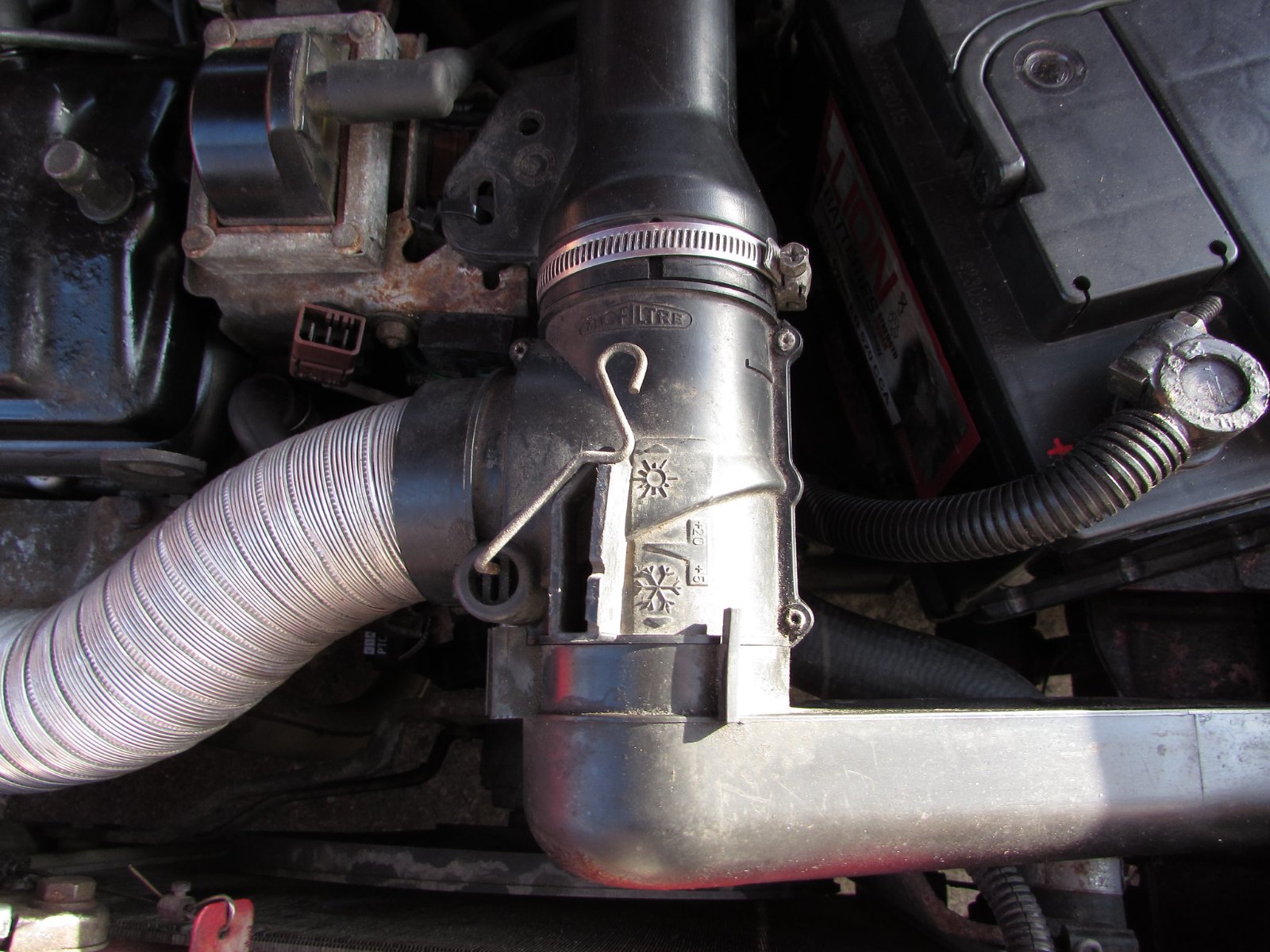

Home again and I put Strawberry back to summer mode, given the nice warm weather

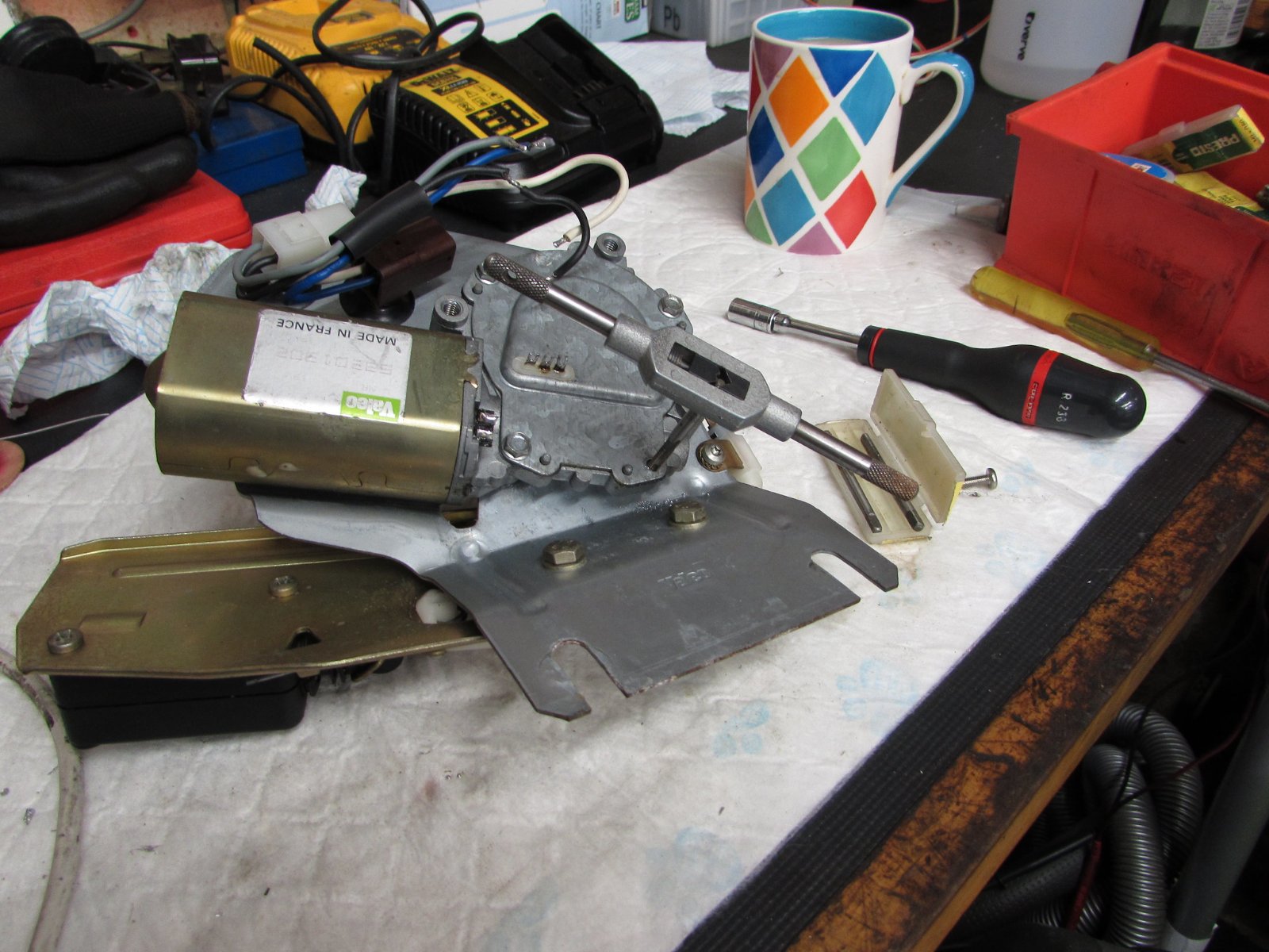

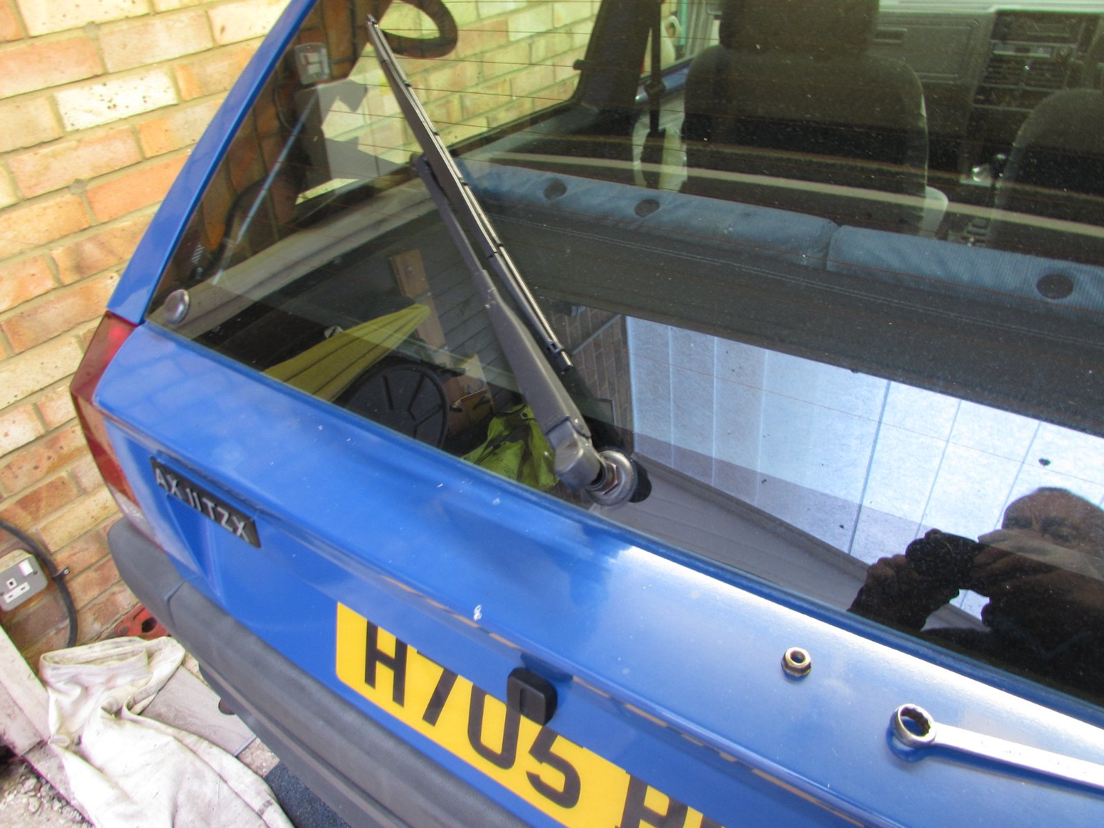

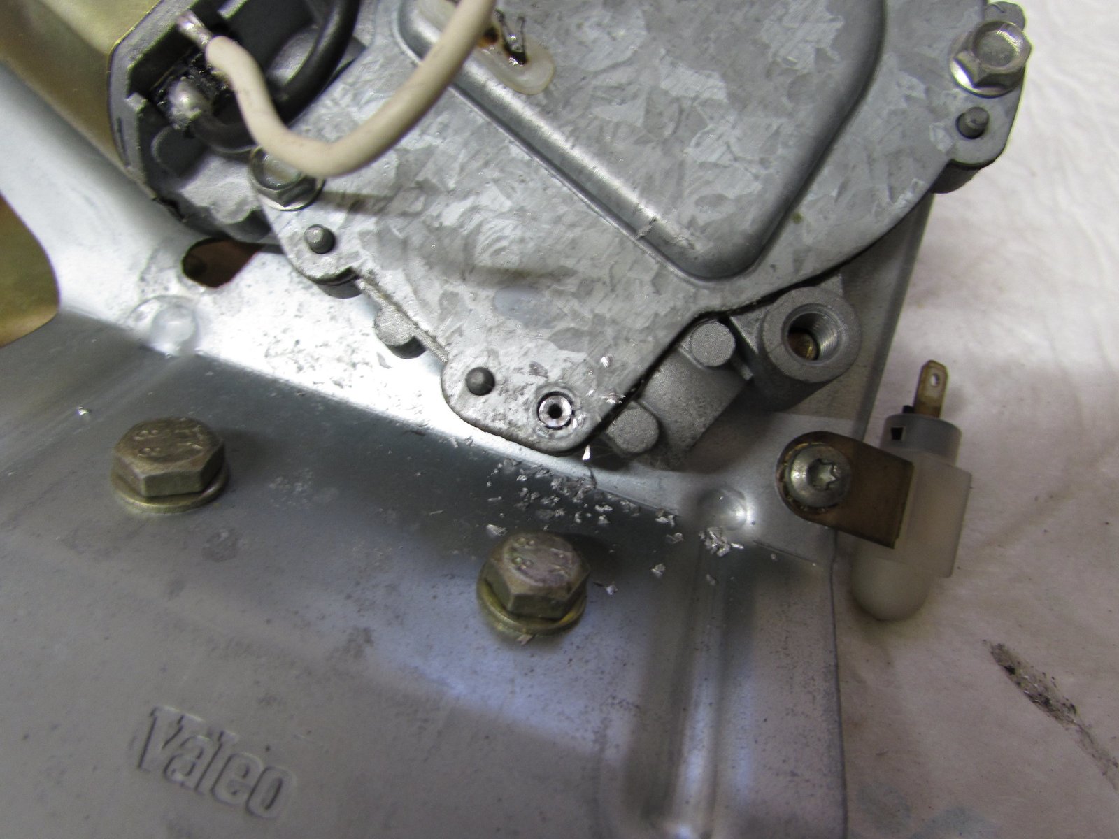

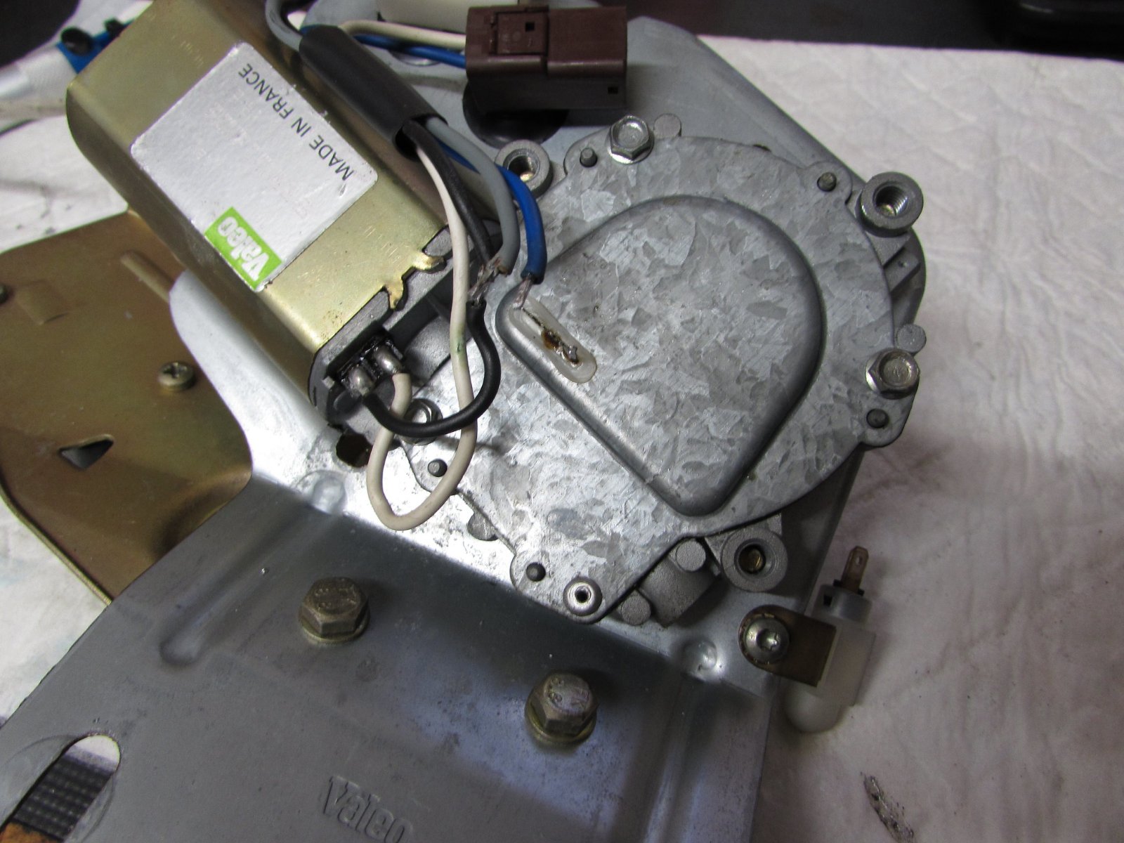

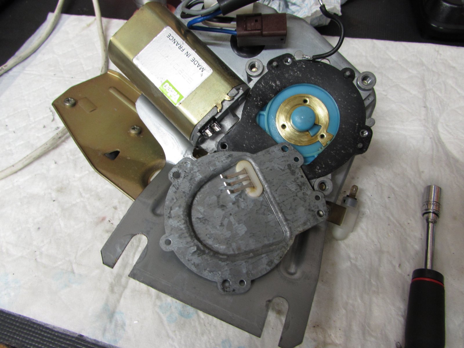

Today I looked at Bluebell's rear wiper that suffers from random parking...
Off with the wiper..
Expose the motor and linkage and remove...
The central locking actuator is also attached to the motor bracket...
The gearbox cover is secured with three screws and one rivet... To stop tampering I guess...
Rivet drilled out...

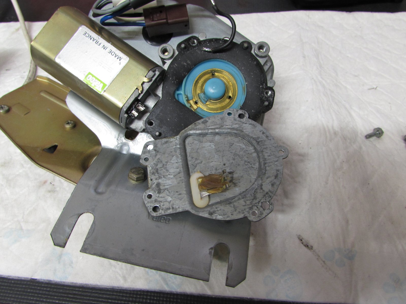

Park slip rings and contact wipers exposed...
A bit mucky and full of congealed grease...
Cleaned up...
Rivet hole tapped to take an M4 screw..
Bench tested by running the motor from a 12v battery and using a meter on the ohms 'bleep' range checking all works as it should and all wipers making correct contact with the slip rings... All seems good
A screw to take the place of the rivet...
All wires soldered back onto the terminals and the unit is all ready for reinstallation and testing for real...
I had to be careful with the tailgate as if it fully shuts it's very difficult to reopen again with the central locking linkages disconnected... I'd have to climb in, fold the back seats and crawl into the boot to release it!!!

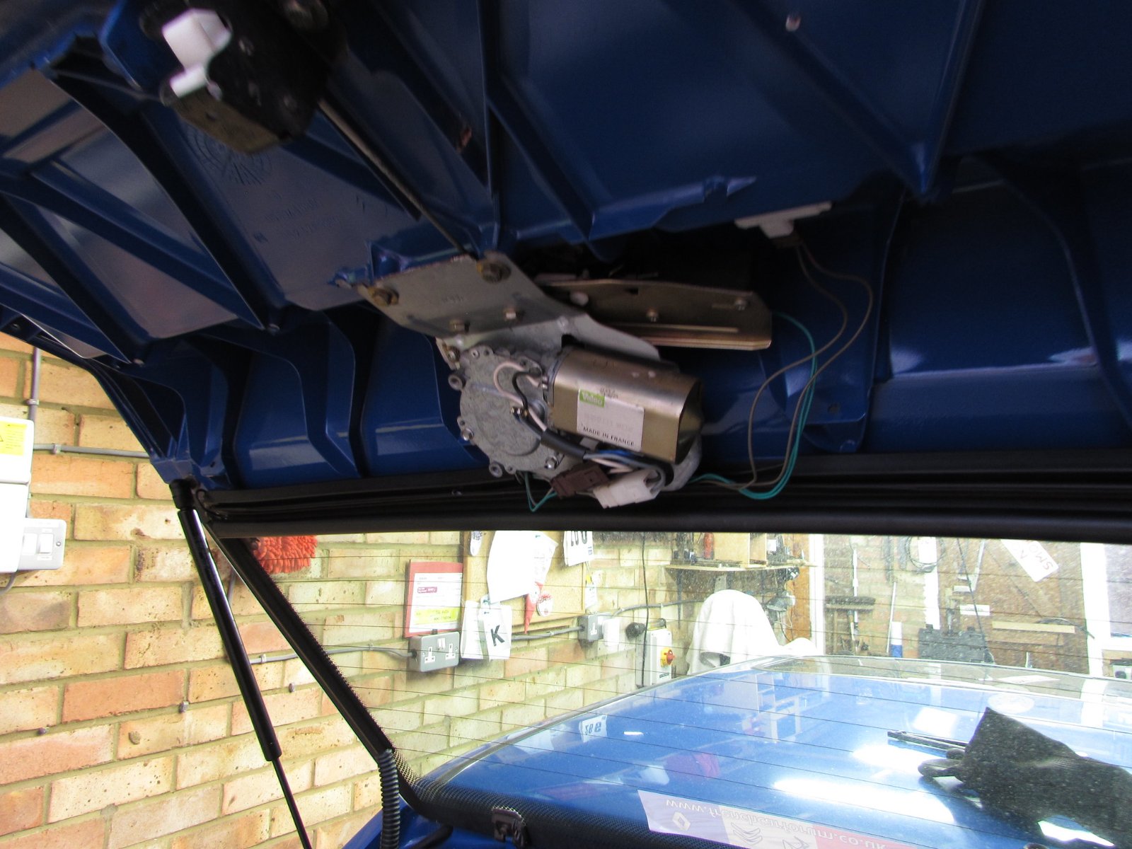

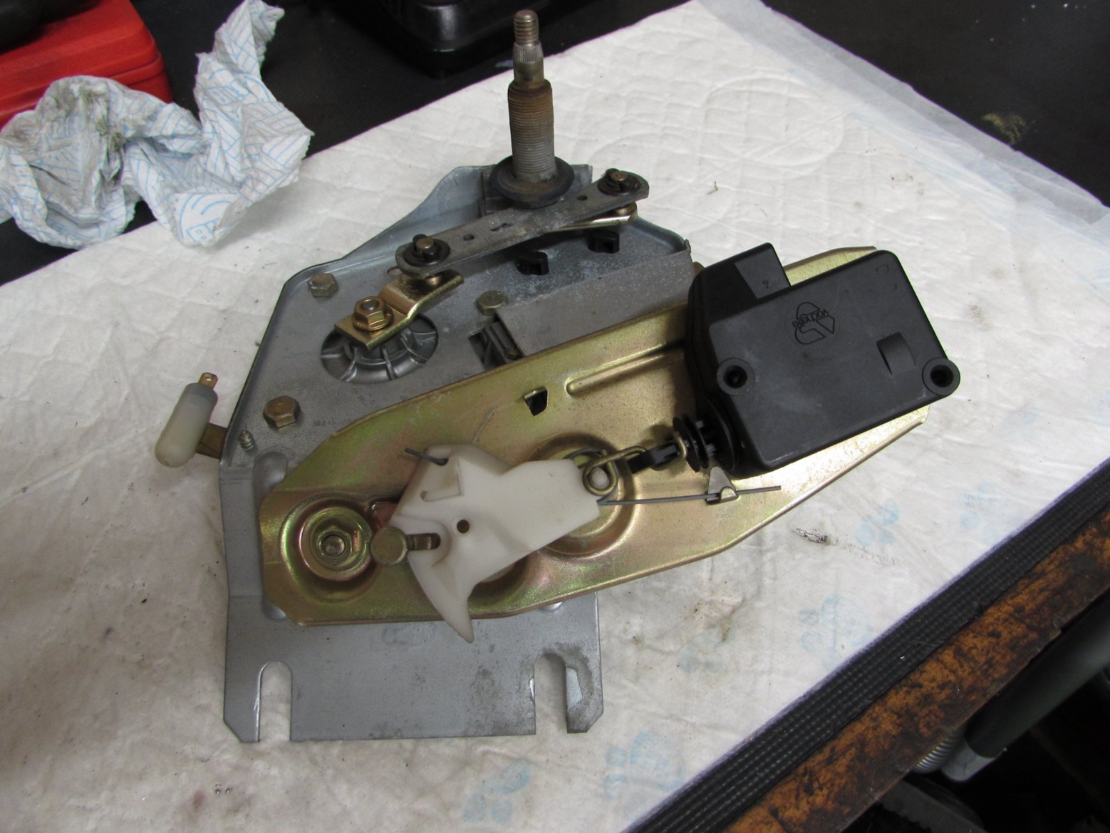

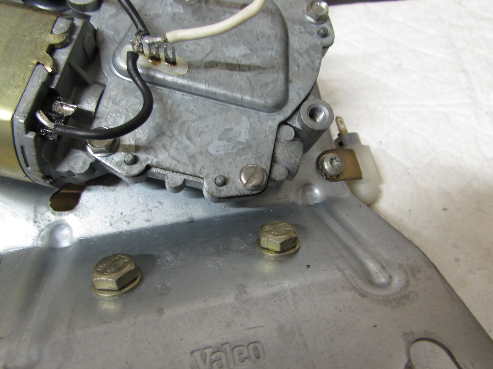

Cleaned up...

Just for completeness; the central locking actuator and linkages...
