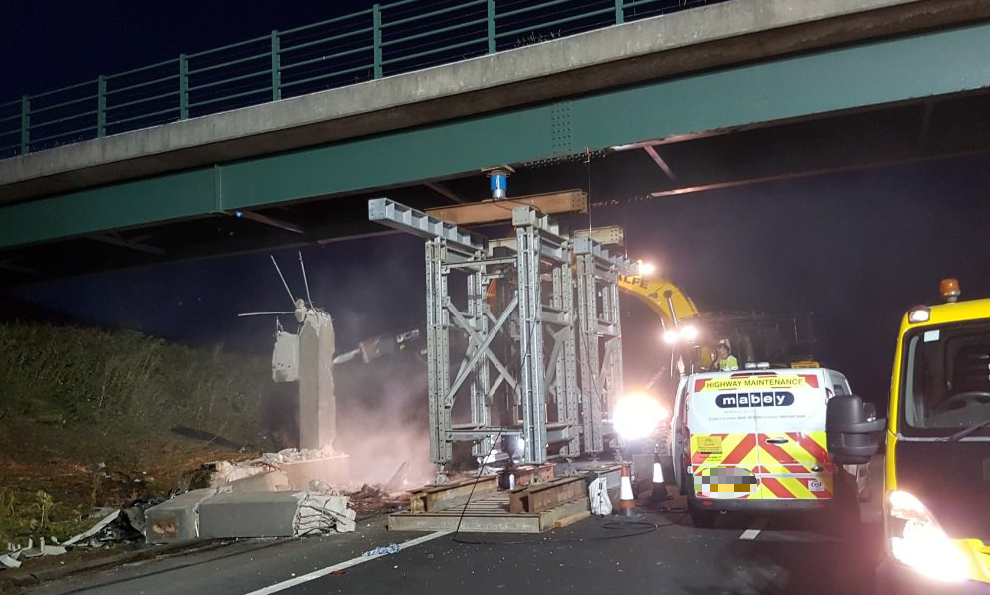

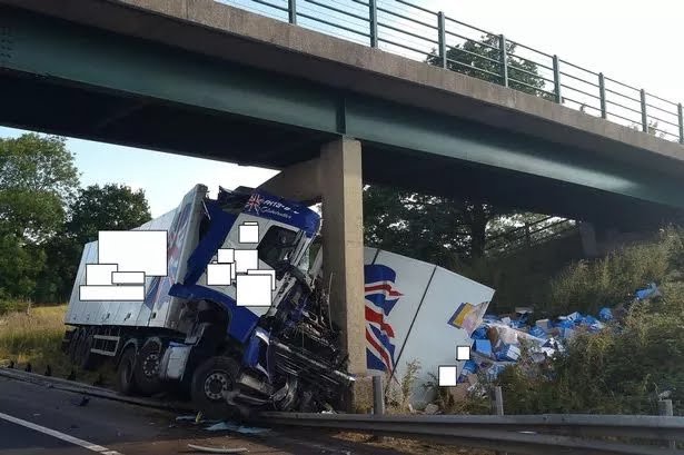

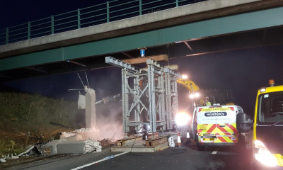

Something about "the bridge (rectifier) not needing further support" amuses me.
I used to drive past this fairly regularly
Temporary support
Temporary support
https://www.mabeyhire.co.uk/engineered- ... dge-strike
And it was not a very "Temporary" fix (at least a year I think from memory)

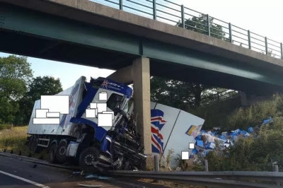

This lorry crash instigated the need for it:
Wallop
Wallop
From
https://www.google.com/imgres?imgurl=ht ... bme%2Ctrie
Surprisingly the driver was ok!

Oh gosh :shock: Pleased the driver was OK!

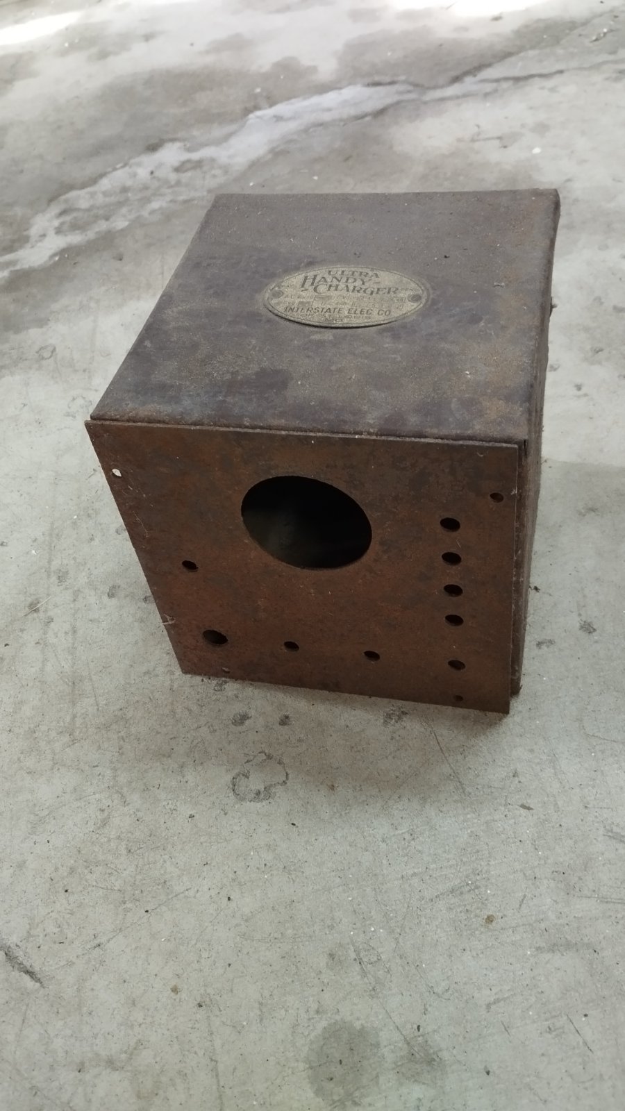

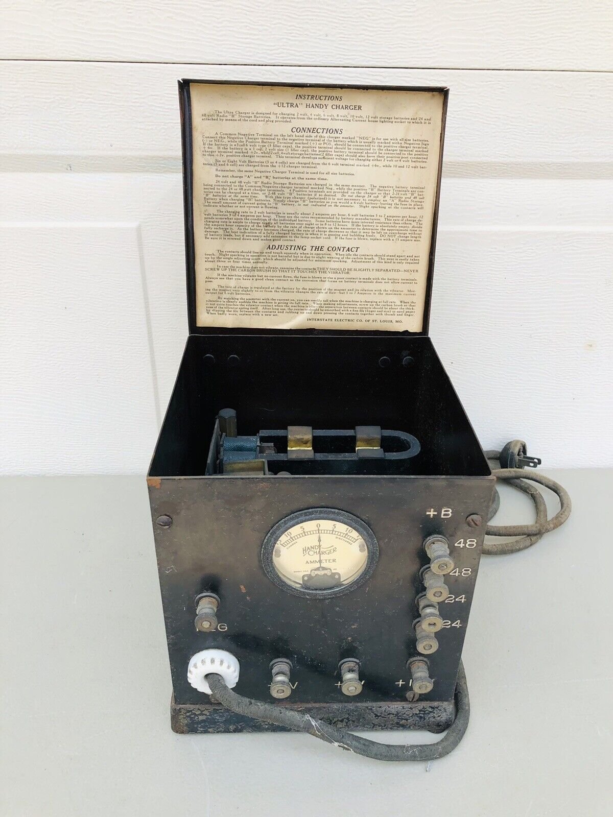

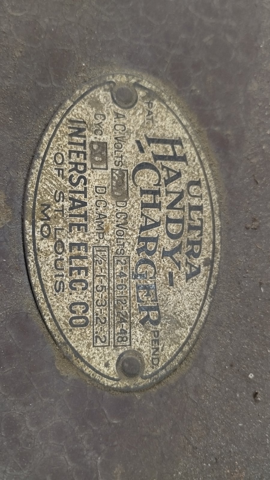

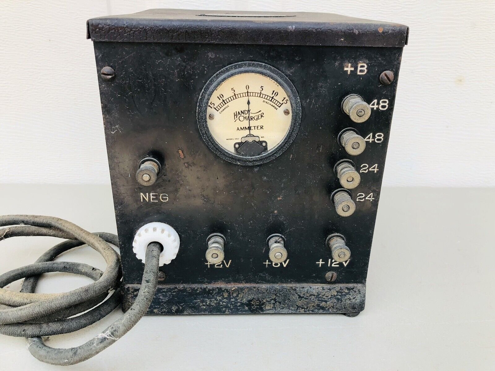

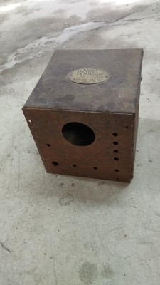

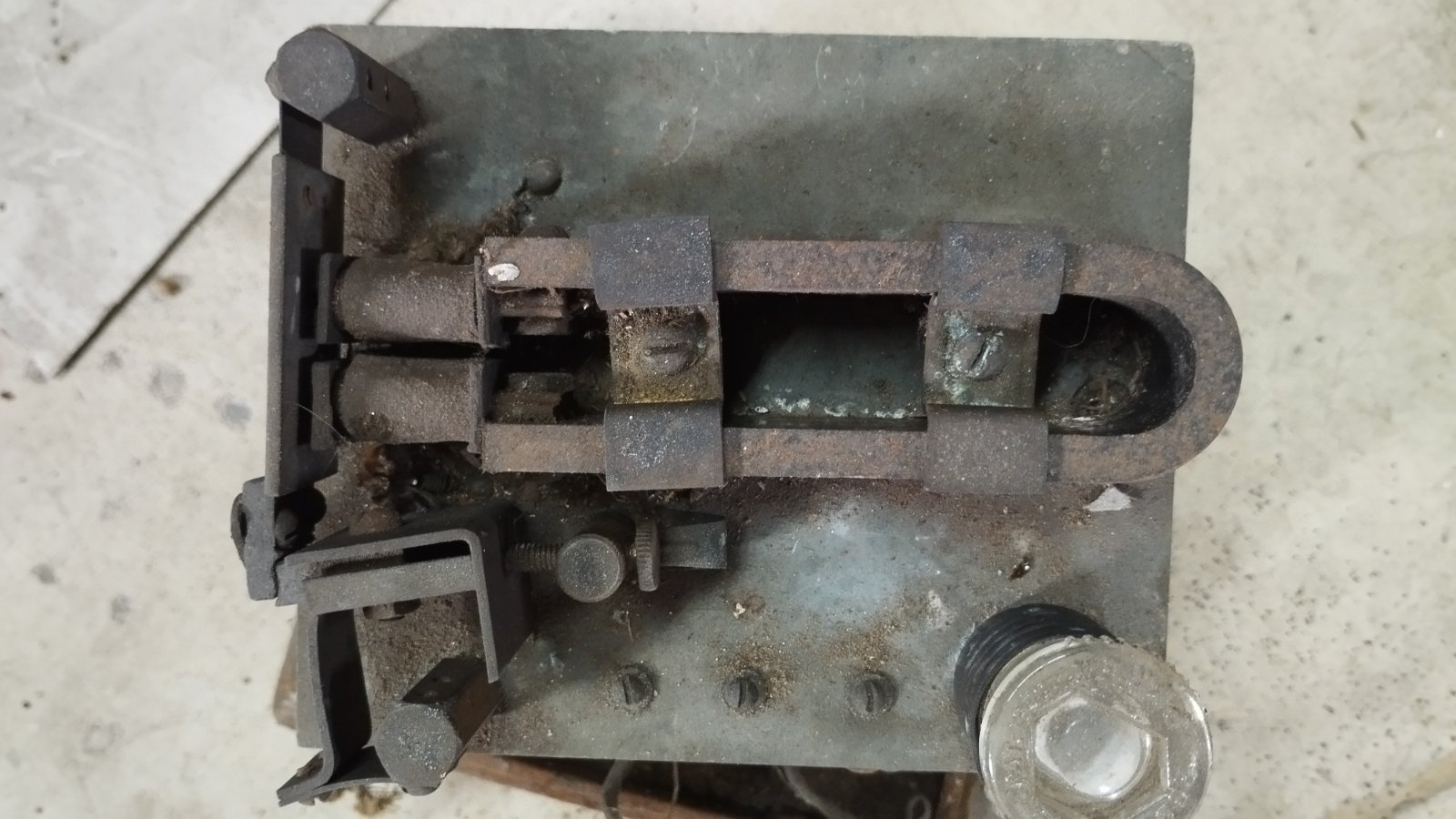

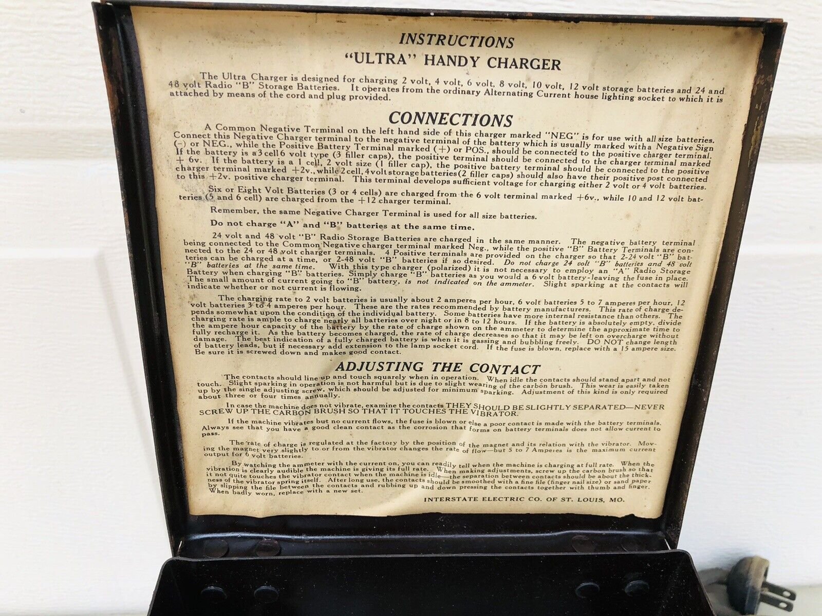

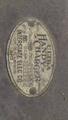

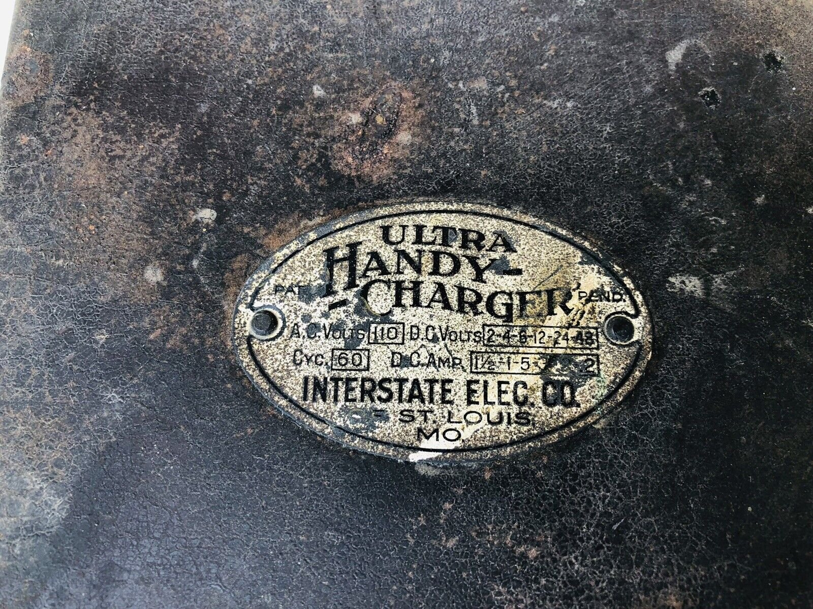

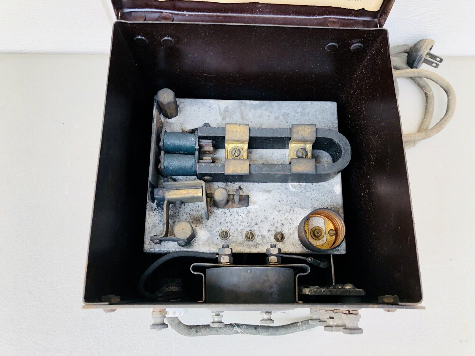

I am back in NZ and I dug out the old charger, which turns out to be in a worse state than I remembered. I last saw it 25 years ago, and my dad partly dismantled it 40 or 50 years ago....
Having see the name plate, I did a web search and there is an almost identical unit on ebay.com which is much more photogenic:
Now here is my sorry example:
I am now hoping that I find another box containing the ammeter and screws. I am not confident. The transformer on mine also needs rewinding....
It is interesting that mine was made in the USA for 230V 50Hz operation.

Wow Mike, that's magical and a great restoration project :) I'm sure yours will respond favourably and the ammeter should not be hard to replace, it looks a standard size...
Now that is interesting that it's US made for 230v 50Hz mains...

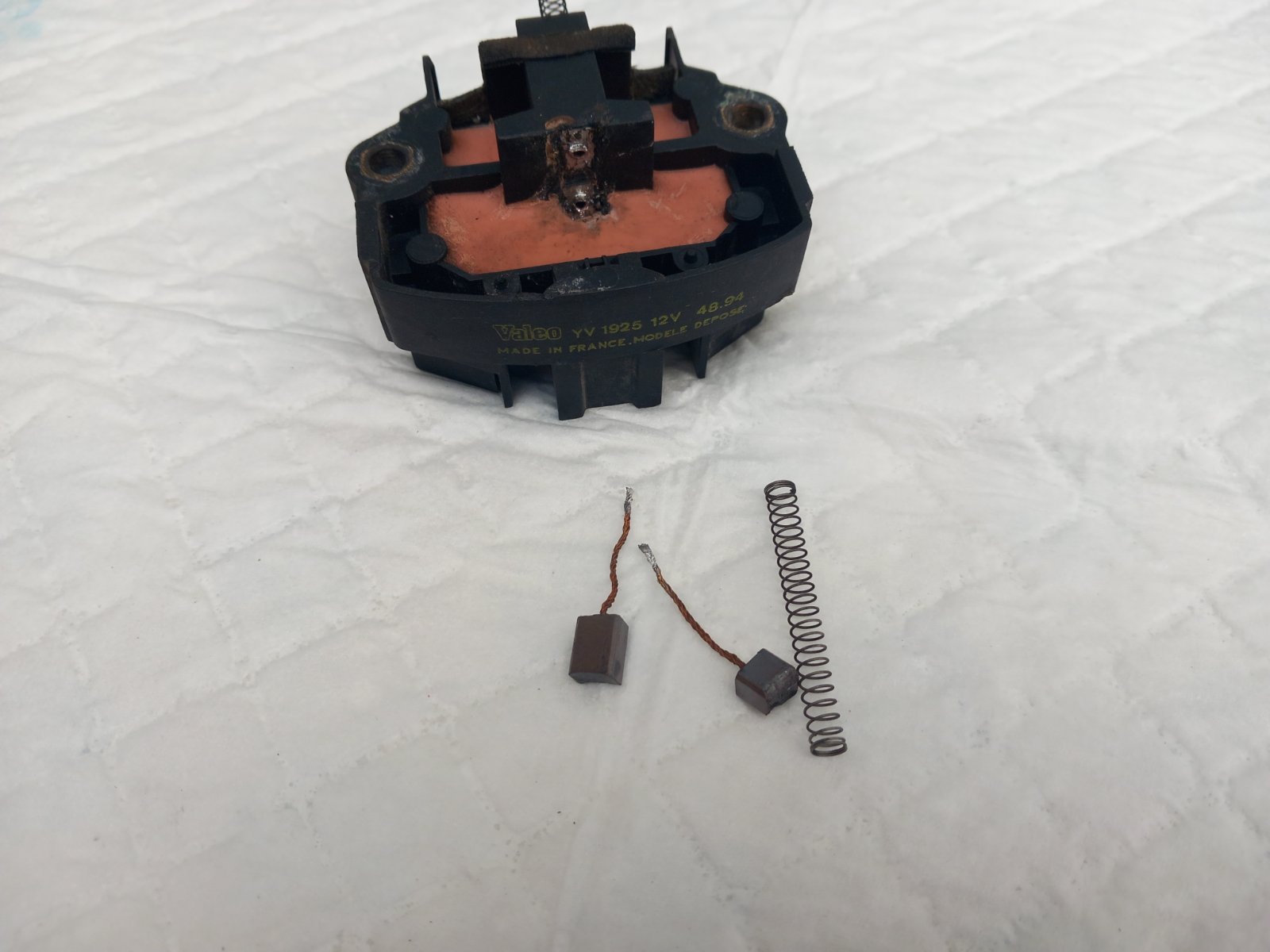

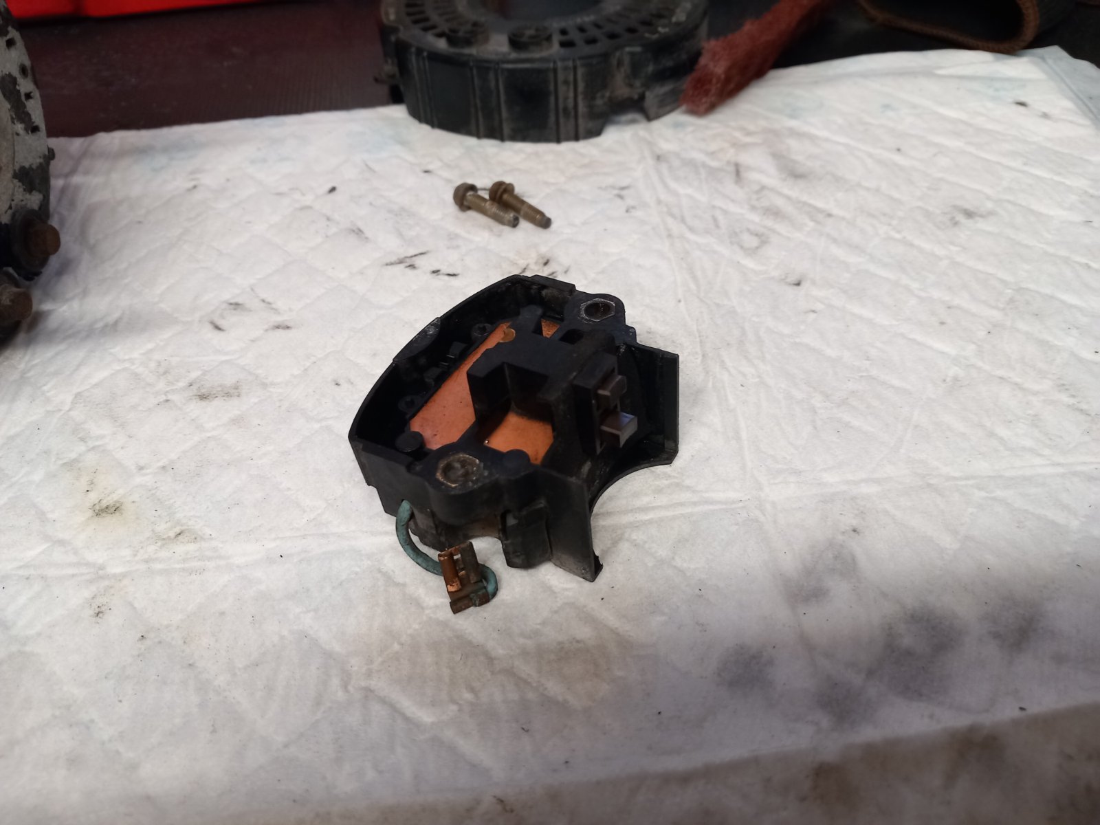

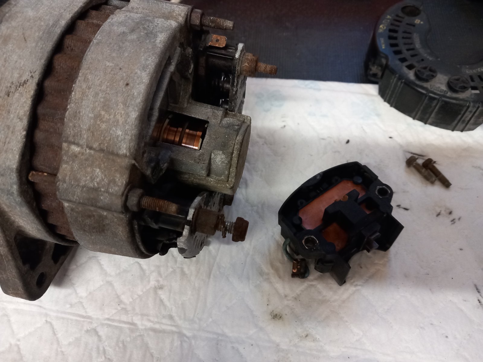

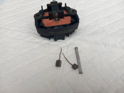

On a related topic, today I got a few minutes spare to have a look at the AX family spare alternator...
It's definitely badly worn brushes...
It's intriguing how one has worn much more than the other despite running on parallel slip rings...
Speaking of slip rings:
They will just about do another turn I think despite being worn.
Date codes suggest it's 30 years old so it's not done too badly...

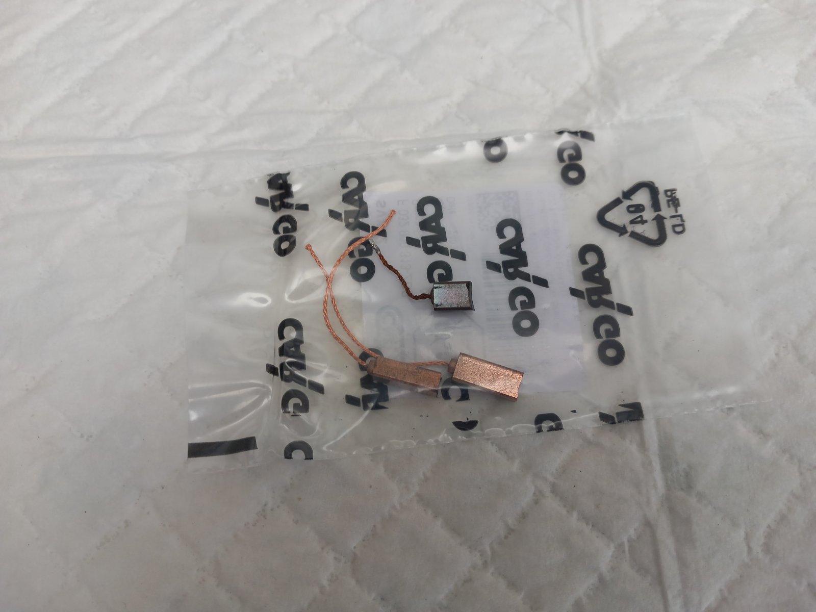

New brushes are freely and cheaply available and I have two sets on order from the bay of E.
Those will allow me to test the alternator as it stands and get it back into working order and a viable spare...
The brush tails are soldered and the BoL only advises to attempt to DIY replace them if you are suitably skilled... I think I'll just about pass muster for that ;)
The slip ring assembly is available as a spare part via Autodoc, as is the rectifier and regulator.
Next time I submit a big spares order, that'll be soon, I'll get some in stock.

The weirdest thing is that the current eBay auction is the only hit on the internet for that make of charger, so I was very lucky to get the photos.
I have only hazy recollections of the charger before dad dismantled it but I think that the meter was present. A 15 0 15 meter was always a rare thing.
The transformer is only a bit burnt, I may get away with just rewinding the primary which is on the outside.

I removed the old brushes from the alternator regulator body... Not only are they soldered in but also crimped in tubes at the top of the pads on which they sit. That made the old ones a bit hard to remove. To get at one of them, it was necessary to cut back a little of the pink potting compound.
That done, it can be seen just how well worn the old brushes are:
Then, around midday, the new brushes arrived... See the difference in length!

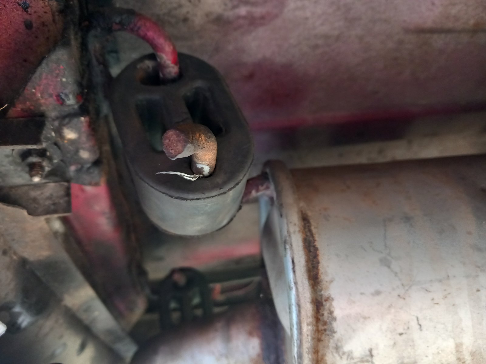

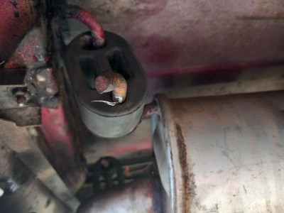

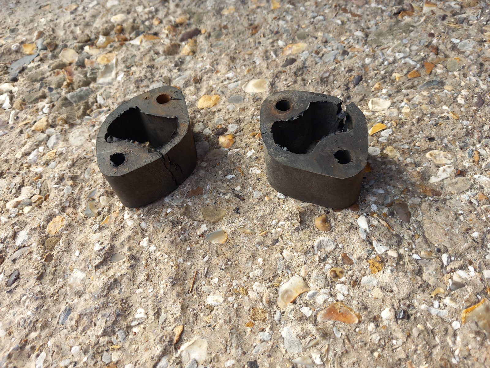

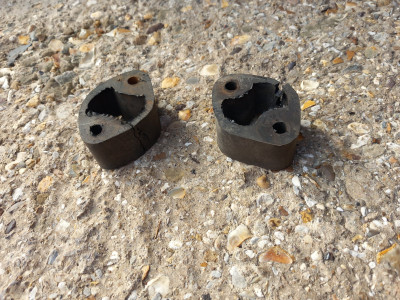

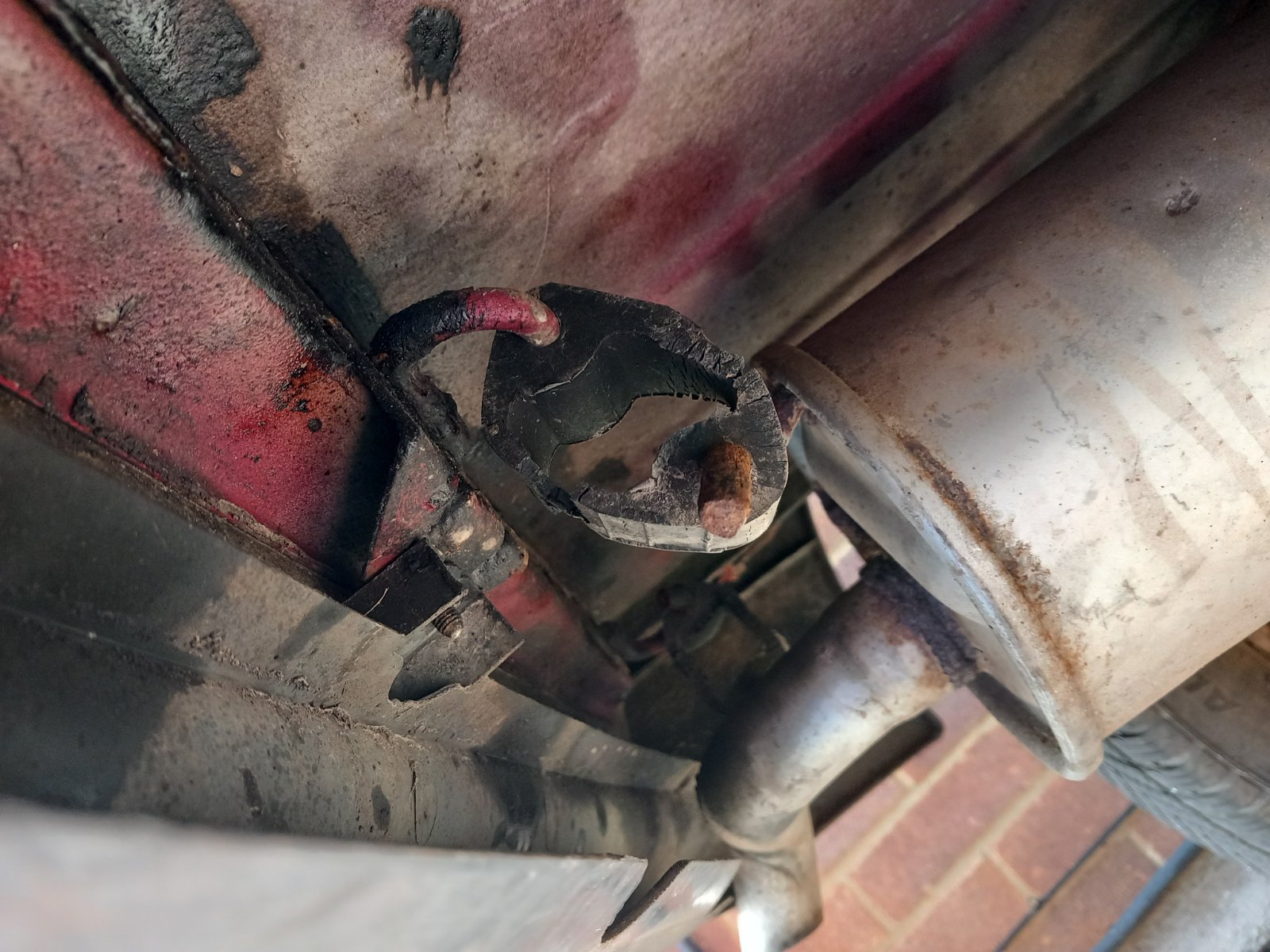

A while back, I noticed back box rubber hangers on Strawberry were very badly perished and about to let go...
I fitted new ones...
Despite looking a bit grotty under there. it's all an illusion: She's absolutely rock solid and what makes it look rough under there is the rustproofing goo...
These were the knackered old hangers:

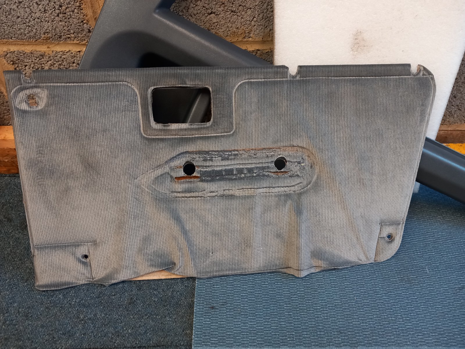

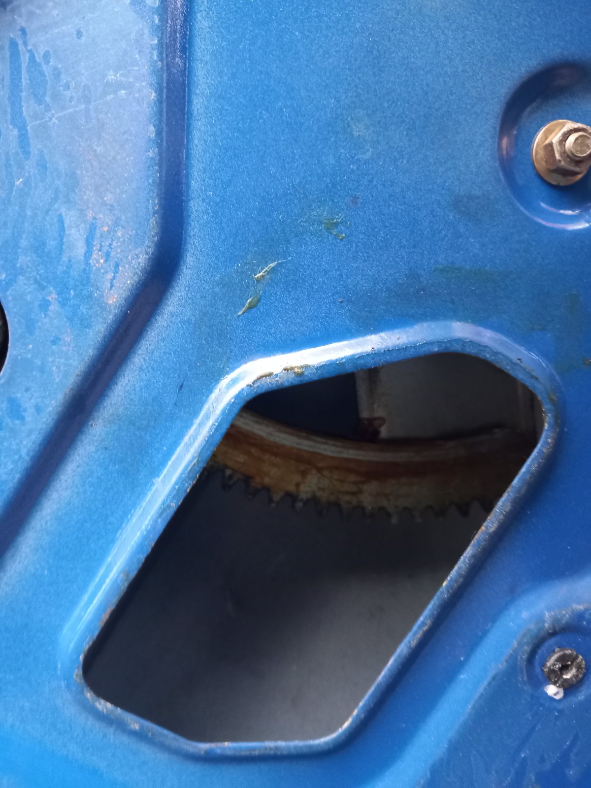

Then I had her driver's side door card off to check on her electric window components...
There's not much to it really. I found the grease on the drive rack a bit gooey so cleaned it up and put some fresh grease on it...
Whilst I've got the door card off, I'll get some spray glue tomorrow so I can glue back the detached/loose fabric covering and make it look tidy again.

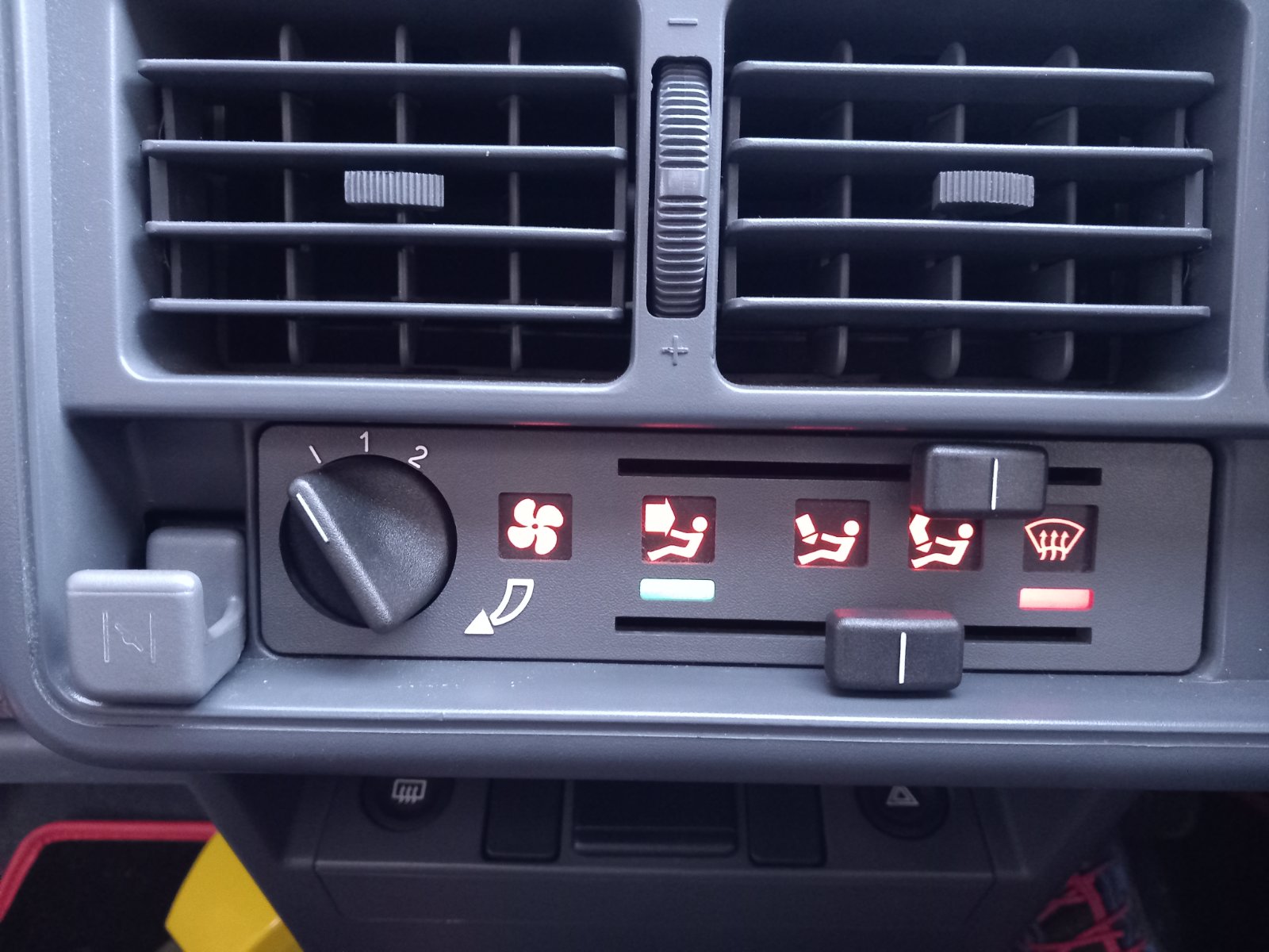

My last job before going to the railway station to collect the family was to replace the blown bulb in Strawberry's heater panel... After seeing Alasdair had done the same on his sinker heater panel, I was inspired to do the same!
