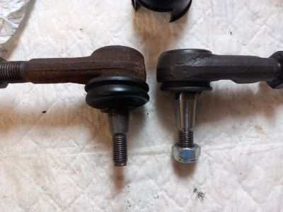

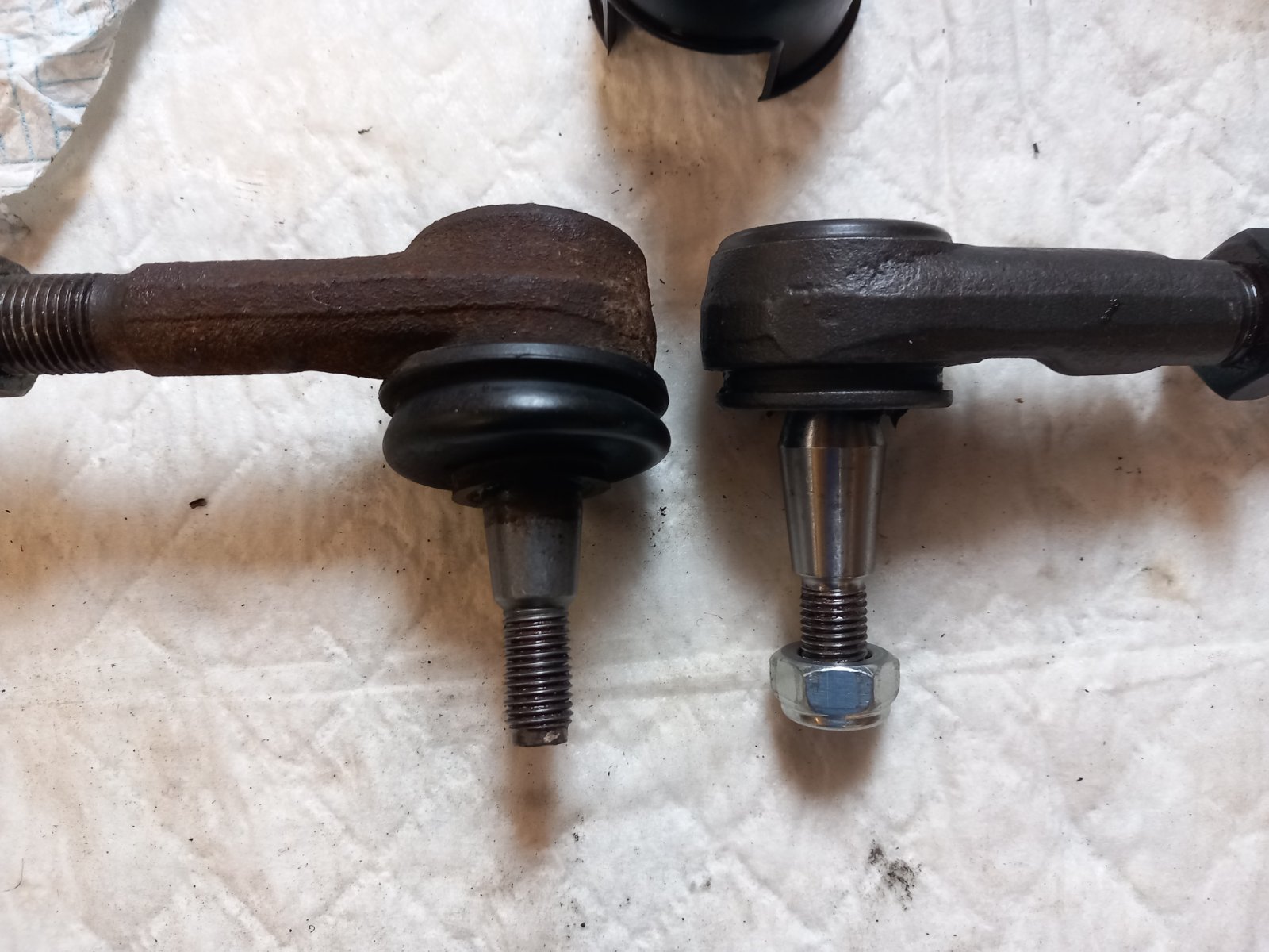

Earlier, I spoke of the incorrect taper profile on a new pattern part track rod end and how it did not 'sit' right on the strut steering arm and was the very devil to remove...
Here's a photo of the genuine article (on the left) and the pattern part... It's easy to see the difference. I confirmed it my taking measurements with a vernier caliper.
The pattern part is bootless as this was used to reboot the original track rod end...

Are they differing angles of taper Jim? (Look similar on the photo to my tired eyes!)
Just if same angle, they should be interchangeable - so long as the nut does not bottom out on its thread ahead of the taper seating of course!
Just thinking aloud really, if they are different angles it's pretty incredible they got it soooooo wrong!?

Yes, slightly differing angles of taper Matt and the taper is also too long... The genuine article has a taper that then goes parallel at the top whereas this pattern one doesn't so the nett effect is that it does not properly fit the mating taper in the strut steering arm. As they say, it only fits where it touches...MattBLancs wrote: 05 Nov 2024, 18:35 Are they differing angles of taper Jim? (Look similar on the photo to my tired eyes!)
I'd say most people wouldn't even notice and it does do the job but for me, things on steering, braking and suspension has to be right.

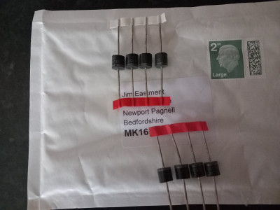

Also some (hopefully) more suitable rectifier diodes for Alasdair's battery charger. I'll build them into a bridge and test it shortly...

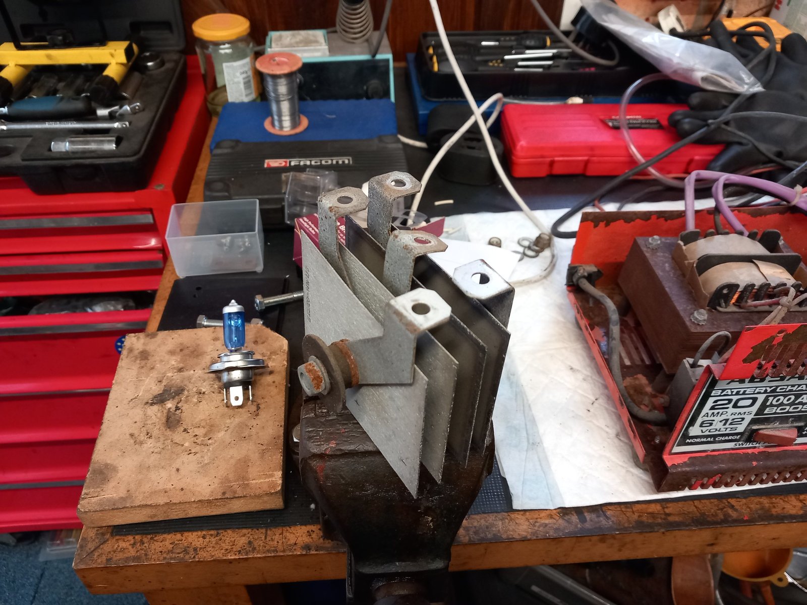

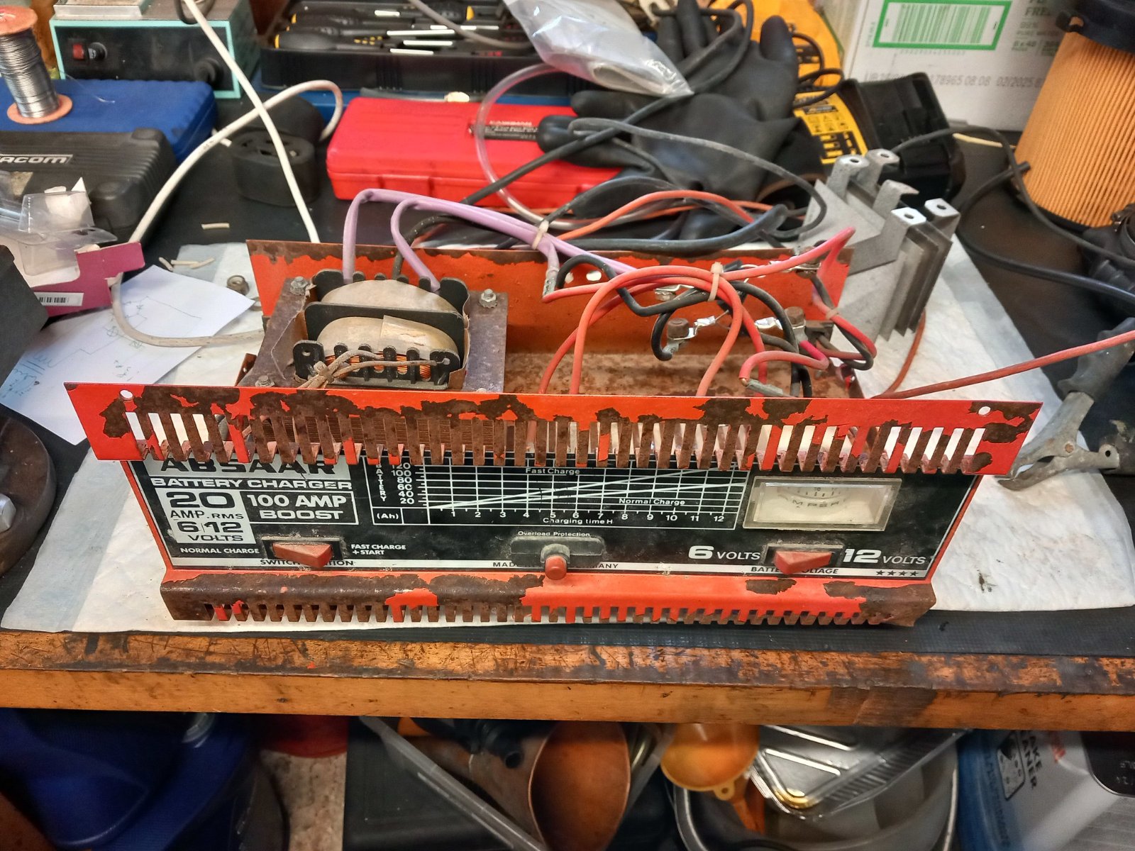

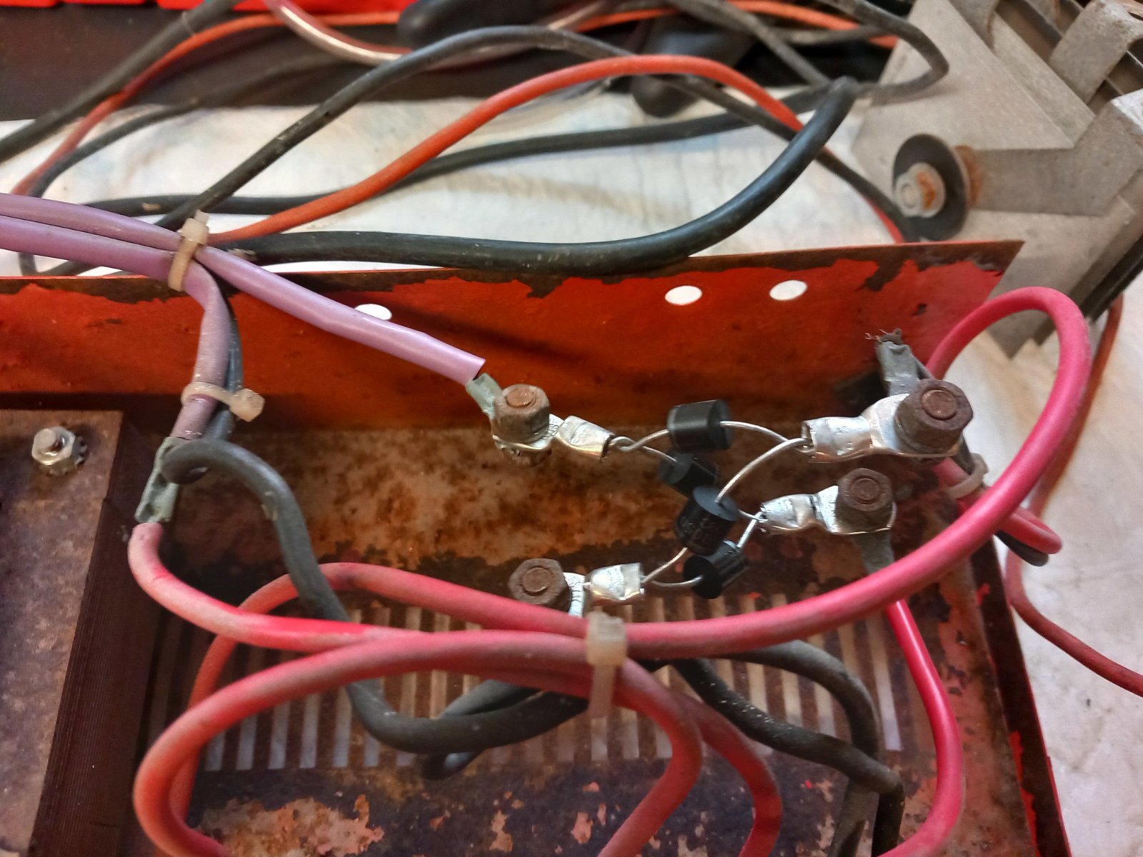

Got a good bit done today and started off with those misaddressed diodes and built a new bridge rectifier for the old battery charger Alasdair rescued from the last resting place of his Sinker...
Here it is fitted...
I used all the old rectifier terminals and the rigidity of the wiring makes any further bridge support unnecessary...

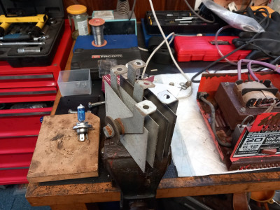

On test, the charger now works a treat. I tested it initially into a parallel H4 headlamp bulb and then gave my workshop jump-start battery a maintenance charge.
It's very scruffy, looks like a wreck, it still has peeling paint but that all belies a very functional device
This is the old rectifier:
