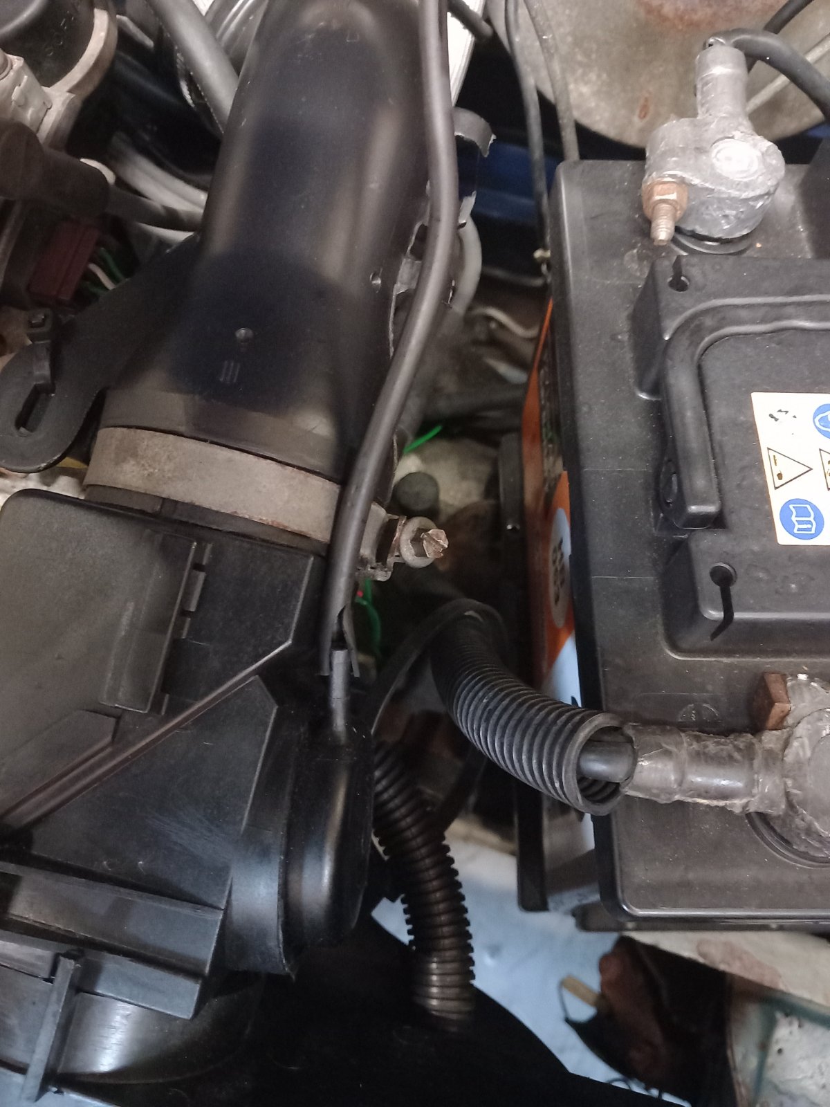

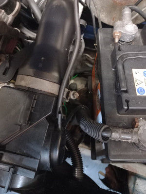

First up, removing the air intake and air box I found this horribly perished vacuum pipe feeding the summer/winter flap on the air intake.
That pipe is only about 18 months old - eBay rubbish :evil:

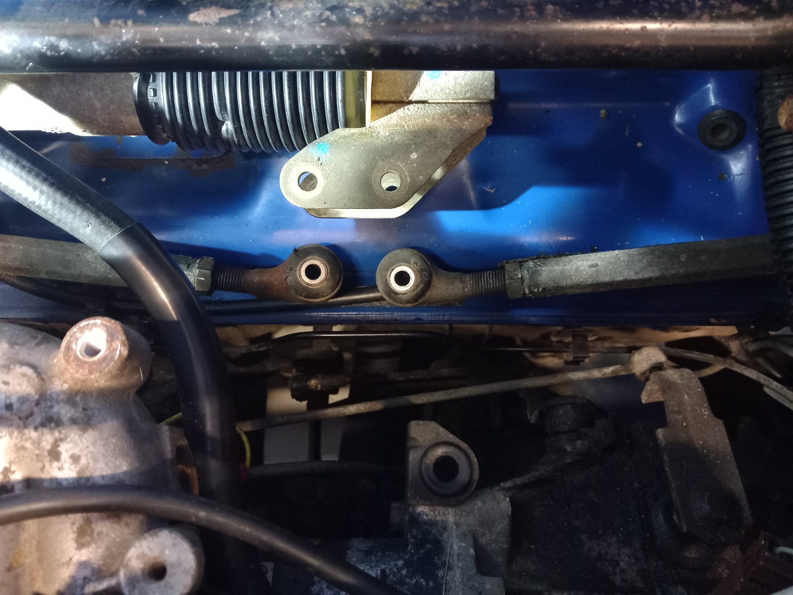

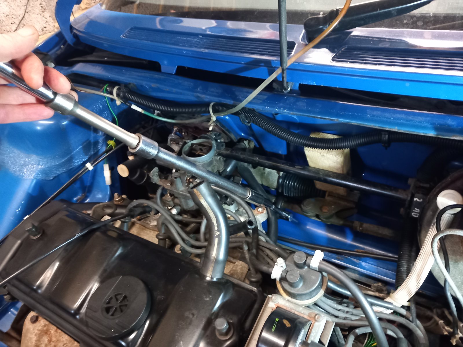

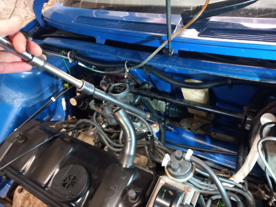

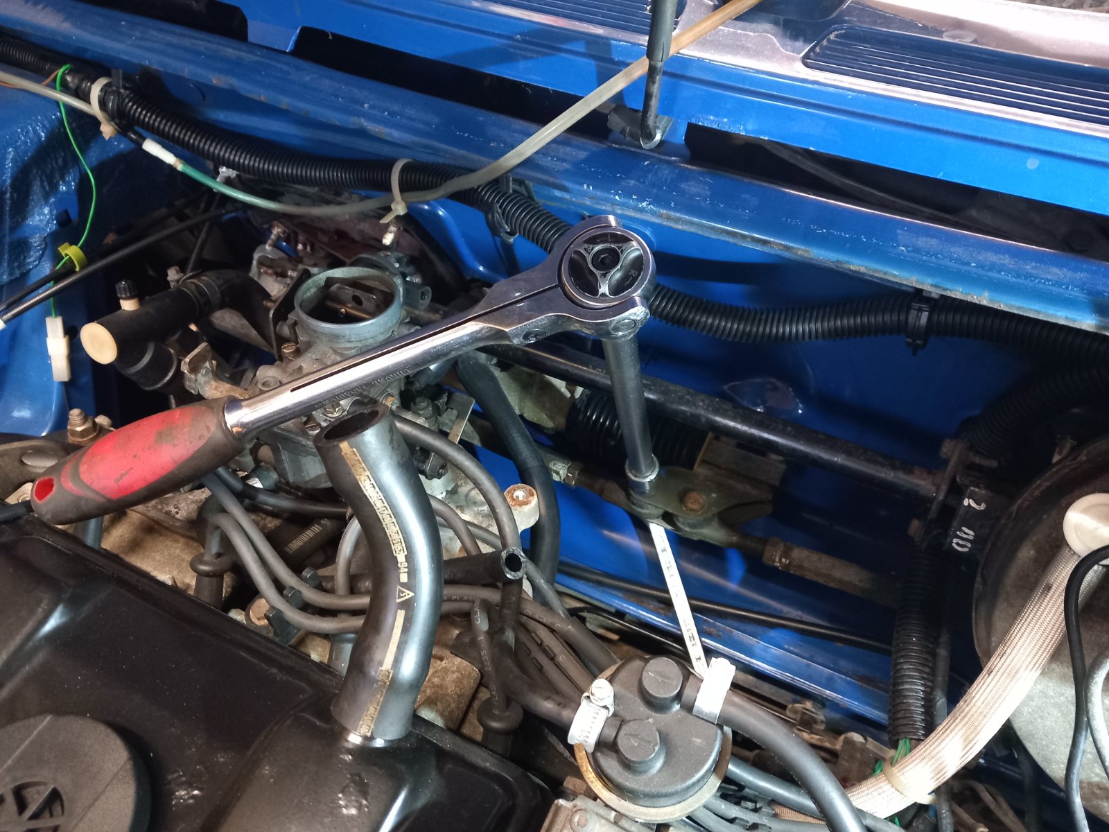

Then, with access gained, I set about loosening the inner track rod end locknuts... They were outrageously tight and I needed to make up a bit of a 'special' breaker bar to use with the crowfoot socket...
The inner track rod ends have, quite logically, left-hand threads. It's obvious from the threads if you know what you are looking at but worryingly, not mentioned in the BoL... I'm sure this has caught out a few people before now...

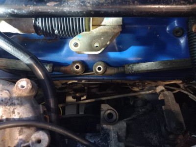

Then, with those loose, I undid the track rod end through-bolts from the rack yoke...
And out they came :)

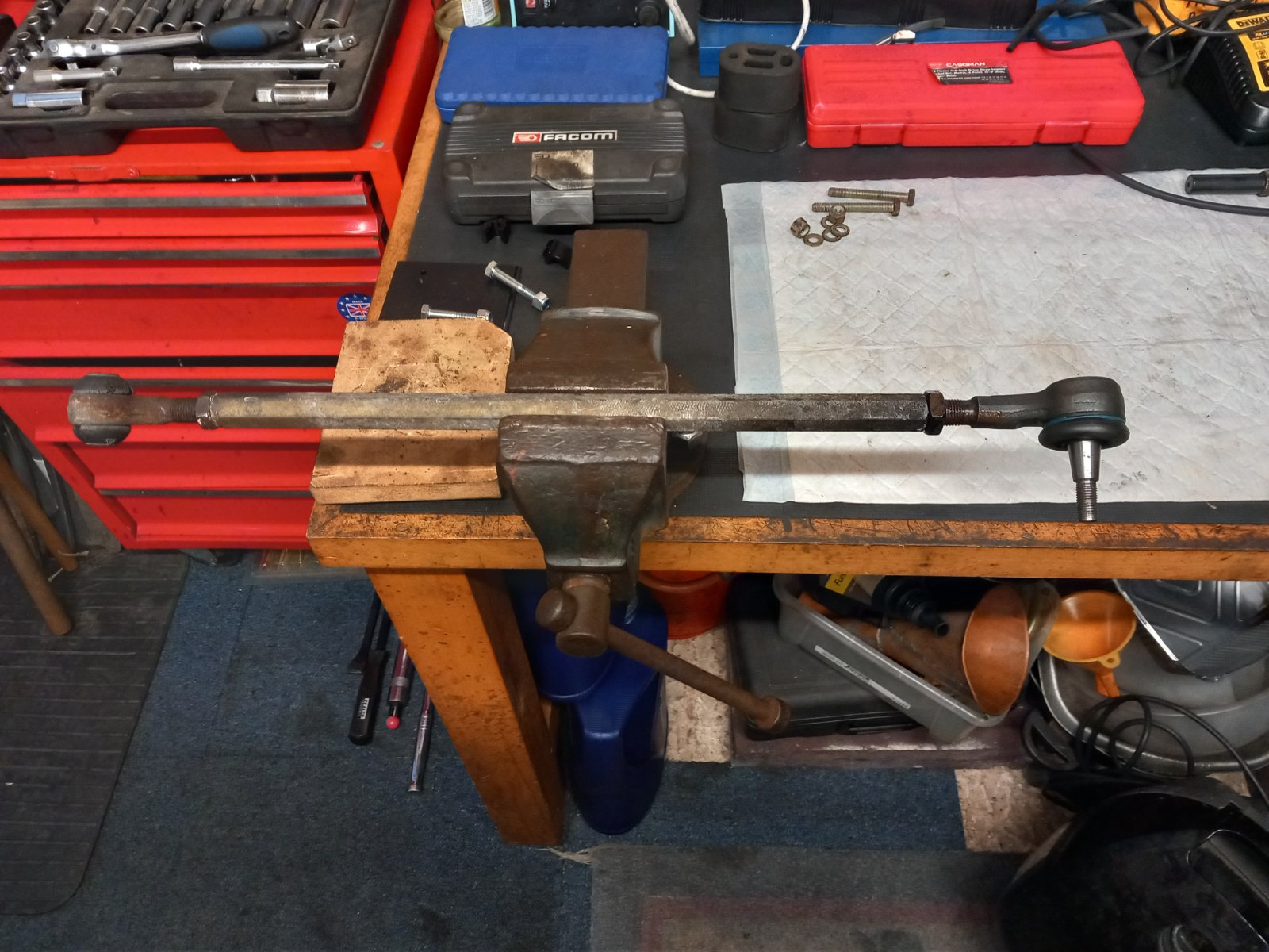

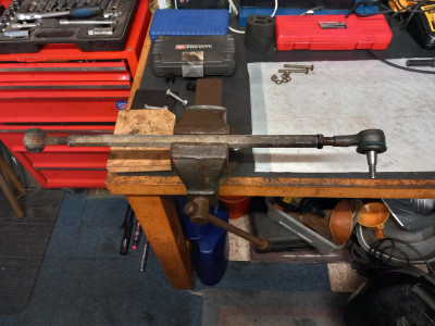

The inner track rod ends would not rotate freely in their track rods so I fully removed the whole RH track rod to work on it on the bench. It soon freed up :)
In doing this, I found the after-market new track rod end I fitted for the MoT had an incorrect taper profile :shock: It was hellishly hard to separate it from the strut steering arm.
As the old joint was fine and just needed a new boot, I swapped the boot ;) All now good with the old joint back in service...
That an after-market item could be incorrectly profiled is worrying. This was not an Autodoc one. I shall now check my Autodoc spares...

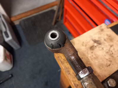

This is the inner track rod end up close:
The rubber looks perished to the casual eye but is not. It just superficial and there's absolutely no play or what I'd consider excessive 'give' in the joint at all. It can do a further turn in what is after all, a very lightly used car.

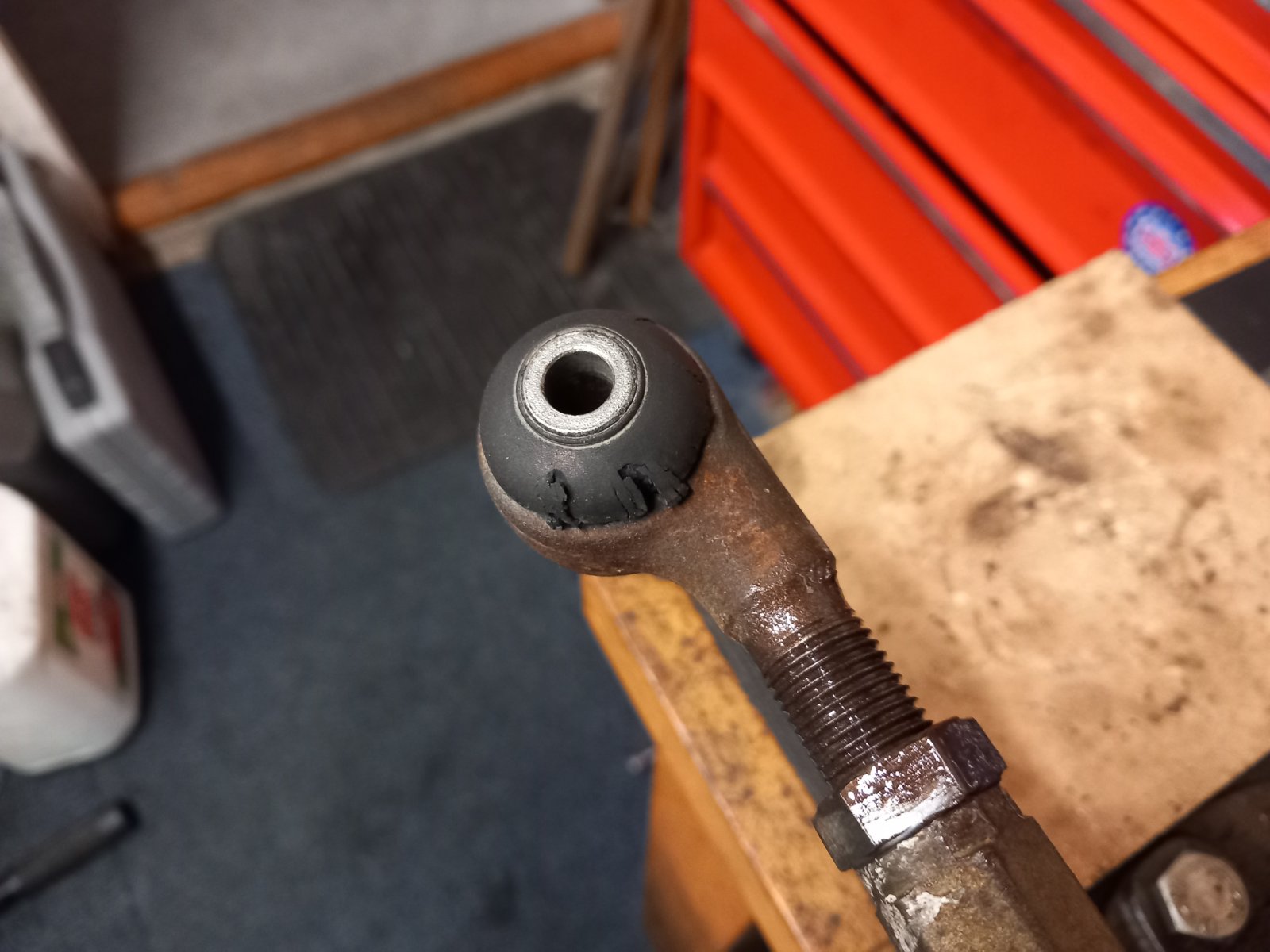

Strawberry's I know do so she, being the more heavily used AX, will get new inner joints.
I now have to pop the LH track rod out to free off the inner track rod end thread and give the inner track rod end rubber parts close inspection.

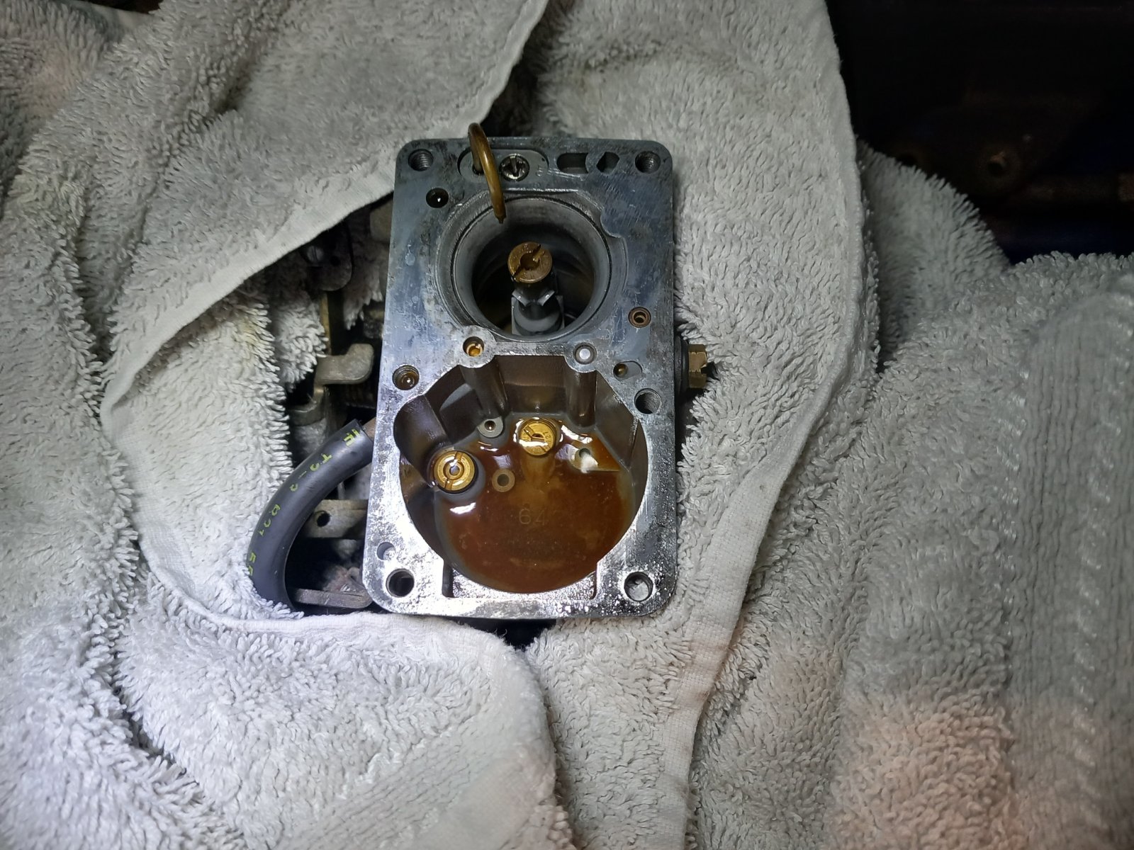

When I first had her, there was a fair bit of debris in her fuel tank and it took several changes of fuel filter before the fuel ran clear.
I rebuilt the carb in the early days of my ownership as it was in a terrible state...
The last couple of time I have driven her, I've noticed a bit of a stumble if given a good dose of throttle, suggesting the accellerator pump was not quite the full shilling...
I removed the top of the carb. and this was what was sitting in the bottom of the float chamber :shock:
It's amazing what got past the fuel filters in two years!
I found a bit of muck in the accelerator pump intake valve - a ball bearing in a tube - and after cleaning it, all seems good although the proof of the pudding will be in a road test which, with the steering all in bits, was not really advisable!
I note the carb. is quite worn on the butterfly spindle and will be on the lookout for another one... If push comes to shove, I'm sure I can rebush the shaft...
