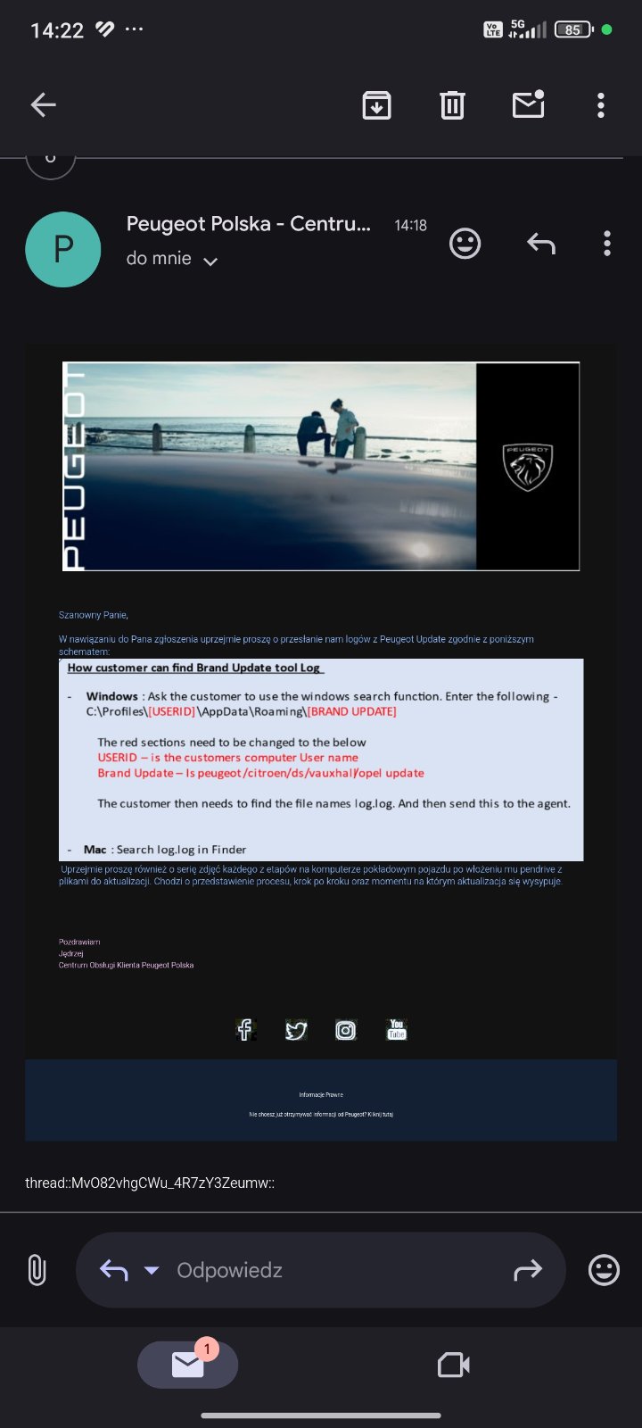

I am currently at work but I got a response from Peugeot. I am attaching a photo

Hello. I have attached the information you gave me, namely since when the certificate has not been working. They wanted logs and photos from me of what happens in the car after connecting the pendrive. I am waiting for a response from Peugeot Polska.

I got a reply that the case was forwarded to the technical department. When I get a reply I will let you know what happens next.

Don't think that will help with anything, as that should just confirm that you are using the correct update tool version and that the firmware is the correct one - it's the embedded certificate provided with the firmware that's the issue, not the firmware update tool!
Anyway, let them do their stuff and when they realise you are doing everything by the book, they'll realise it's the firmware certificate hopefully....
