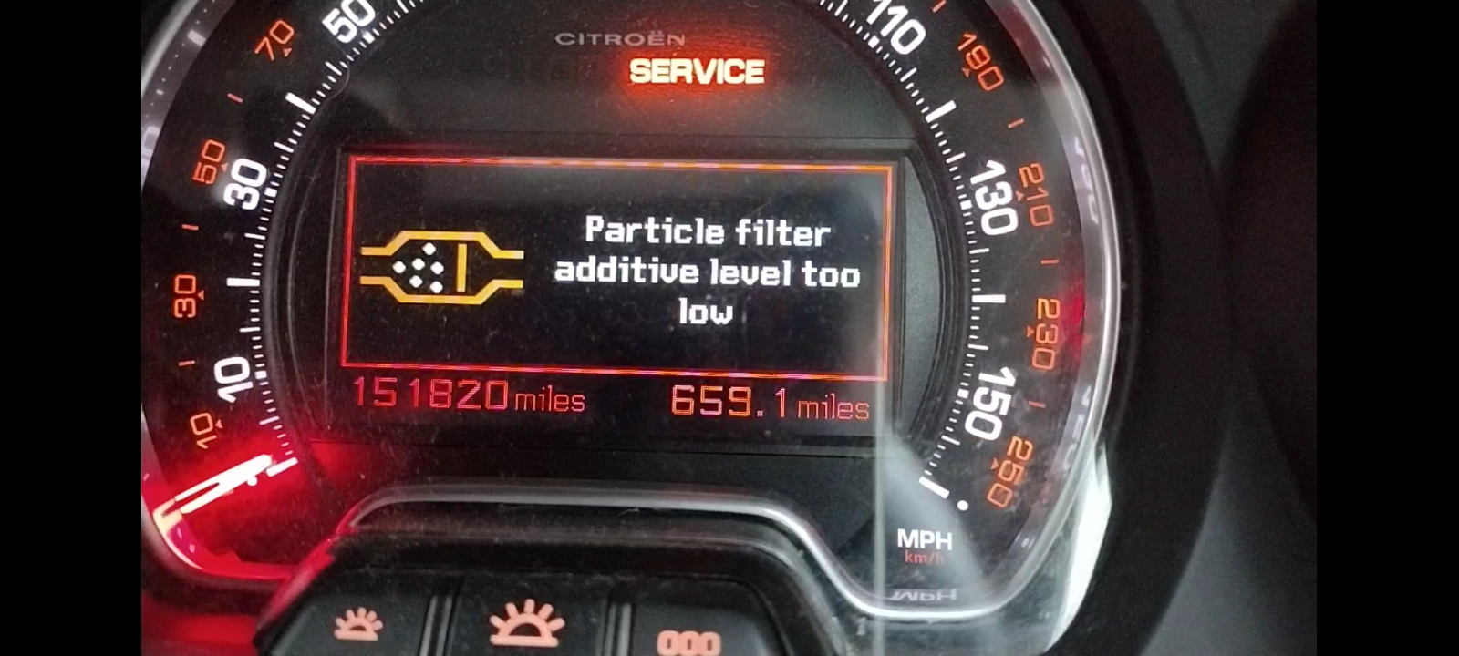

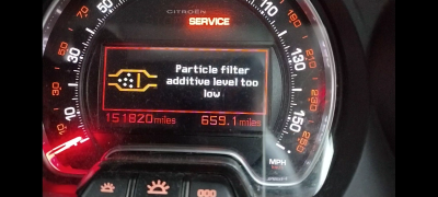

308 SW's condition (which seems fine now) seems to be contagious, here's the C5's dash this morning:
Too low
Too low

Unread post by Huskyxantia »
How much fuel in the tank matt, ive noticed my 308cc throws up this when its less than a quater, i undo the filler cap let the vacume out and then a run to fill her up part motorway and a roads plus a fresh spritly run of 20,30 mile above 40mph , alls good after.

Fuel tank about a quarter at present, but it's run this low or less every tank and normally fine.
Did it before I had left the drive, so think it's the additive countdown has reached zero / additive remaining figure (calculated) that is triggering the message.
I'll plug in tonight and get the lowdown from it's "brain" :)

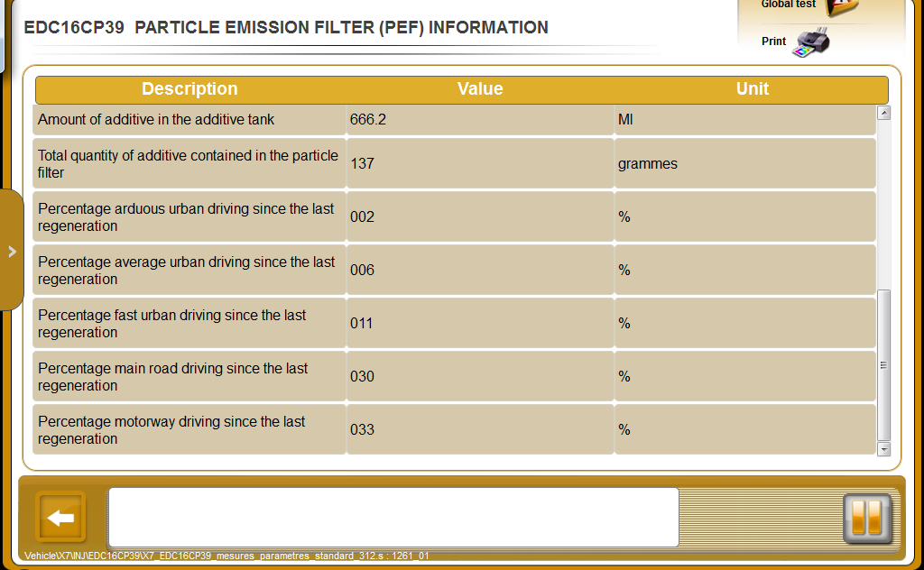

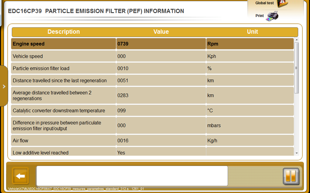

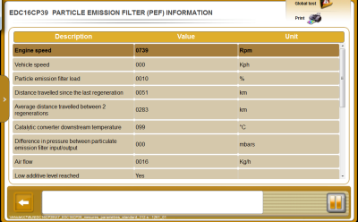

Quick dump of information
Particular filter parameter measurement
Idle speed
771 rpm
Difference in pressure between particular emission filter input/output
000 mbars
Approximately 3000 RPM
016 mbars

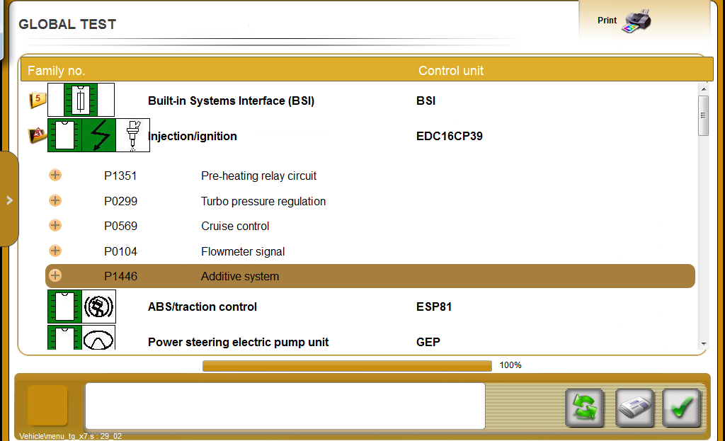

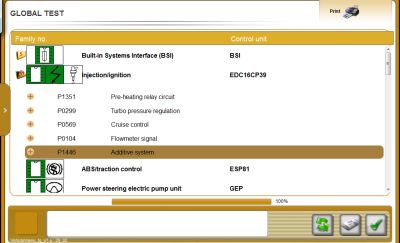

Clear the faults then followed the following path to tell it the additive tank has been refilled:
Repair
Pack repair
After sales particular emission filter repair operation
Replacement of the particular emission filter and work on the additive adding circuit
Filling of the diesel additive adding reservoir

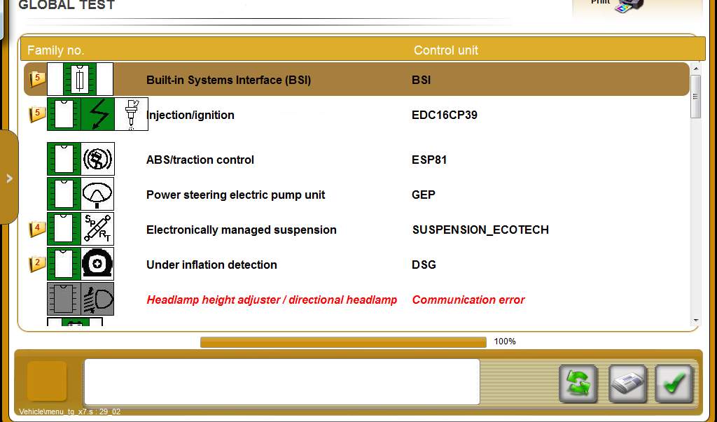

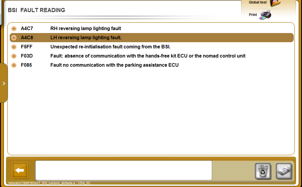

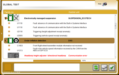

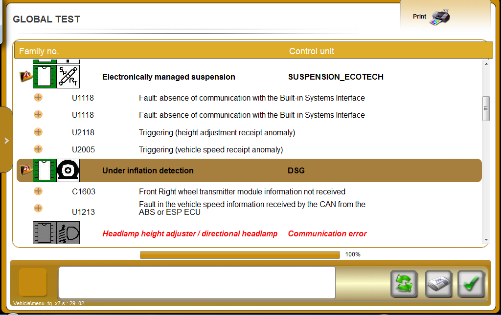

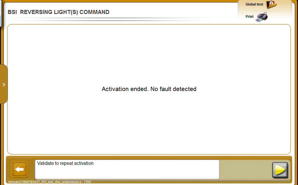

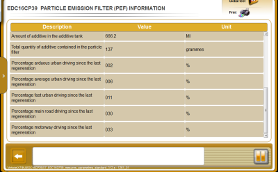

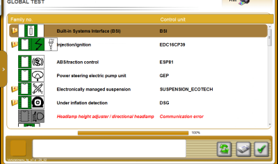

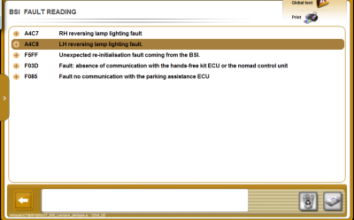

Quick upload of the DiagBox print screens
A
A
B
B
C
C
D
D
E
E
F
F
G
G
