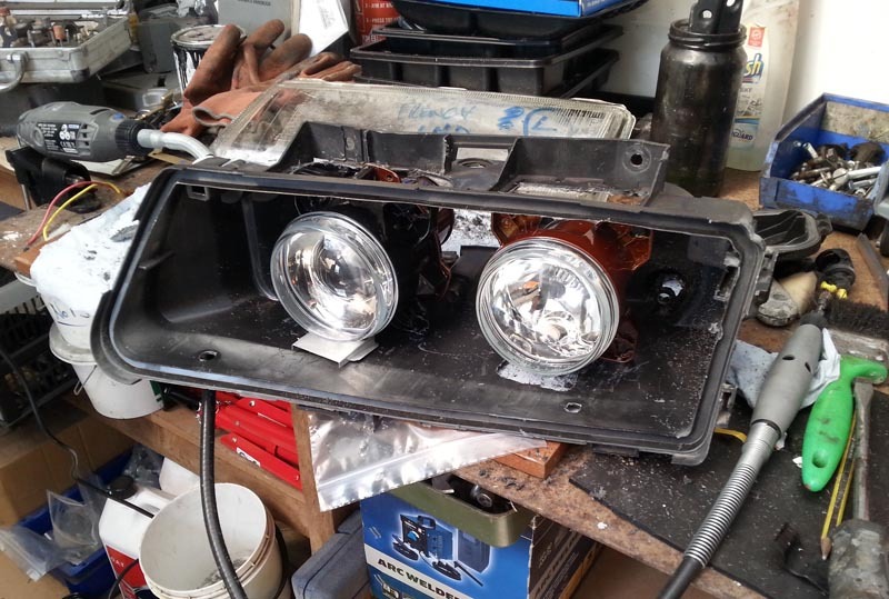

Roughing up the light housing to accept the Hella units.
I will make a set of supports using alloy first then use steel, these will hold the adjustment screws.
I will "weld" these in using resin and add a couple of rivets when in the correct position. Once all the position is correct I will make a cover piece and paint that silver to hide the mounts and keep the OEM look through the lens.
The cut-out in the top & bottom will get a fibreglass and filler layer once I have checked the clearance. I will try and make the little bulge disappear by building up the removed plastic to the original pattern including the two triangular bracings found on the OEM units.

The Badgers wont stand a chance :shock:

With luck I will melt them before hitting them :)

Looking good Alasdair :D

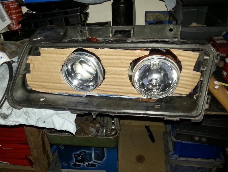

Setting up a rough for the "decorative" plate and getting the spacings for the lamp units correct.
Posts: 28594
x 5626
Re: I am an Activa owner...a V6 and I am an addict
The corrugations finish it nicely - will you be patenting that technique?
