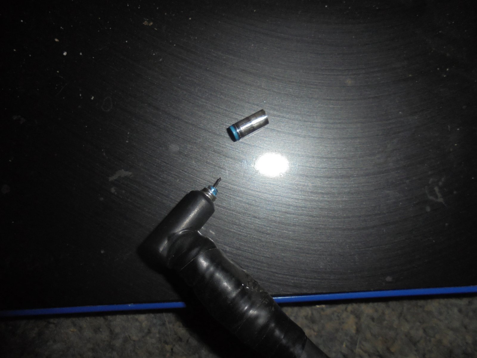

However this morning, my downstairs search has had its consequences. The furniture had been pulled out and moved, and not put back in the midnight search which left a tripping hazard of the charger wire still plugged into the Falcon laptop. and trip I did, hauling the laptop off its table onto the floor, and bending the connector to the power socket.
Ended up with this unintended consequence...wonder if you can even get one of those little "ends" or whether its a new charger. :?:

Plenty of options on the bay of evil Neil but there may be another one. I have a fair few disused laptops with their power supplies. If you tell me the output requirement of yours I may be able to send you a replacement. Help me to make use of one!! No cost, it would be an early xmas pressie! :-D

Pretty much all laptop PCs use a 19/20V charger, but the inside and outside diameters of the plug differ beween brands. Some also have a hidden "charger ID" pin, so best to use a charger of the same brand. I see a blue tip in the picture, HP??

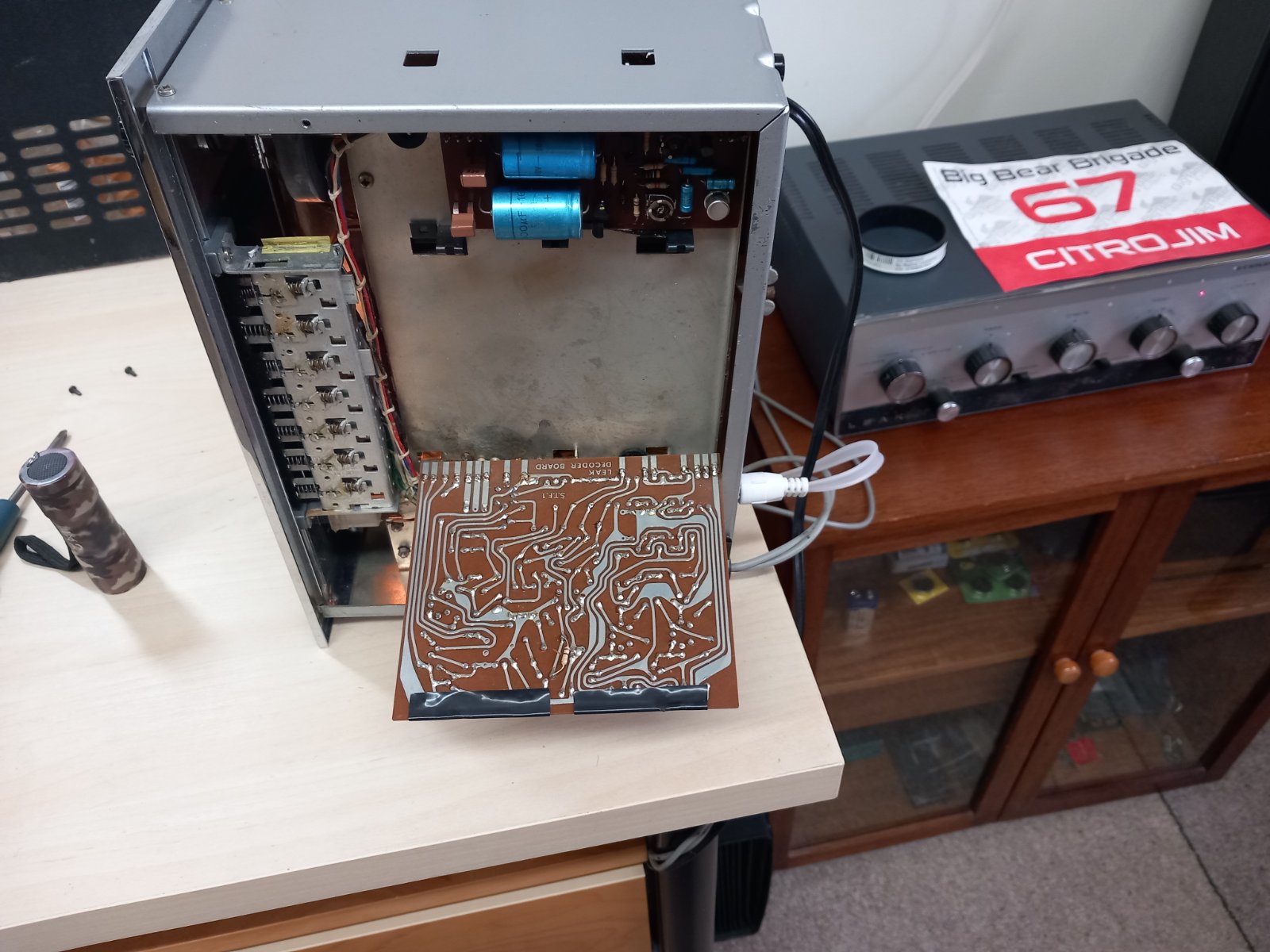

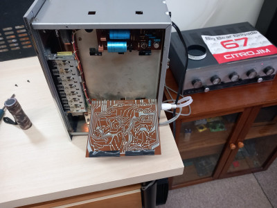

Apropos to fixing things a few posts above, my office Leak Stereofetic (always known as the 'stereopathetic' back in the day :lol: ) FM tuner payed up this morning with one channel failing...
Fixed in around 10 minutes :) A dry joint on the decoder board... They have a reputation for this after over 50 years of service :)
Although jokingly known as the 'Stereopathetic' it was actually a very good tuner and was one of the first tuners to use the then brand-new dual-gate mosfet transistors in it's front end - hence the name!
Seen here in the picture is its companion Leak Stereo 30 amp... This one was a complete basket-case when I acquired it - originally just for spares as it had been well and truly 'got at', bodged and very faulty. During lockdown and injury I was so bored I brought it back to life and and its been as good as gold ever since... This is one of the original germanium Stereo 30s and Leak's first foray into transistorised amps... It sounds good - a bit 'rounded' and not unlike a valve amp... It does not have the harshness of later silicon amps...
