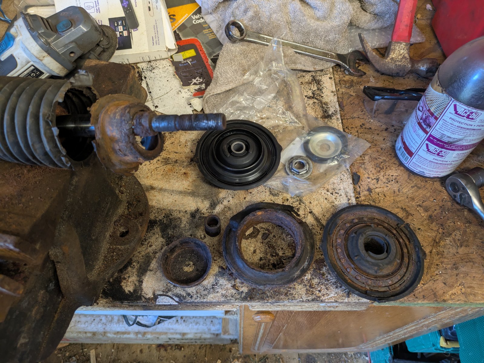

Ok, after a lot of swearing etc I finally have the strut off. I'd already bought a new top bearing because the video I followed said they were pretty weak and likely to need replaced, and it was only £15 on top of the drop link that I was already buying.
Anyway, it looks like I also need the part that goes between the spring and the bearing? I'm not entirely sure what I'm looking at. The whole strut looks pretty ropey tbh.

The rubber gaiter is in bits and it does not come with the strut so you will need one of those.
You could do with a look at a parts diagram to see all the bits. This topic has a link near the end that goes to parts diagrams up to about 2012 so may help viewtopic.php?t=90057&start=15

Thanks for the link, I'm struggling to find the diagram for the strut, got a useful bit about the bearing though.
Looks like the bit I need is this:
Annoyingly, I could have bought it along with the bearing itself for the same price as I've just paid for the bearing! So I'm probably going to end up with a spare bearing. Ah well.

Is this the one for you? https://szervizdoksi.hu/peugeot/sb.html ... T7F550A30A

Brilliant, thank you!
I think I'm just going to buy a complete strut from a breakers. Depending on the condition of the spring and bearing I might put my nice new ones in.
