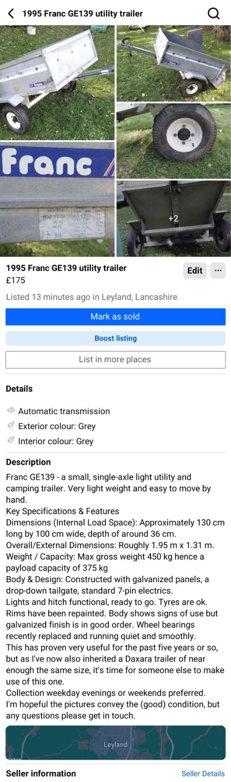

Cheeky plug of a quick Facebook marketplace listing I've (finally had time to) list:
Facebook has decided it has an Automatic Transmission!!!

Facebook, automatically assuming the wrong thing as like some Ai things.
Husky.
