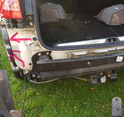

Did you check bumper ventilation vents?

owl wrote: 09 Oct 2026, 19:08 Did you check bumper ventilation vents?
Do you mean the ones behind the side pockets?
There's a small amount of water behind the left one, but not enough that it would be running into the wheel well...
Unless there's more vents I'm missing?

Agour wrote: 09 Oct 2026, 19:38
There are 2 air vents. 1 vent on the far left side (behind the rear wheel arch/quarter panel area). 1 vent on the far right side (behind the opposite rear wheel arch area). You need to remove rear bumper. When tracking down a water leak into the boot, it is highly recommended to check both sides, as the foam gaskets on both units tend to degrade at a similar rate over time.

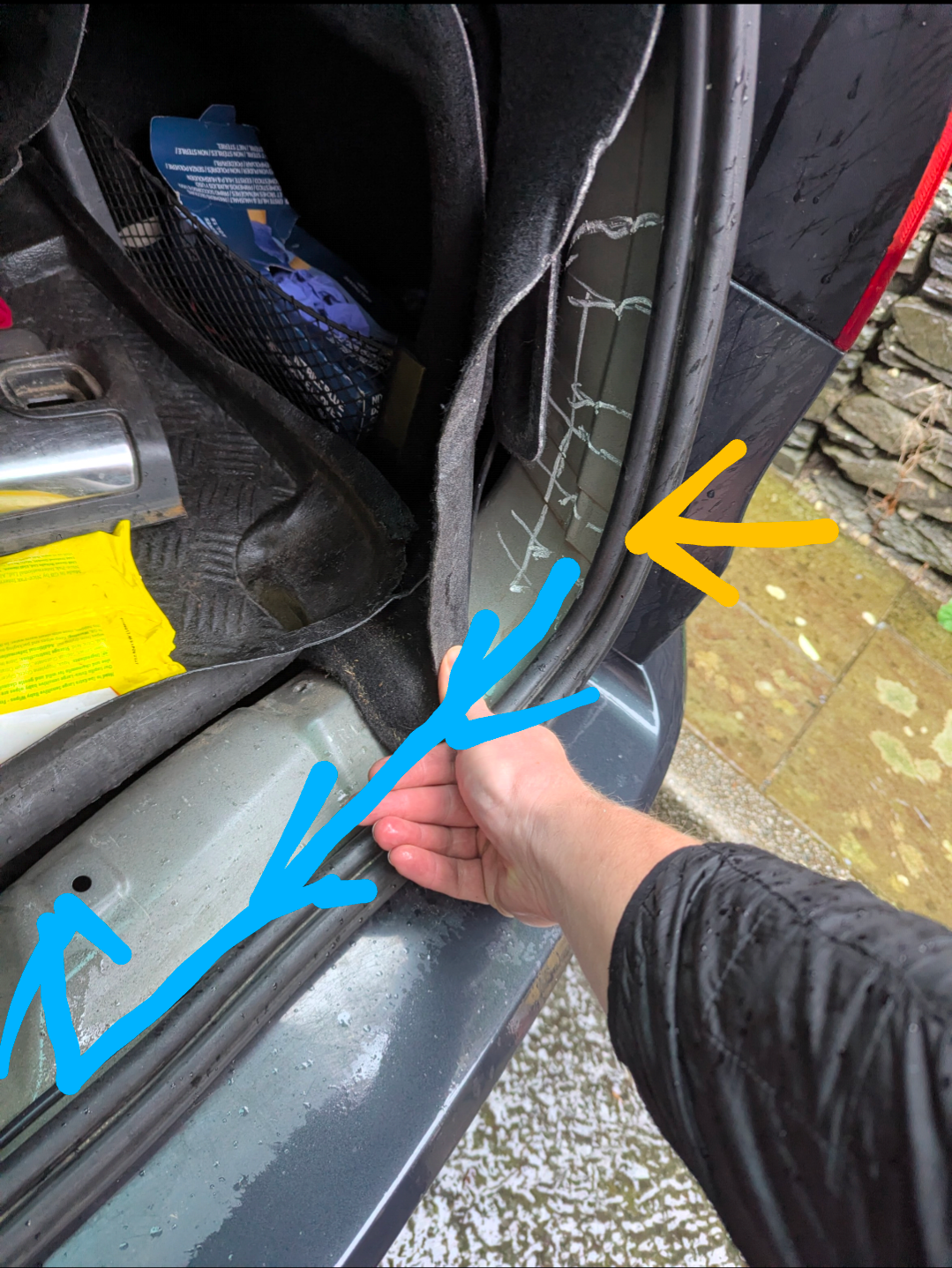

I found where the water is getting in!
On the sides of the boot are small overlaps in the bodywork, and it's getting in through those.. running along the bottom then into the wheel well.
Yellow arrow is where it comes through, and blue is the path it takes.
All the white lines were chalk to narrow it down.

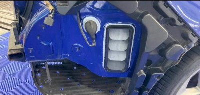

I guess the vents are on the other side under the bumper?
I found a photo on this forum of a bumper off.. would you mind highlighting the vent location?

Agour wrote: Yesterday, 23:56
It is located left and right ends. Do not buy new ones. I used a windshield silicone (black one). It must be dry at least 12 hours, more is super.
