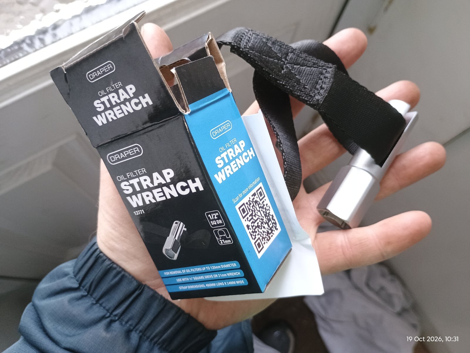

Thanks for the recommendations all!
As Toolstation is a literal 5 minute stroll from home, I grabbed a Draper strap wrench from them.

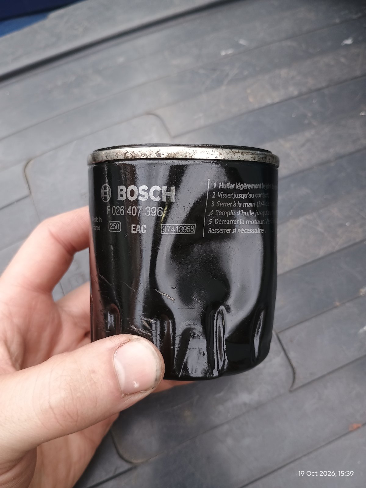

Thats an originalMattBLancs wrote: Yesterday, 15:41 Thanks for the recommendations all!
Bosch branded, unsure how long it's been on. "Squeaky" when removed

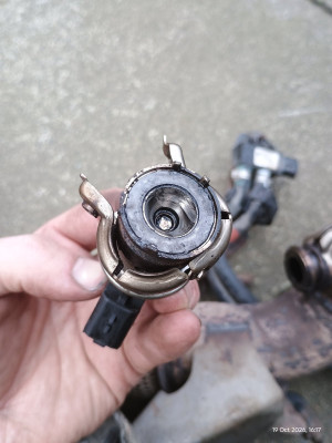

Adblue injector fixing assaulted with mole grips and 4mm Allen and hence a quick look at it just while accessible. No crystals to be seen but was post hot wash out anyway.

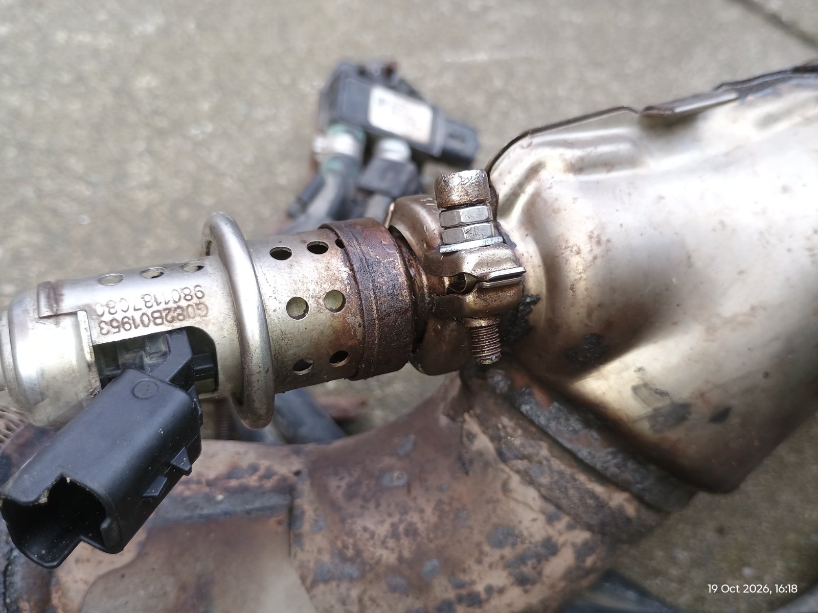

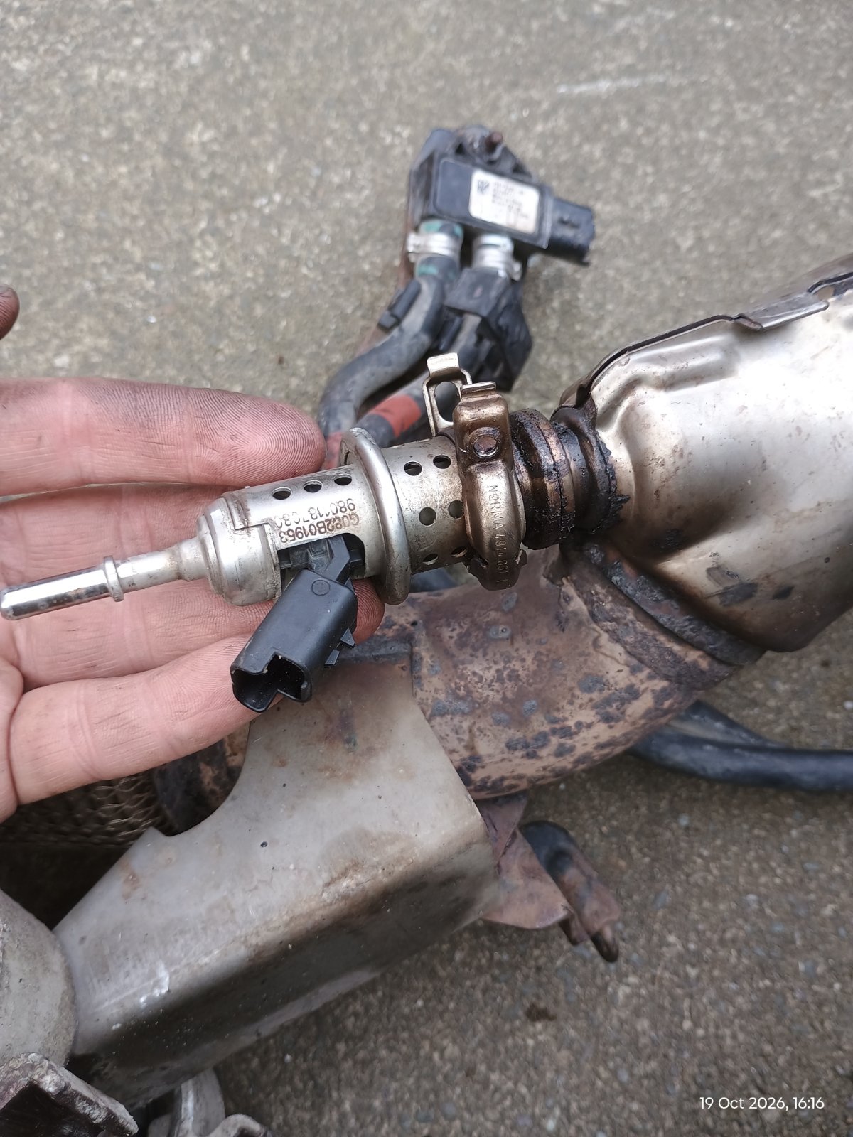

Adblue injector.
M5 nuts are to give a bit more to get hold of (if needs to come off in future, without taking the whole DPF off again, hopefully!)
Adblue injector.

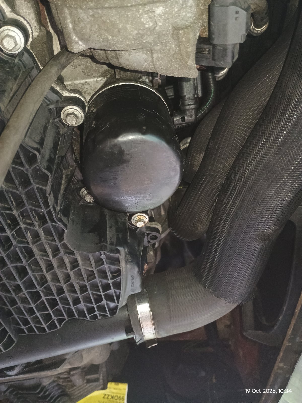

Oil filter location and new strap wrench.

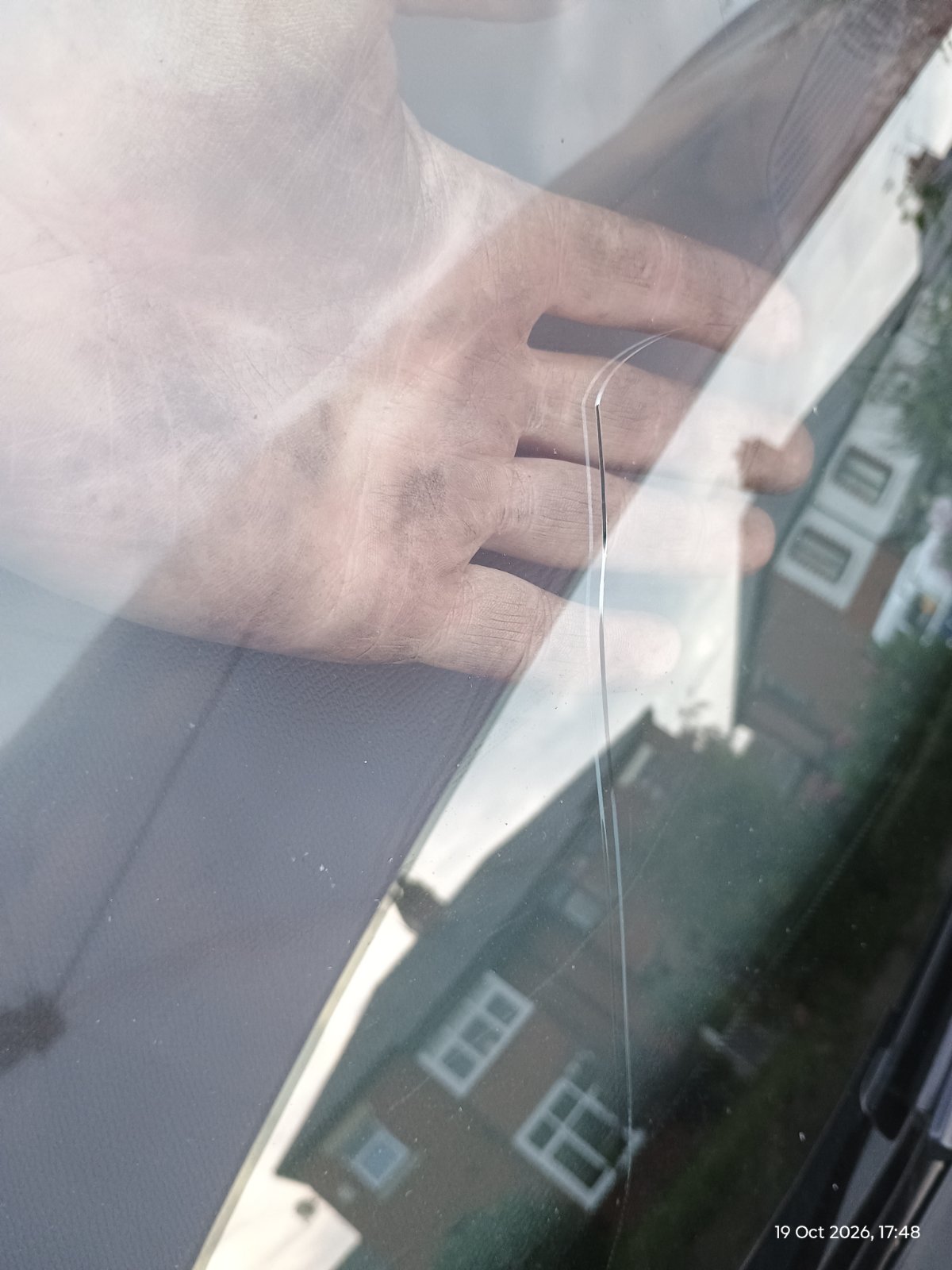

And finally, in a great case of one step forward, two steps back!
The chip in the windscreen I've been keeping an eye on doesn't need worrying about any longer
