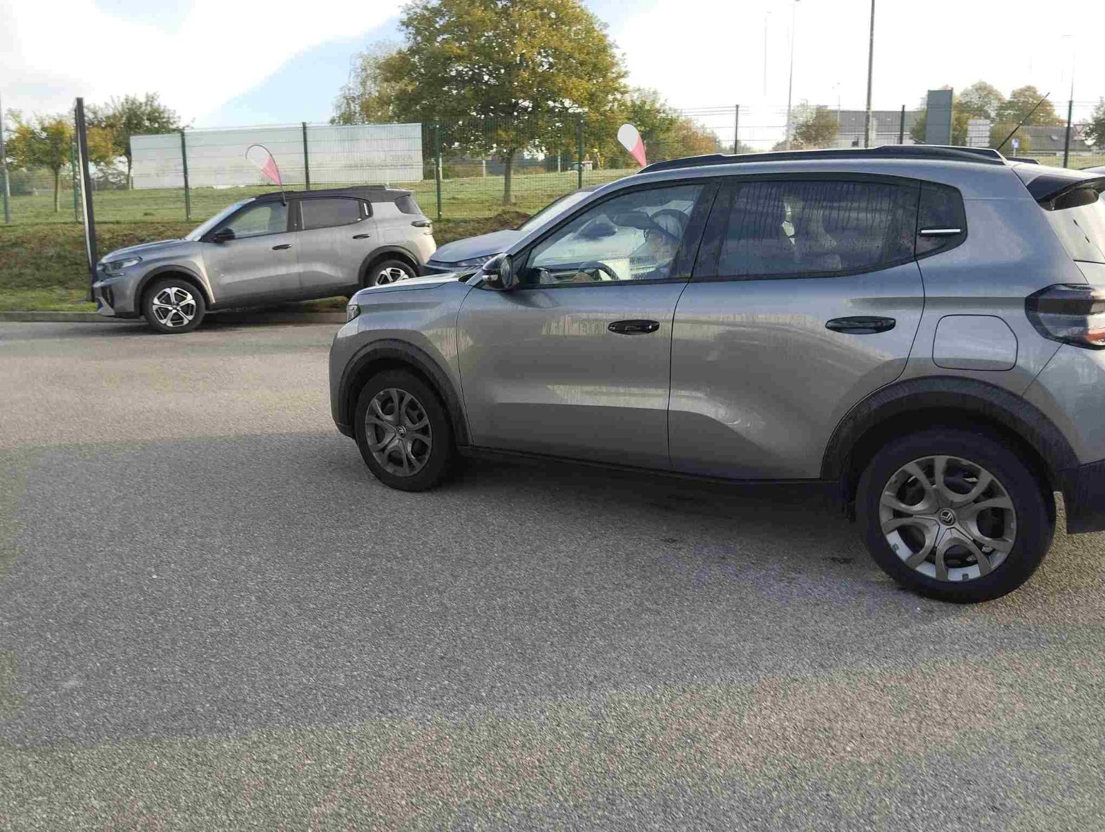

Can you post a picture of the wheels Vic, with size info, so that we can see what is needed and maybe someone will have one available? :)

Mme's out with car & this is only pic I've got.
The tyre is 205/55 R16 with 4 holes at 108 pcd.
I think the usual spec for car is alloy wheels but it appears that car hire companies buy them with steel wheels & trims as it's cheaper & less hassle to replace trims on curbed wheels. Mme doesn't mind as that's her speciality :lol:
