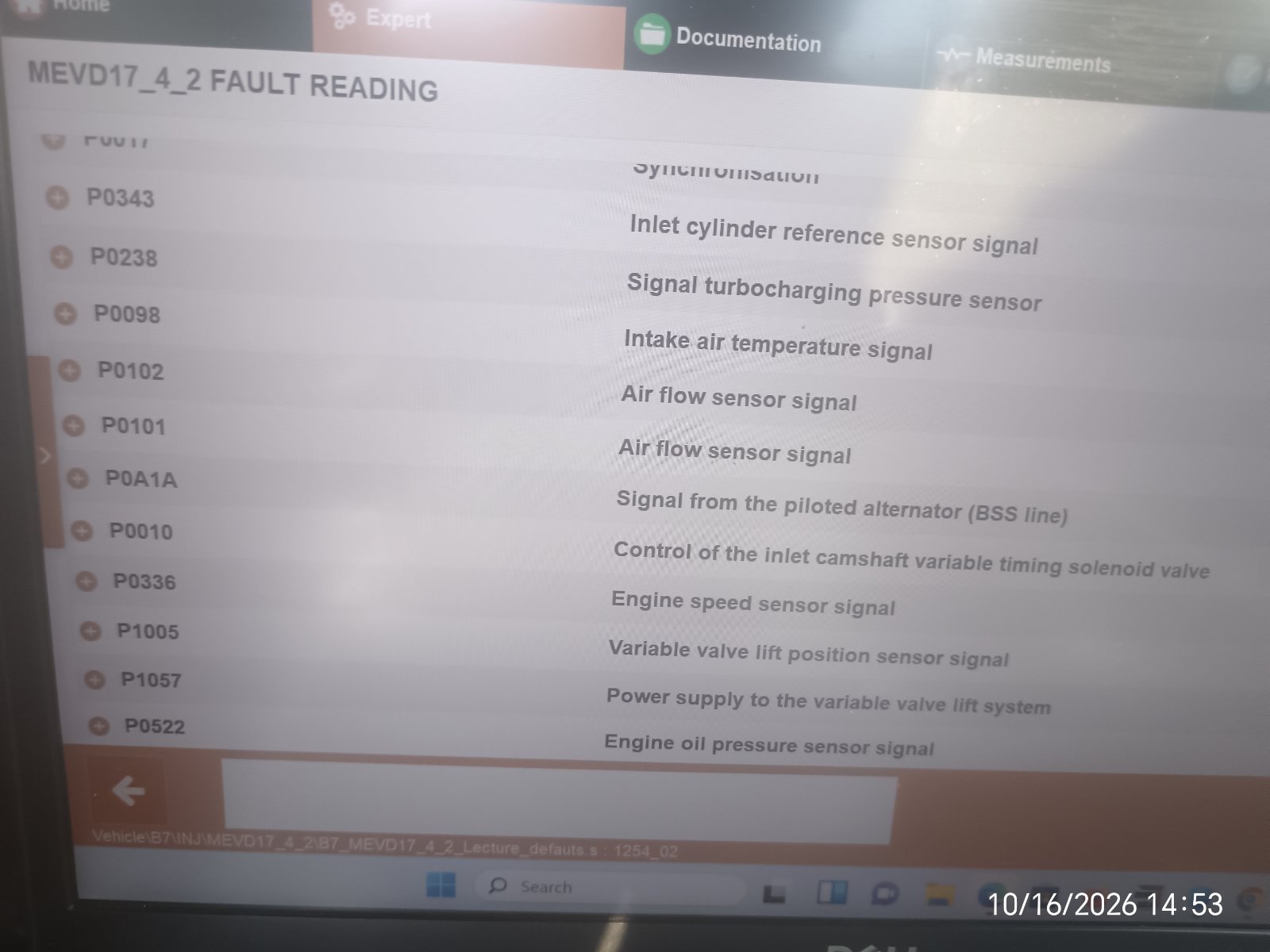

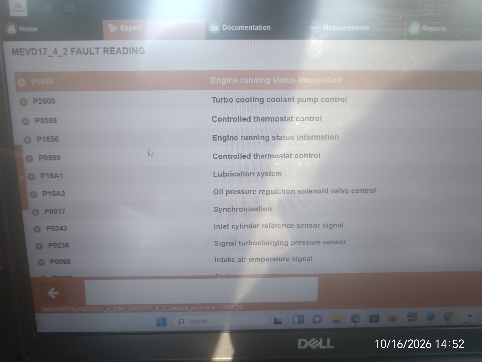

Re: Citroen DS4 has no spark
Good day
I managed to do some diagnostics on the car , the engine didn't have any compression i checked the fuses in the car and the shunt fuse was on Parc ! I changed switched it to client ,car key was working fine, crank sensor was working fine but still no spark .
Did the engine run before you did all the recent work on it ? If you delete the fault codes do they all come back ?
Yes the engine did run before ! I did clear the codes and they all came back.
