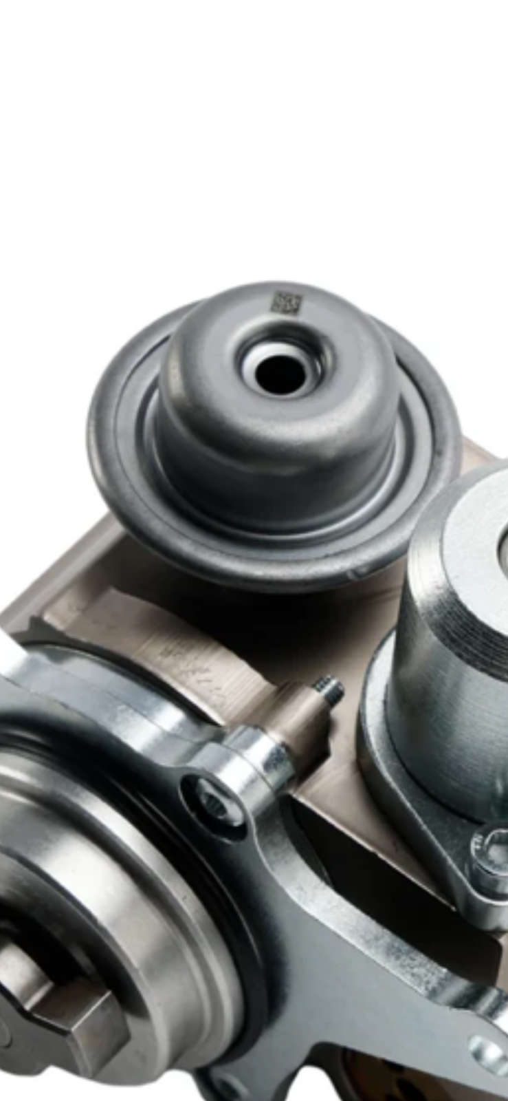

The pump has a membrane in an external housing, a cup, where you can measure the position of the membrane..The distance from the top of the housing to the membrane increases with use. 22mm is new. 26-27 is end of life. Checking it is easy and can be done with the pump in place.
The pump is at top of the engine and access is only a few minutes, just remove the plastic inlet ducts, be gentle. The membrane housing, a small cylinder, faces downwards, and using a vernier calliper to measure it would require some magic. I put a match in a small piece of cardboard (photo) and measured it afterwards, 27mm. I wonder how the poor engine had run at all.

The membrane housing that faces downwards
