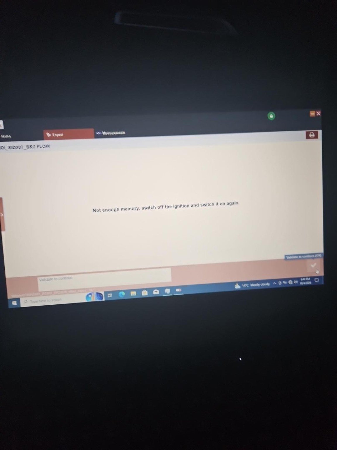

I then tried to erase the faults. On the first attempt, DiagBox displayed “Not enough memory, switch off the ignition and switch it on again.”

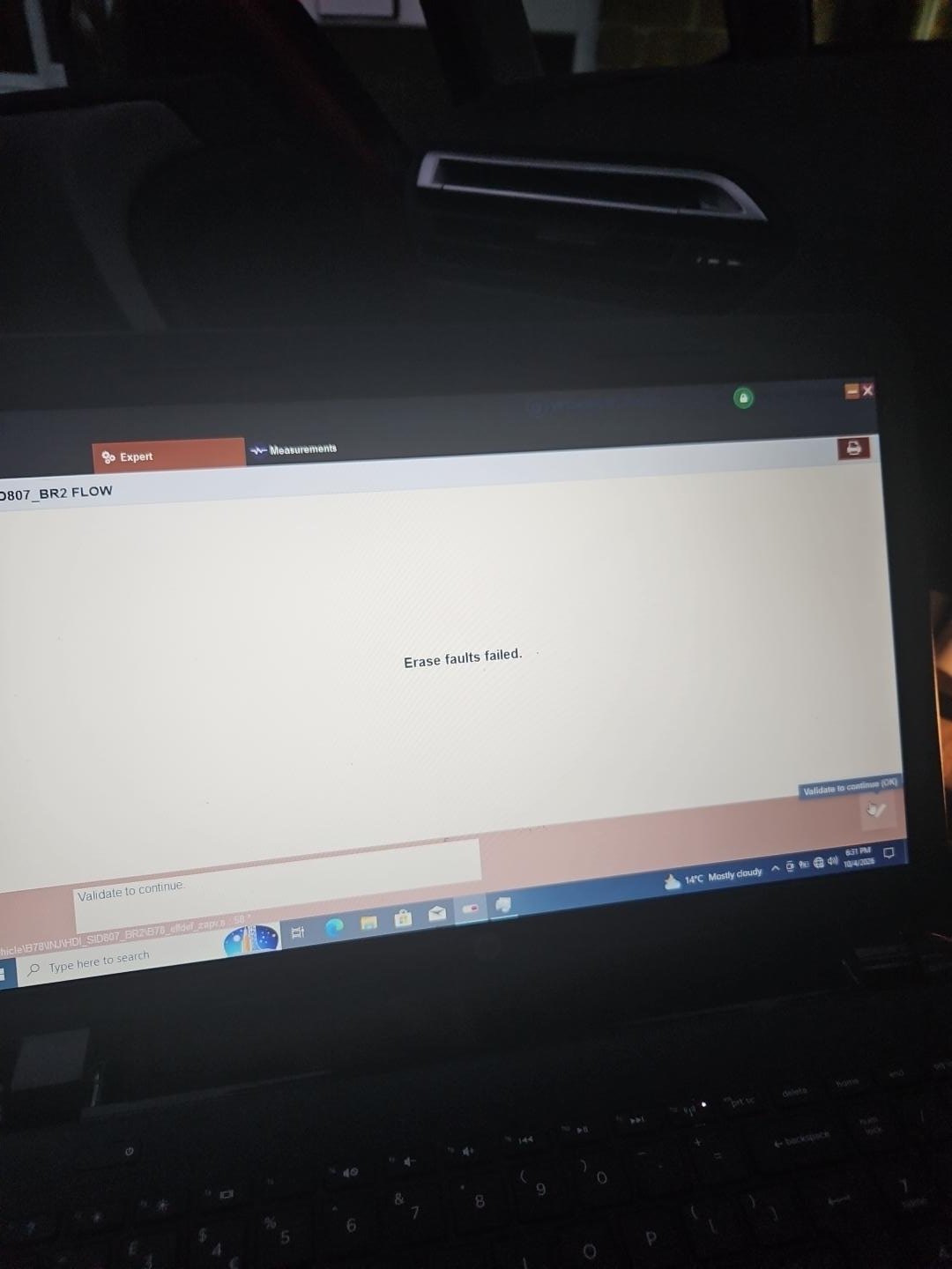

I followed the instruction, switched the ignition off and then back on, and tried to erase the faults again. This time it gave me “Erase faults failed.”

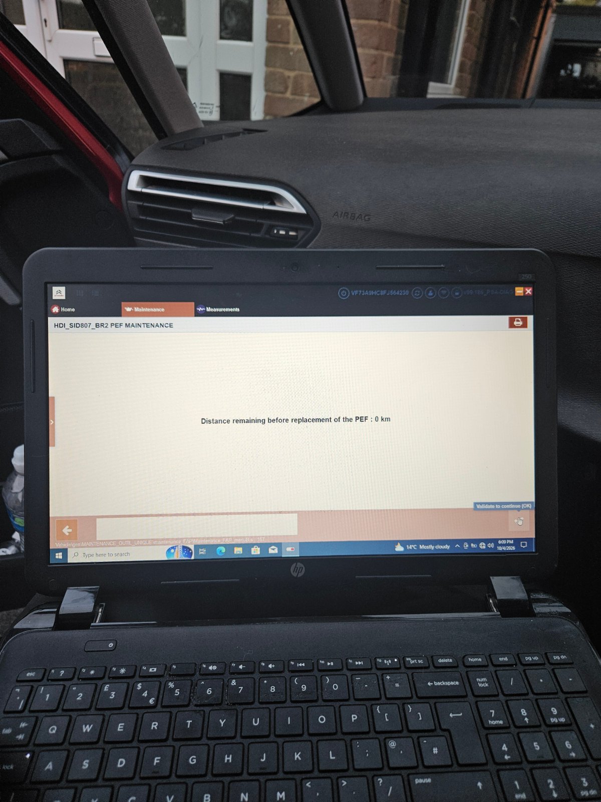

I also noticed in the PEF maintenance section that it shows “Distance remaining before replacement of the PEF: 0 km”. I’m not sure whether this is connected to the additive issue or whether it is a completely separate maintenance counter.

If you look in the live data you can see how much additive it thinks it has; this will tell you whether it has registered the fill or not. When I did mine (2017 1.6 C4 Picasso) a couple of months ago, it ran the refill procedure and cleared the fault code all at the same time.
The PEF life remaining is a separate issue - there is a pre-programmed life of the filter, after which it will say it is end of life and should be replaced, due to ash accumulation. However, in most cases, they ae still good for many more miles yet. Check what the pressure differential is and if it's 3-5 mbar at idle and <40 at 3000 rpm, and the regen frequency is say more than 300km average, then it should be good to go, and you can jut run the 'replacement DPF' procedure - best if you can to work out when it will regen it, and then catch it soon after that. Even if the pressures / frequency are high, you could remove it and back flush it to wash the ash out which should pretty much restore it.
