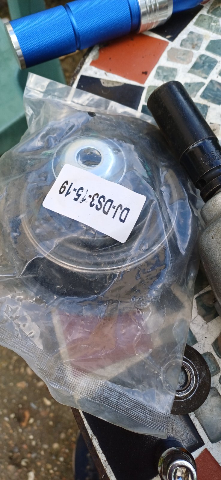

As above , so my passenger side has started to make them noises from the top mount but not creaking yet on full lock as its only been maybe 2 weeks, im wondering if that very hot weather may of contributed towards the failing mount . Sets ordered for both sides 34 quid mounts bearings nuts and so on.

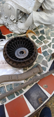

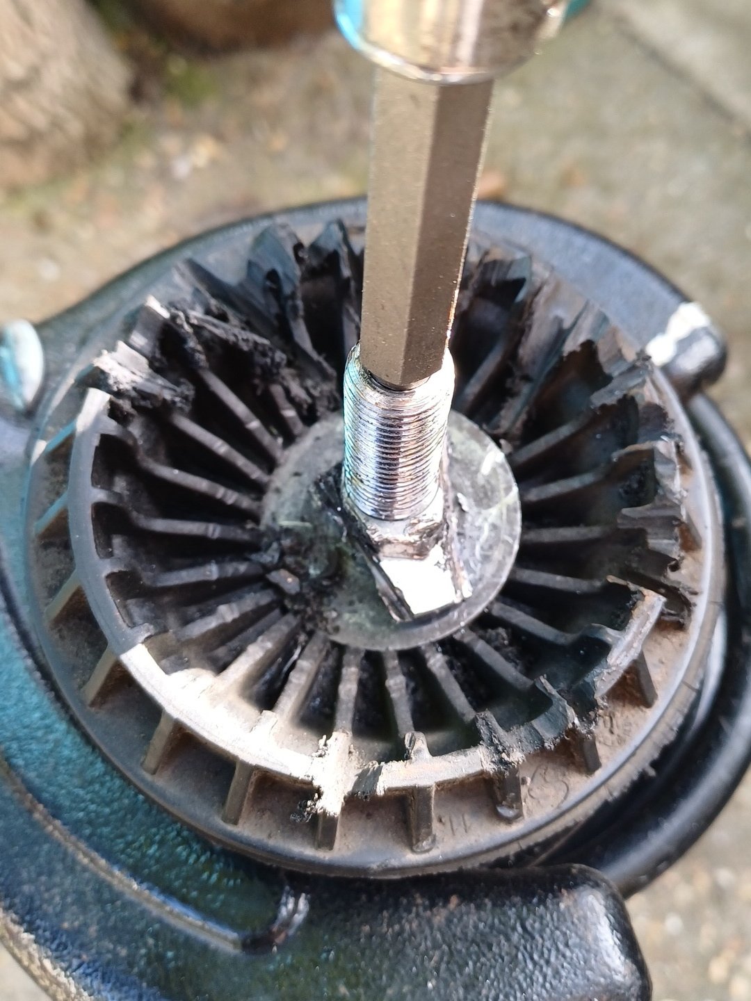

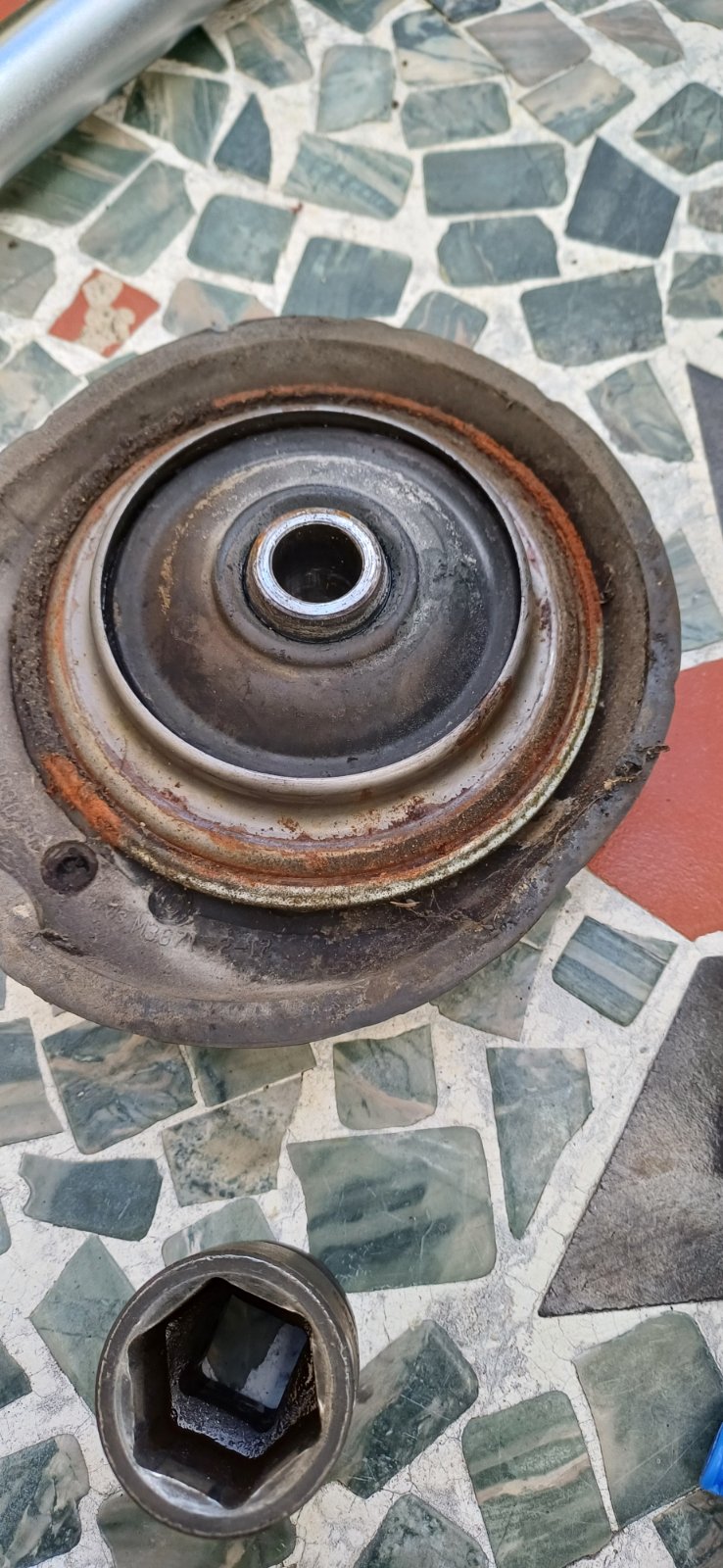

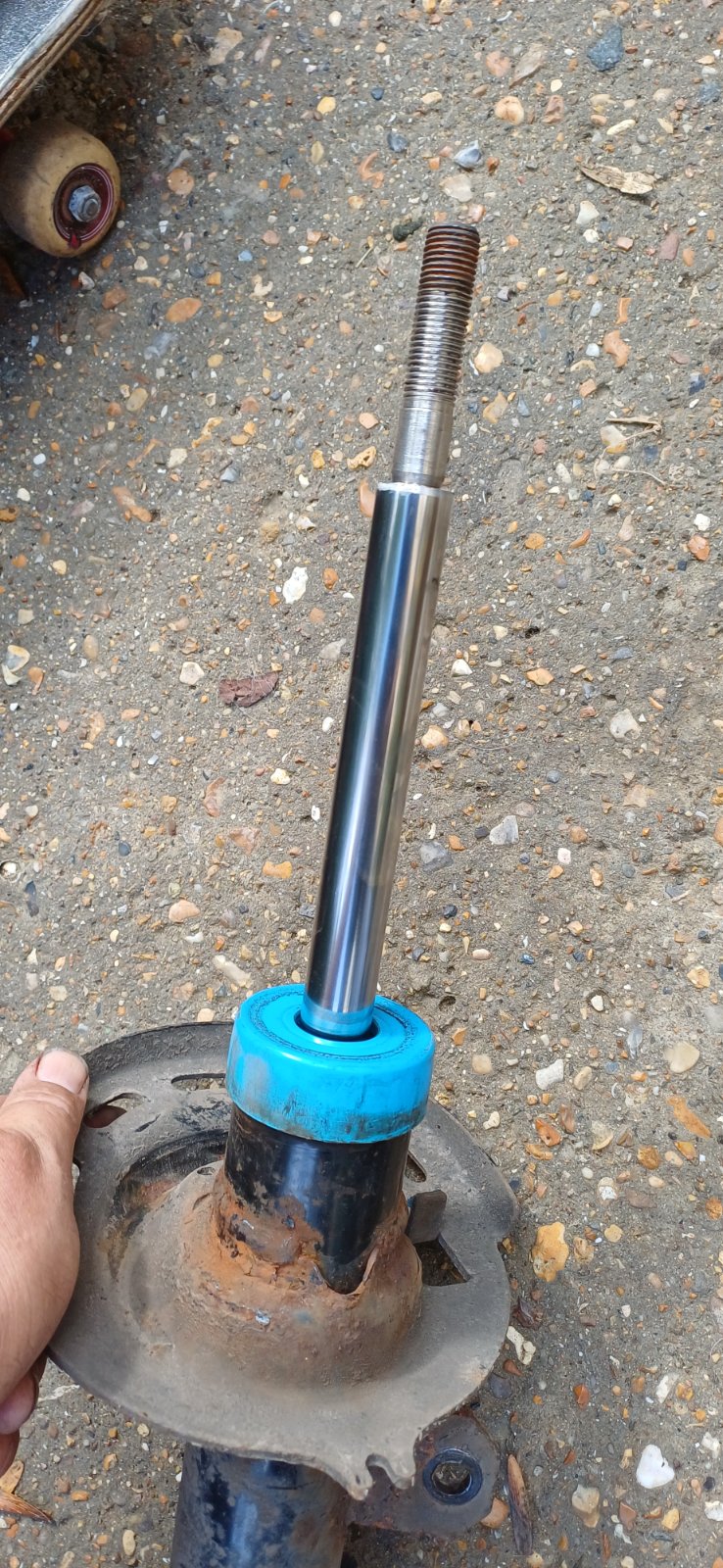

Finally its done and what a job the shock was well past its best the top mount wasn't bad but the rust on the bearing . Its all new now
Husky.
Huskyxantia
- Posts: 3873
- Joined: 30 Jul 2018, 22:11
- x 899
Re: Peugeot 2008. The new chapter
Yes the one that came off it had been fitted wrong as you can see by the above the nut had to be cut off it was over toqureed and in the wrong place no wonder there was hardy any thread fir the actual top nut under bonnet bloody scarey that now its got everything in the correct place and everything is correctly toqured up aswell

Forgot to mention I had a beard new cup left over from a job ages back so this came in very usefull and is on the set up . So glad is all done I started at 9.30 as it did stop raining finished at 4 im wacked .im getting to old for this , its all the faff plus over half hour to set the tools up and put them away plus I had to repair my spring compressor the piston came out the housing so I spent 45 mins fixing that too...... im putting my feet up .
