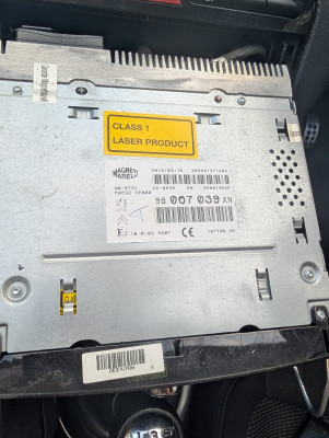

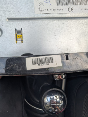

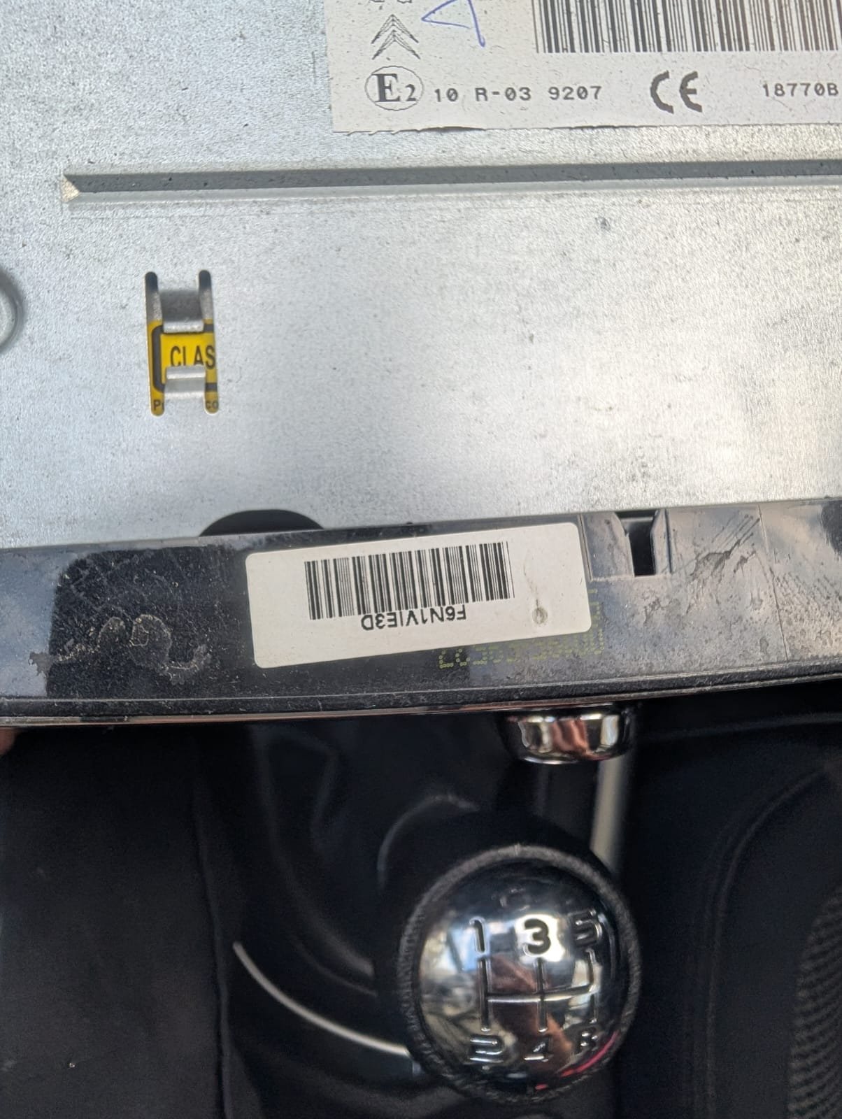

If you've had the RT6 unit out have you looked at the various labels stuck on the case to see if one of them shows which version is fitted? The label is quite often there. Photographs would help.

This is the sticker on top of the unit as i pulled it out

Sadly neither show what we're looking for. The best I can suggest is that you start on a lowish version number and work your way up if that doesn't work. I'll send you links to 2.37, 2.71, 2.77, 2.80 and 2.85. Check your PM in about 5 or 10 minutes. If you find you need 2.86 come back and ask for it.
