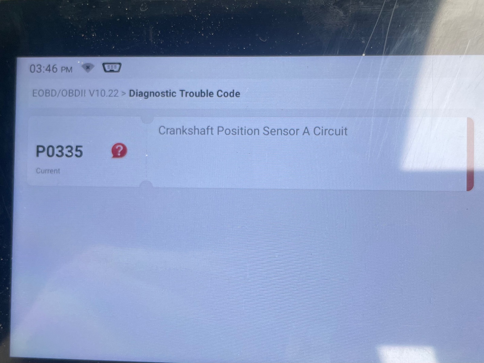

It ran perfectly and started first time every time, until it didn’t… came back to the car after shopping to find it wouldn’t start at all, and threw a p0335.
I’ve replaced the crankshaft sensor (Citroen original part) and no improvement, was advised by RAC tech to replace pigtail connector as apparently these are a common problem. Replaced the connector, still no improvement. I even replaced that section of the loom with new wiring to eliminate any possibility of a wiring issue.

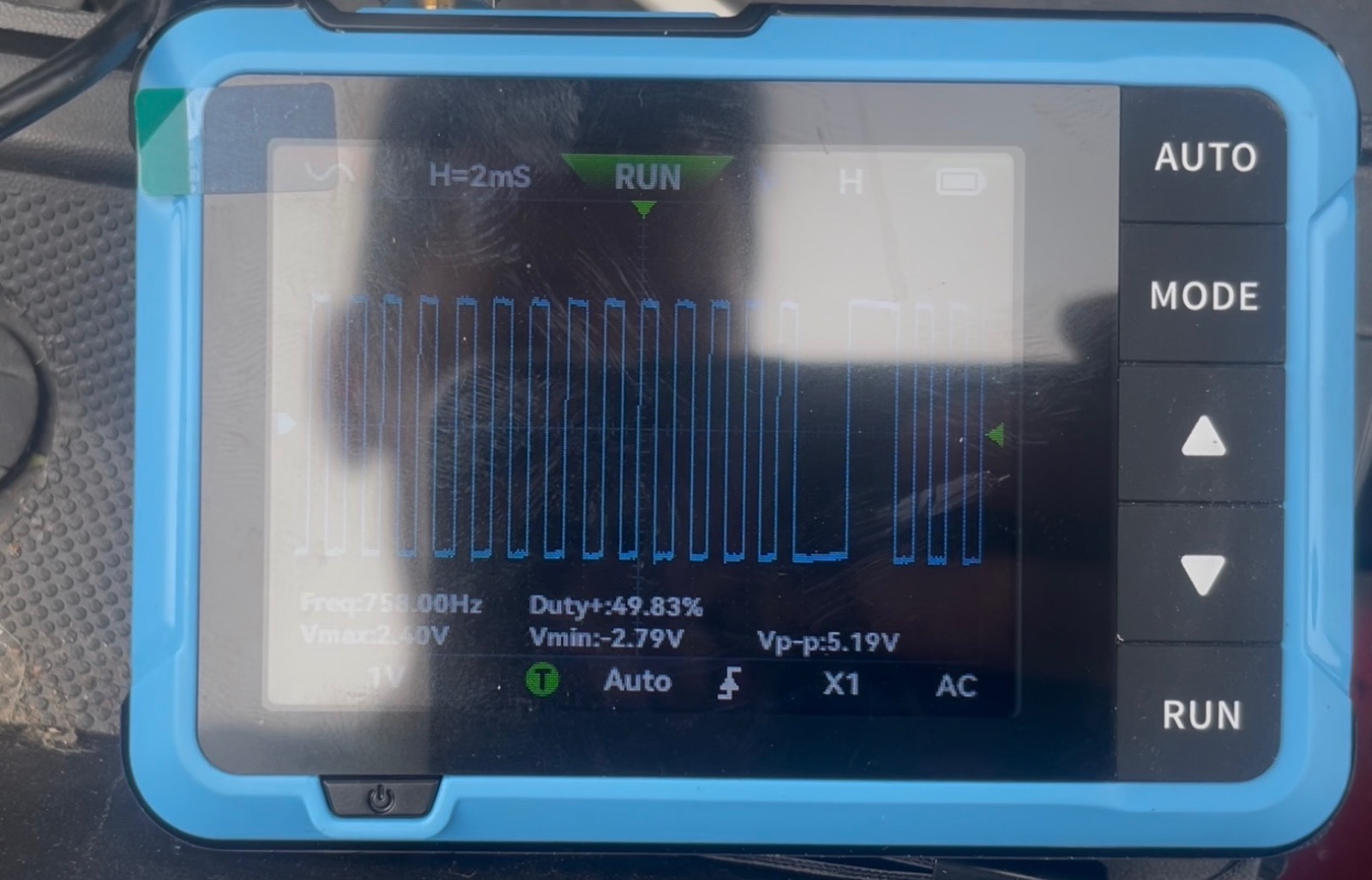

Hooked up to an oscilloscope as something seemed off and signal is perfect from sensor to the ecu. (So the reluctor ring is fine)
Then it gets odd. After about a week of no time to look at it I tried it again and it fired up, ran perfectly for about 10 mins and then cut out. Wouldn’t fire again for the next 5-10 attempts, then fired and cut out after a few seconds… wouldn’t fire again for a fair few times, the fires up and ran perfectly for about 5 mins before again cutting out.
Whilst running the sensor pattern on the scope is perfect but then just cuts out.

Yeah, main dealer parts used, as I say I’m at the point of the sensor is DEFINITELY not the problem, neither is the wiring (replaced the entire length of wiring from sensor to ECU) or reluctor ring (perfect scope pattern), hence my confusion.
As you can see in the pic of the scope it’s signal is perfect (measured next to the ECU between ECU ground and sensor signal)
I’ve replaced the wiring just to rule out intermittent faults too

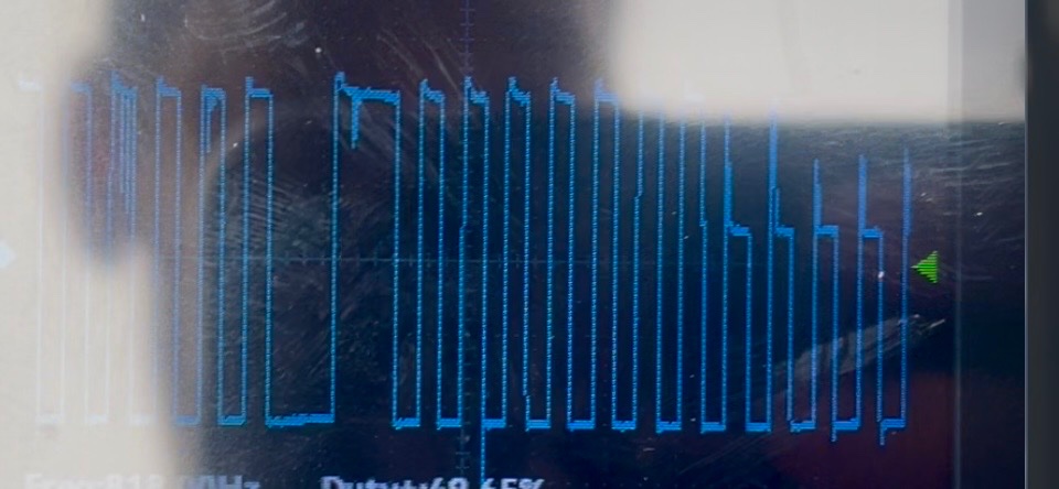

Cheers Paul, fuel pressure is running at a solid 330000kpa so I don’t think it’s that. The second one I’ve already read but I agree, that is a different issue.
One thing I have noticed just when reviewing some oscilloscope footage is just before it died of the sensor data dropped by a couple of volts… makes me wonder further about the ground to the ECU that it then uses for reference… would this ring true to you as a likely possibility?
Do we know the location of that ground as I haven’t got a workshop manual or wiring diagram? (The first post wouldn’t let me view the wiring diagram within their post)
I’ve attached a pic of where the signal got messy just before cutting out
