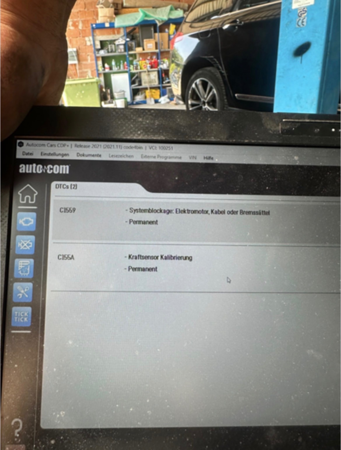

I replaced the cables, rerouted them exactly as they were, and tried to calibrate it with a diagnostic tool, but without success. I only hear two or three clicks in quick succession at half-second intervals, then the diagnostic tool throws an error.
The error memory indicates that the brake is locked. There are no other errors.

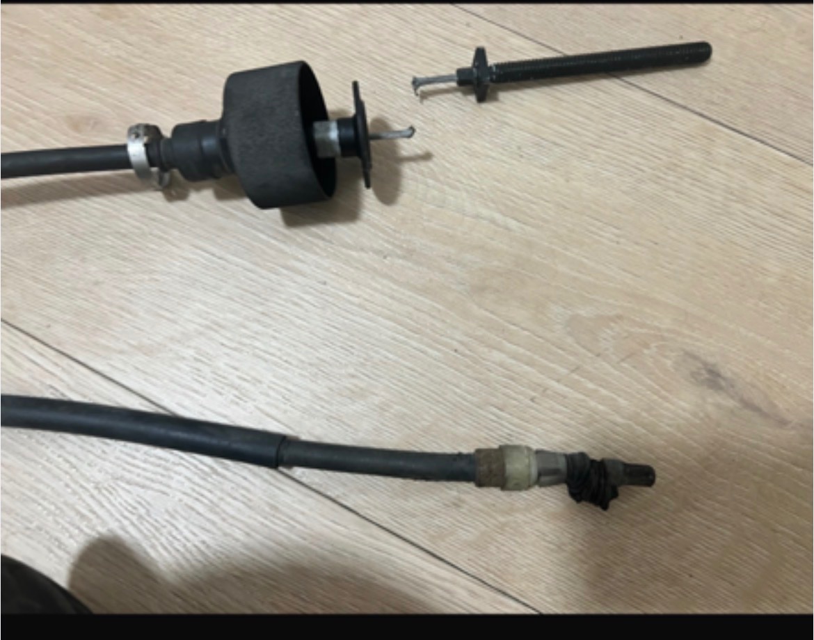

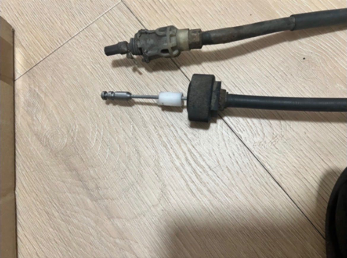

On one side of the electronic parking brake, the brake cable is simply hooked in, while on the other side, it's screwed in. How much does it matter how far one side needs to be turned in? I've attached a photo.
