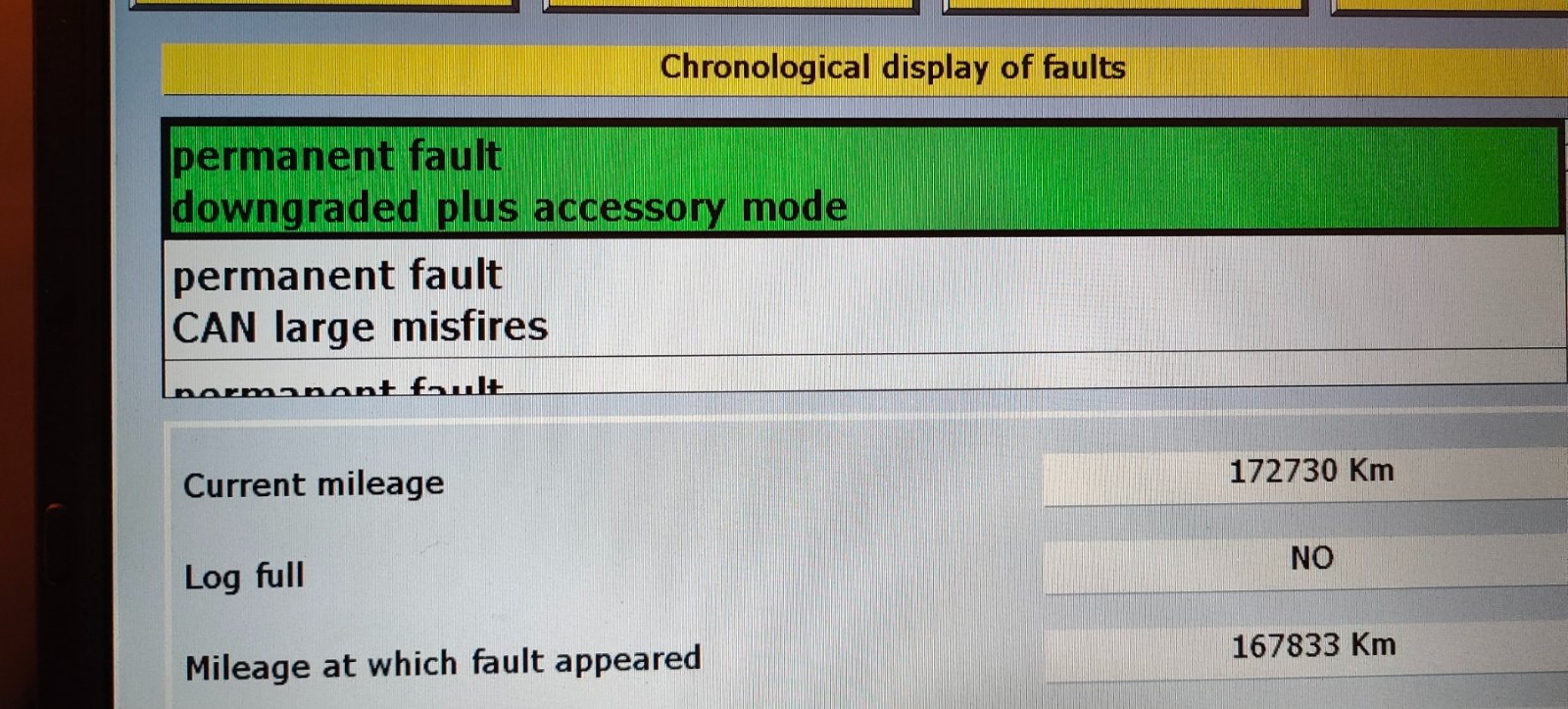

Sometimes when trying to start the car it doesnt cranks but only clicks when you turn off the key and try again it starts fine.Can someone help?

If the above are all ok then it could be the starter motor at fault, especially at 167k km
