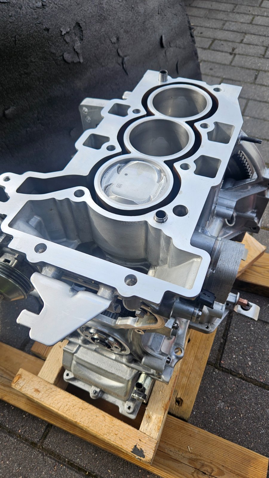

Hello.
I am confused about my citroen engine cycle?
In the picture you can see the nearest piston (cylinder three) is up when the crankshaft lock pin is in place. In the picture it looks like cylinder 1 & 2 move same direction and same time, is this possible?
What I have heard, usual the 1 & 3 are in same "cycle" (nearest cylinder in the timing and nearest cylinder in the flywheel).
My car is
Citroen C3 1.2 SX III phase I (81 kwh, HNZ/EB2DT).
How the cylinder cycles goes in my car? Where to find information 😅?
