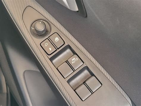

My C5s were the same, the current Mazda and it's predecessor were both like this, but the other way up, i.e the 12 O'clock position retracts the mirrors.ozfrog wrote: 25 Aug 2026, 06:30That’s how my 307SW light stalk works. It’s also how both of my 406s, my 306 cabriolet, and my wife’s 3008 light stalks all work. I’d say that it’s a good chance that the 307CC will work the same way.PaulC5 wrote: 24 Aug 2026, 11:28 If the light stalk is like our Citroens and Peugeot, then to turn on the fog lights the second rotary switch on it is turned to put on the fog lights, first position does the fronts and second the rear one. The reversing light comes on when the gear lever is put in reverse.
