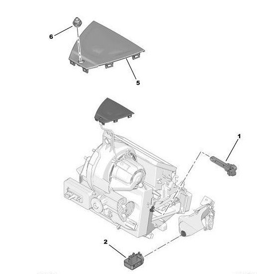

From attached picture i have changed the sensor 1, but cant find sensor 2.
Can you help me where to find this sensor?

Do you mean you can't find it on your car or you can't find a replacement?

Hi
I can't find in the car.
Followed all wires no luck, so maybe it is not placed in the heatingbox?

The sensor you changed, number 1, did it look like this:
https://uk.findthedeal.org/p/B0G5JQKHGM ... tion=41252
If not then this is the second sensor and I believe it is fitted on the back of the compressor at the bottom front.

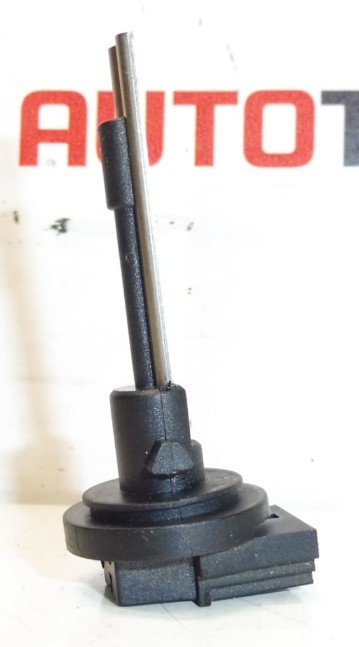

Hi
The sensor is indside the cabin.
The one I changed :
The one I changed :
TonyHansson
- Posts: 4
- Joined: 24 Aug 2026, 09:35
Re: DS3 HDI 2016 Aircon sensor
The one i'am look for:
