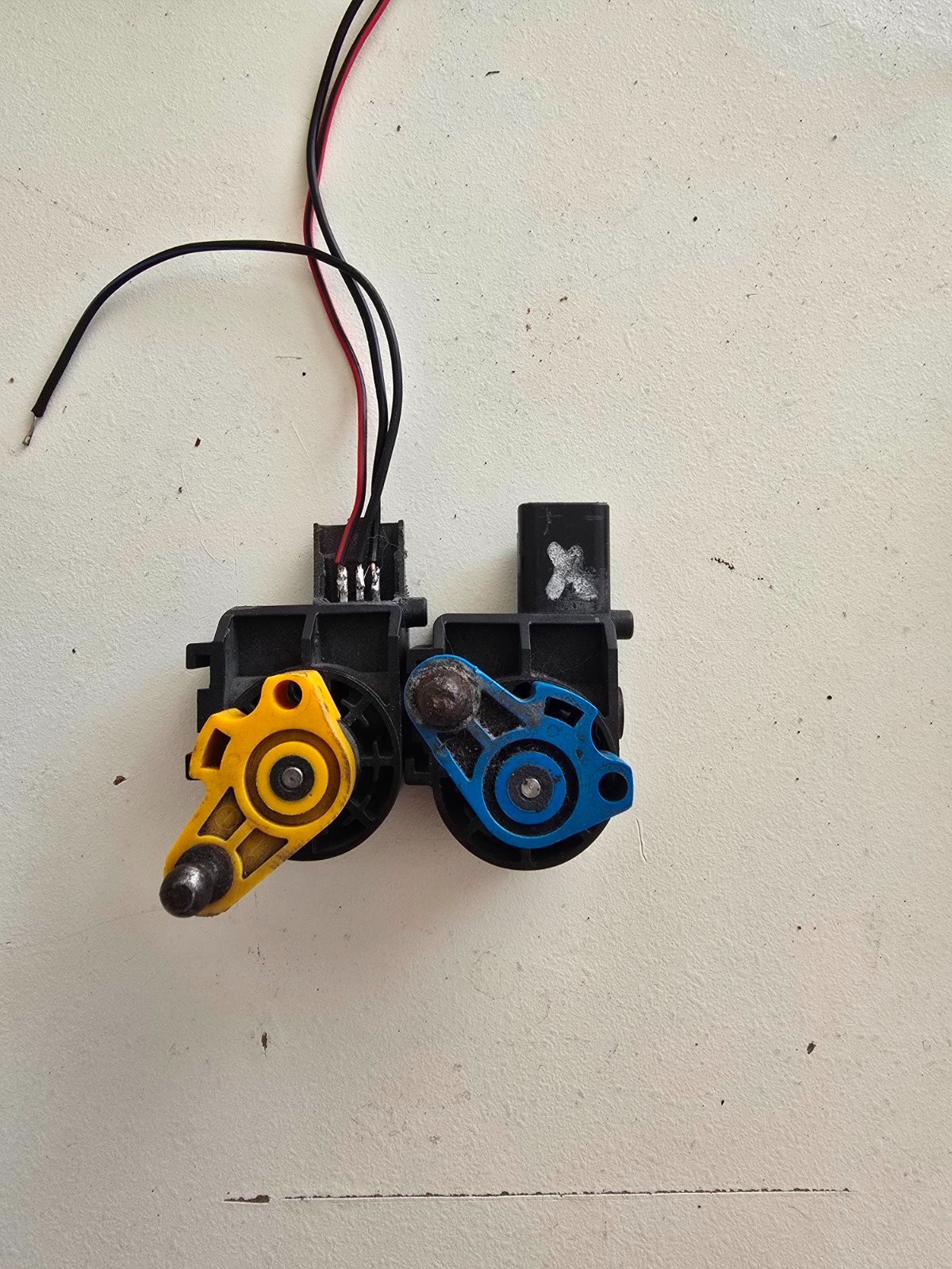

Recently bought a Citroen c5 c7 2.2 that won’t raise the front suspension. The rear works fine in all height settings. I’ve changed the height sensor but it didn’t change anything. I’ve also charged the battery since it was in economy mode. Anyone has an idea ?

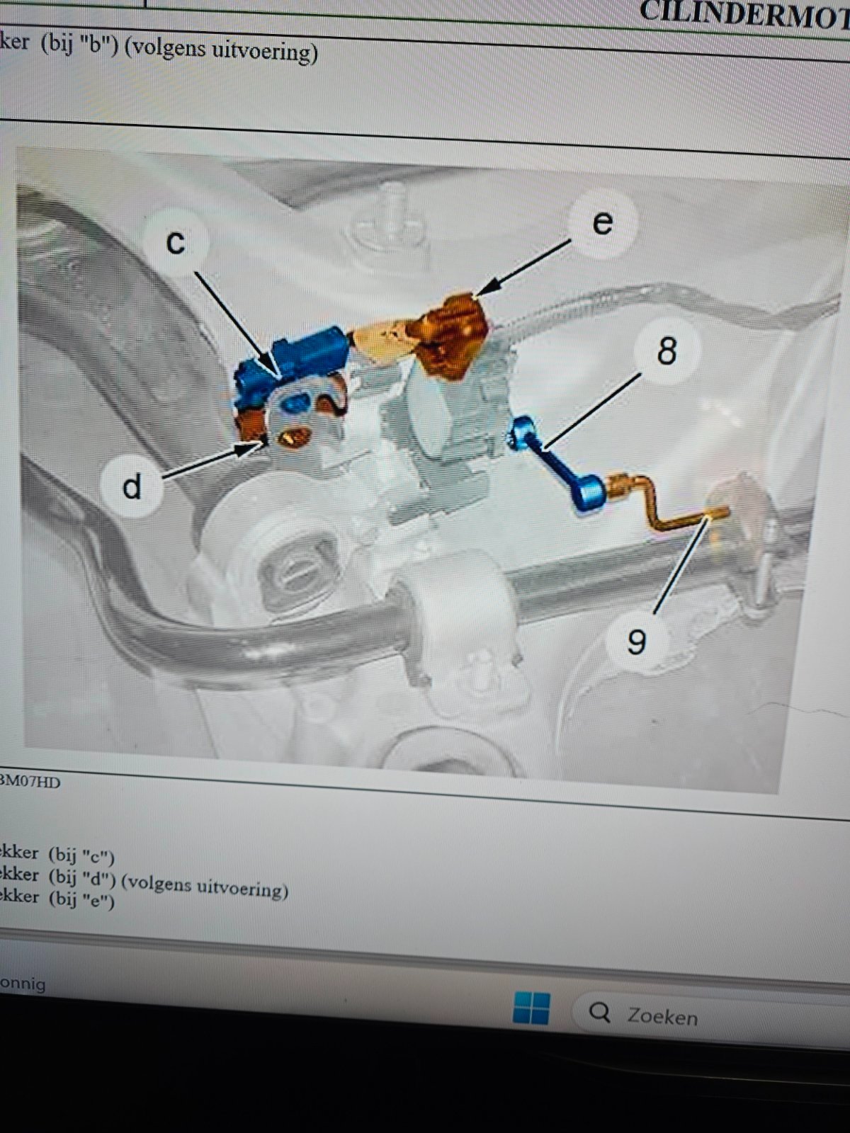

Re: Citroen c5 2.2 x7 -13 stuck in lowest
What might have happened is that (when owned by the previous owner) the dogbone was disconnected, the lever for the height adjuster was moved (possibly without being noticed), and when the dogbone was re-connected it was moved incorrectly. For example, it is possible that the levers (height adjuster and roll bar) are meant to be parallel, but now they are opposing. I would be inclined to look at the rear height adjuster setup to see how things are physically connected and then make sure the front height adjuster setup is the same (and, if it is not, correct it).
Kees
- Posts: 608
- Joined: 16 Nov 2021, 16:16
- x 150
This is what i meant in my first reaction to you.
Look at the picture.
It's possible to connect both positions to the little rod to the clamp on the stabilizer, and i said Look at the position it is now, then turn it 90 degrees and reconnect the lever and see if it solves the problem.
Unfortunately my car is a V6/3.0 and have 4 height sensors, so i can't tell you what the positions original must be.
Maybe this helps you.
But it's difficult to see, the position of the lever.
