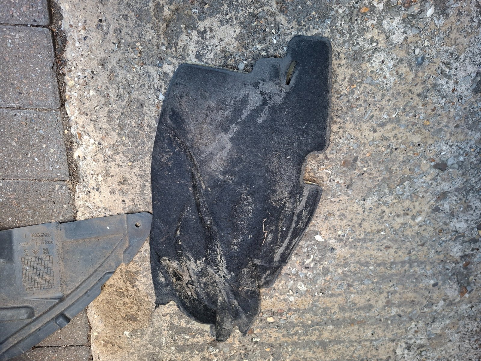

Bathroom work continues apace and lots of old bodgery is being revealed... The space under the very squeaky and wobbly floor was full of all sorts of old builders and plumber's rubbish!

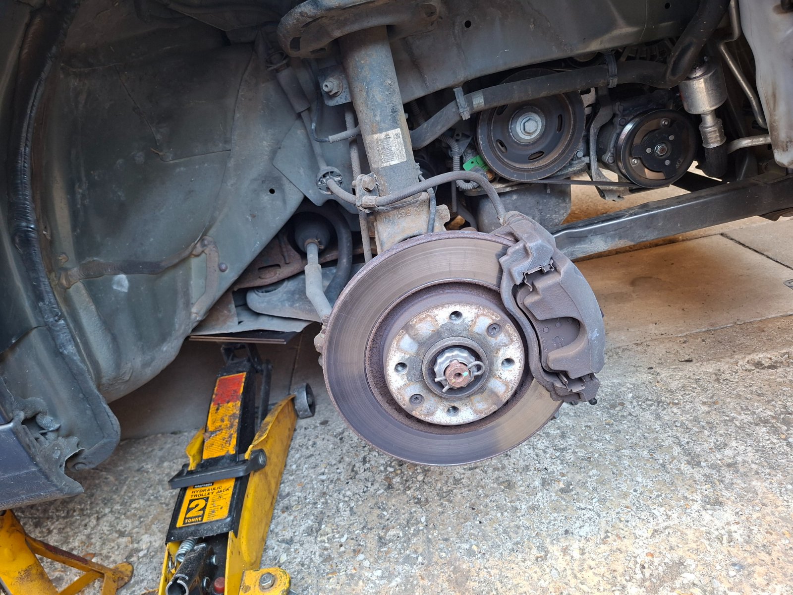

Yesterday the old van got a bit of TLC. I planned to replace the front discs and pads but when I looked they really were not that bad despite being a little juddery upon heavy braking. The pads have years of life in them so given my driving style and how much I use the van. I'll do them another time. When I need to, it's a clearly very straightforward job.

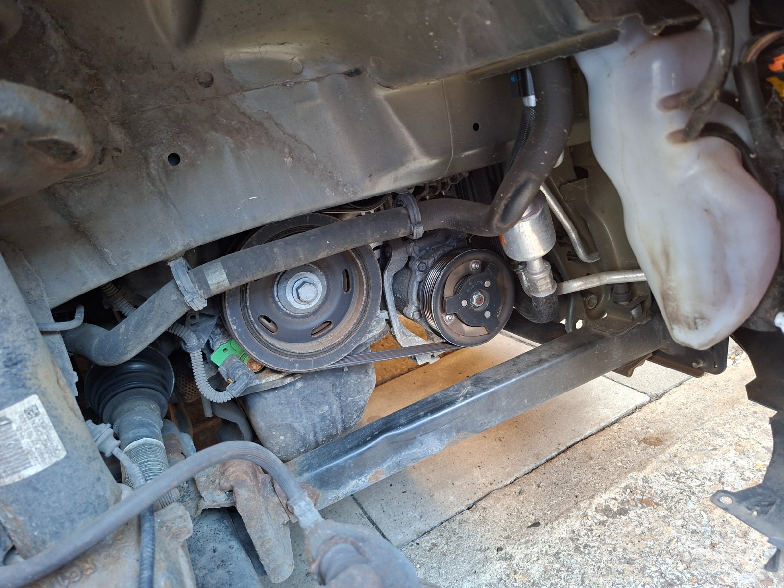

Keen eyes will note in the above photos that the mudshield has been removed. This was for me to learn how to do it and give me a view into the area I'll need to access to replace the cambelt and water pump.
In removing the mudshield, a big lump of sound-deadening material fell out
I couldn't work out from where at first until I realised the shield has a piece of it on both sides - fore and aft. Here's the fore nicely in place:

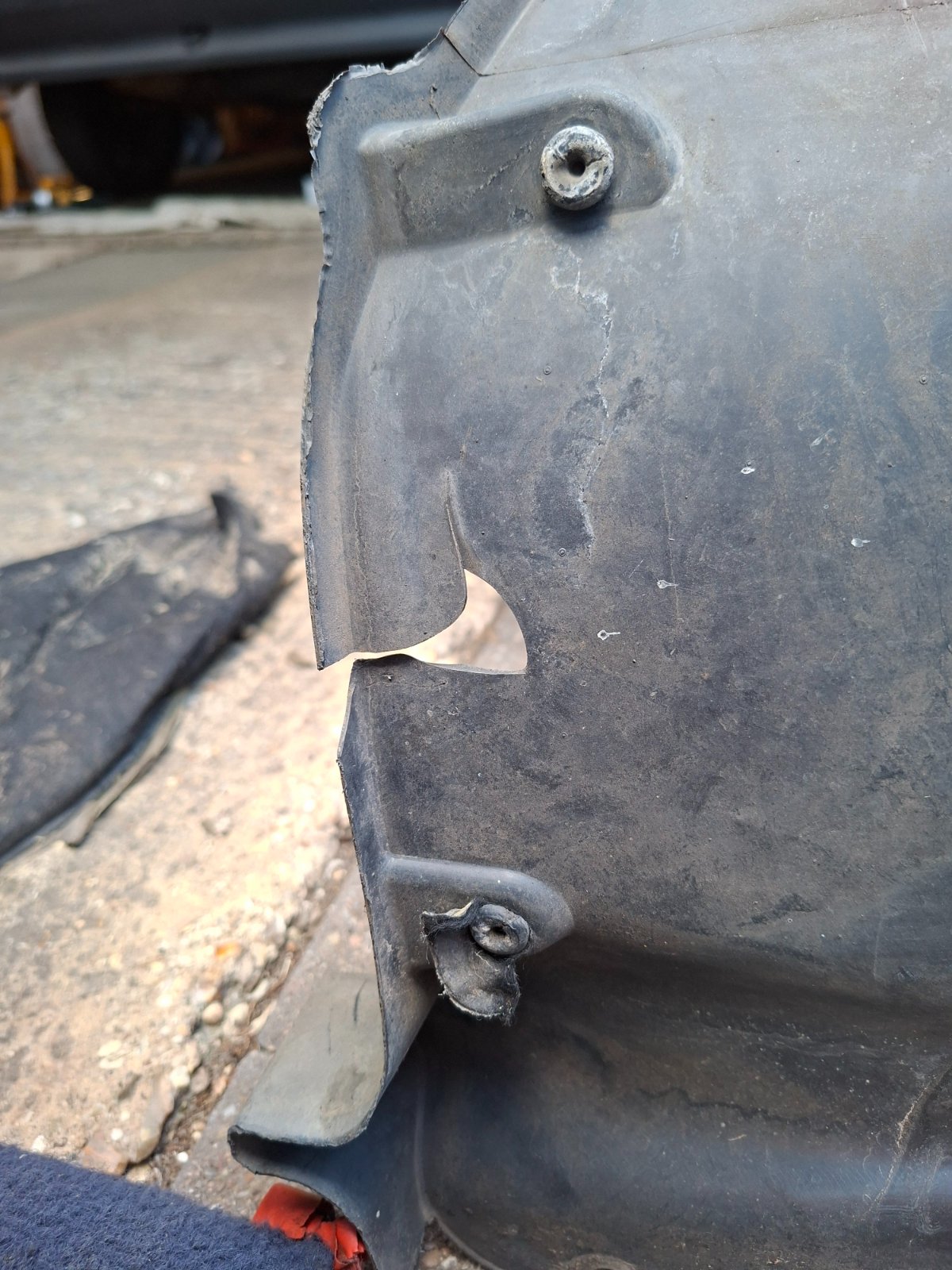

I could see why the aft fell off: there's a big crack and hole in the base of the mudshield right by the pad fixings...
I guess a big stone flicked up and smashed it at some point...
I can't imagine these pads do much so I'm not going to worry about replacing it.
I was surprised at how much muck and rubbish fell out along with the pad when I pulled the mudshield down...

That crack/hole in the mudshield is a classic for repair with the hot staple gun and a piece of suitable plastic for a patch. Ice cream tub lids work well!!

Cambelt will be a piece of cake for you with small hands, Jim! You might need some more heft to get the crank bolt out - but they are not that tight. Supposed to be replaced - decent kits come with a new bolt. No real gotchas on these, unlike the 2.0 HDi with the hidden, different sized, bolt down the back!! It's a bit tricky to rotate the crank and wiggle the locking pin (for holding the crank for bolt undoing / tightening only) in over the exhaust single handedly... I've never managed to get the belt back on over the tensioner, but it's easy enough to fit the belt first, then bolt on the tensioner afterwards.

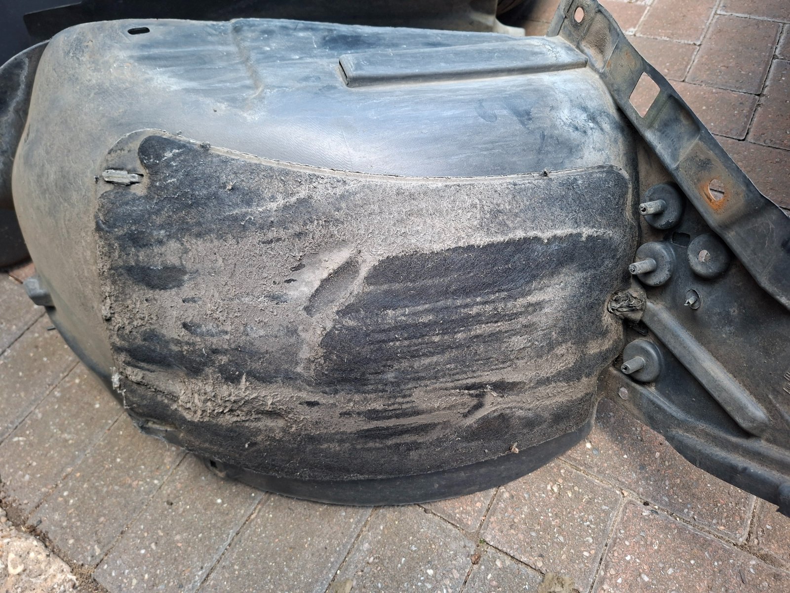

I hot stapled the blue 308 SW front mud shields, they unfortunately didn't fail where I fixed them but fresh locations instead!mickthemaverick wrote: 26 Aug 2026, 10:58 That crack/hole in the mudshield is a classic for repair with the hot staple gun and a piece of suitable plastic for a patch. Ice cream tub lids work well!!![]()
This was hot staple then reinforced with a "bead" of hot glue gun over the top to spread the load a bit.
Arch liner very brittle. They are by far the flimsiest arch liners I've come across, without doubt I'd say the 406 Coupe's plastic liners are much better condition despite being more than twice the age!
Bought a new aftermarket liner (Autodoc, about £25?) very thin but at least flexible and thin, rather then brittle and thin!
Had filthy (and unclear if ever did anything meaningful!) "sound deadening" pads on the back just like yours Jim. New one didn't have anything at all.

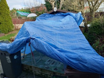

On my first C5 I had them splitting and no hot staples back then. I actually 'Wallpapered' the inside of the liners with good old blue tarpaulin and spray on upholstery glue, Copydex I believe I used. Repaired and reinforced at the same time!
