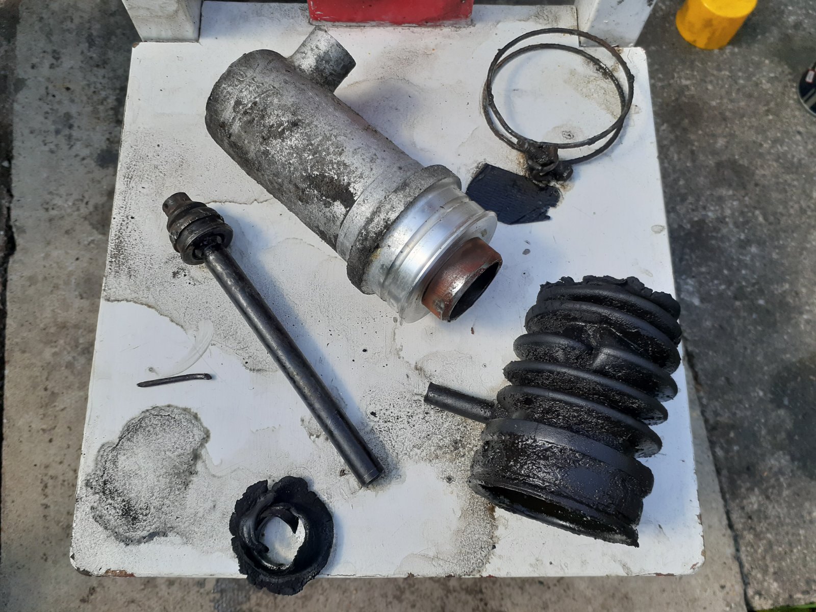

Here is a photograph of what victory looks like!
I dunno what all the fuss was about in the end, just apply a healthy dose of the legend's own "Percywhatsit"
(and lots of "heat, beat and repeat" probably helped, along with the air hammer!) and she's apart so I can now finally repair what was a self-inflicted leak after way too long. (original issue here was I forgot to loosen a sphere before depressurising a couple of years back, and I managed to twist the cylinder enough to break the leak back nipple off the gaiter
Now should be plain sailing to sort the rest of the fixes prior to MoT. oops, did I just say that out loud?
better not have jinxed the show now!

Rear suspension back together and no leaks so far, can't really test with a full Citerobics workout 'til I've done the welding that's on the same corner. (I did find I'd got a bit "excited" with the blowtorch & melted the ends of the leakback lines, but nothing a quick splice couldn't sort).
Got the tinworm chopped out & ready to make patches now, just a 9x6" section of outer sill and a little 2x2" square on the bottom of the inner sill, will just have to be more mindful of where the heat's going as it's close enough to the fuel filler neck. Then onto smaller jobs, rack gaiter/drop links, coolant pipe and interior cleanup. Can't wait to be "back in Black"

Oooh isn't this interesting. I had a memory of the driver's side rack gaiter being the "bugger" of the two & was looking forward to a nice easy (relatively, for a Xantia!) replacement.
Sadly this ain't the case, so took rather longer than anticipated to do. Still, PAS cylinder aside, it went easier than I recall the driver's side doing. Did manage to murder another of the rubber plastic Y's behind the subframe in the process of wrestling the new gaiter onto the rack body so that's a pain. We now have 2 "repaired" ones on the car. Hopefully enough to last until I can source replacements but not super happy with them.
Fingers crossed for the morrow. At least the weather held out till I could finish, it's not looking great the next couple of days to say the least!
