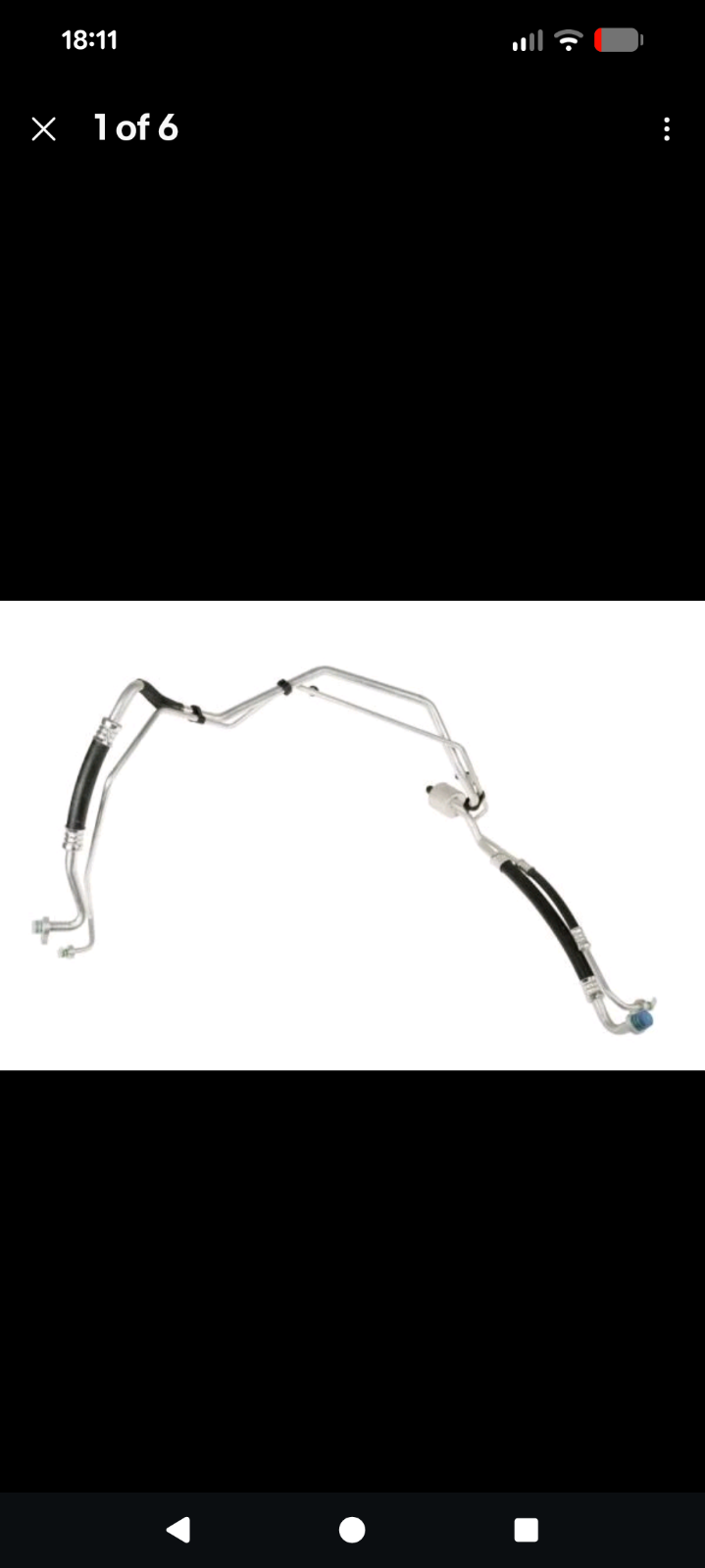

Hi all
My AC system has a leak where one of the pipes was rubbing against the compressor ,its one of the two pipes that go all the way to the bulkhead.
Partssouq catalogue said i need part number 6477F4 see photo attached
When i go to autodocs and other websites to shop for parts they say the above part number isn't compatible with my vehicle ,they advised the right part is 6477D2.
Any advice regarding the correct part number? thanks

6477G6 is another hose listed for 2.0 5008

windy1603 wrote: 18 Aug 2026, 19:00 6477G6 is another hose listed for 2.0 5008
Did you find the part from official Peugeot parts catalogue?
Google says 6477g6 is matching 6477d2
Thanks

For some reason my offline ServiceBox does list the 5008 (with some blanks in some parts lists) but did show the two numbers 6477F4 and 6477G6 depending on engine type

windy1603 wrote: 19 Aug 2026, 07:35 For some reason my offline ServiceBox does list the 5008 (with some blanks in some parts lists) but did show the two numbers 6477F4 and 6477G6 depending on engine type
Same partssouq is showing two part numbers ,I found a sticker with original PN on it and its matched to 6477G6.
Got some second hand pipes hopefully wont be too bad to fit although looks very little space around bulkhead area ,just have to work by feel

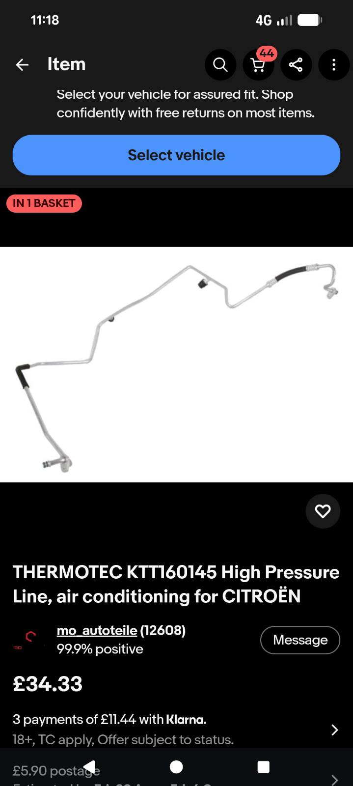

I have seen on ebay that I can buy a single pipe ,the thin one alone for about 40 quid new aftermarket.
The two lines are joined together permanently by plastic clips and dont seem like they can be separated without cutting the plastic?
Is this the only way to replace a single pipe and not buy the whole two lines?
