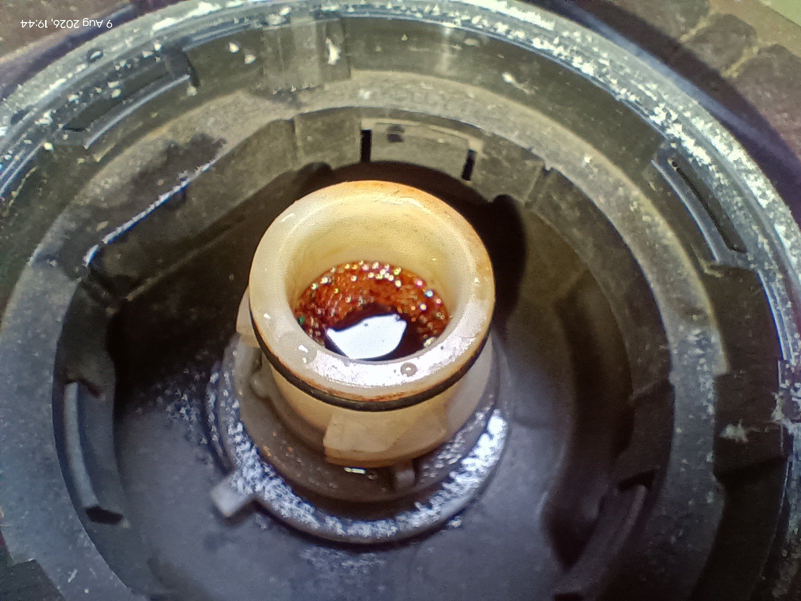

Though speaking of odd colours!! Ice topped the tank up with additive then fresh Adblue (pretty much colourless) this is a surprise:
A VERY red tinge to the tank contents!?!?!

White piece of paper dipped into the adblue tank contents:
Red
Red
Very red!
Real sinking feeling that I know what is this colour
Spoiler: show
eolys / "PAT fluid" i.e. goes in the DPF additive tank, not the Adblue tank!
Wynn's treatment+ Adblue are the only products that have been in a long spout funnel I bought specifically for that task.
This deposit/ megs crystal goes not fill me with confidence in the Wynns stuff!
