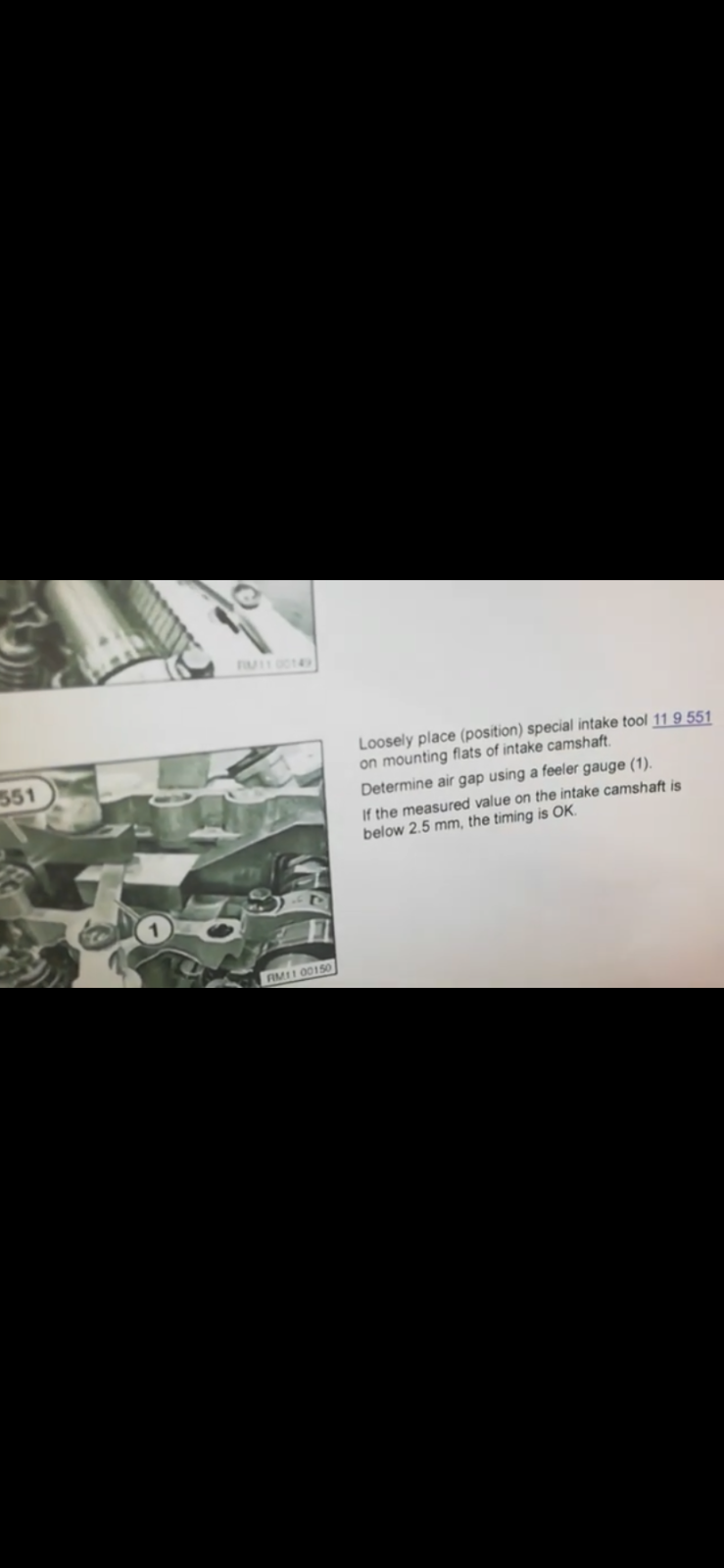

Changed timing chain on ep6 engine. There is a tolerance gap up to 2.5mm between the intake and exhaust locking tools on the instructions. Should the intake tool be bolted down or not? as this makes a big difference to the gap

The instruction says 'loosely place...' so I would say not bolted. :)
