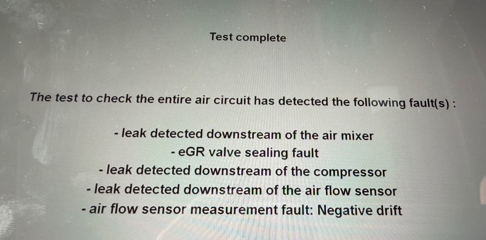

Got problem with locating air leak. Diagbox air intake flow test ( ECU->actuators-Air intake....) confirms leak with list of issues as on attached image.

Intercooler was changed 4kkm ago and have 0 signs of damage. Airmixer still clean and no unwanted movement. Sealing of air mixer is tight too. EGR was replaced and also no signs of mulfunction. I'm focusing on plastic pipe going from turbo to IC (starts at the back of engine and goes below it), although I can't get mu head around how can it be: leek serious enough so Diagbox can trace it on stationary vehicle (practically 0 boost from turbo even at 3000-3500 rpm during test) but still untraceable by smoke test.
