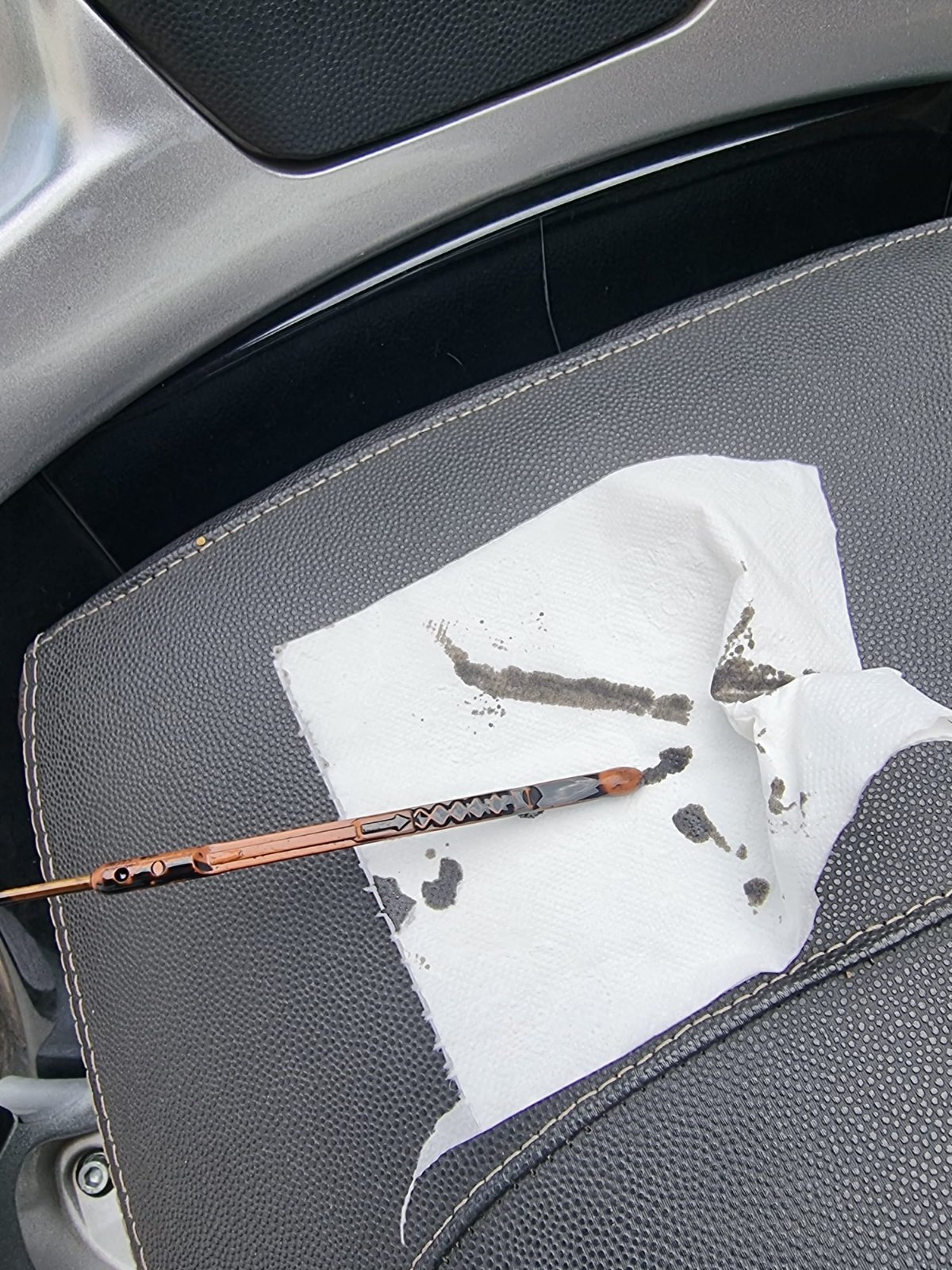

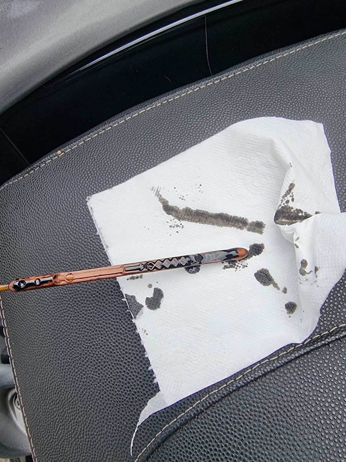

Is it possible that a too high oil level could cause the faults and the DPF issues - we never had an issue with the car before a garage in Czech republic changed the oil 2 years ago - I had a look at the oil level using the dipstick today - when the car was cold and it is slightly above maximum level (no "MAX" stamped on dipstick just a XXXXX hatched area). Having written that we had just owned the car for 2 years and driven it for maybe 4000kms up to that point . Will take a picture tomorow of the dipstick and post it up.shtu wrote: 25 Jul 2026, 20:44 F40A - you can ignore that, it's essentially a bug in the software. The car takes a while to decide on a level reading, and if it's switched off before it decides, it logs a fault. Very French of it.
Is the air temperature on the dashboard accurate? If it is, it's unlikely you need to replace the mirror or sensor.

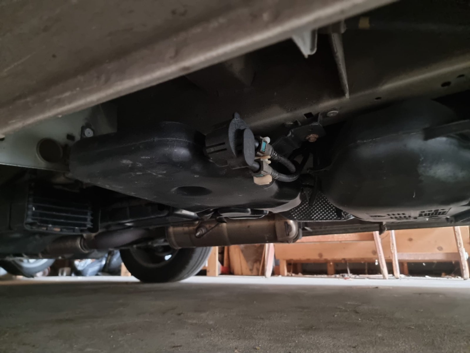

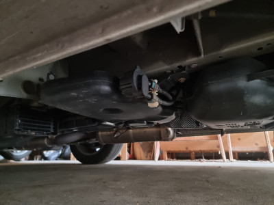

Here comes dipstick pictures as well as a picture of the EOLYs tanks (which just like in shtu's tale of woe has an integrated pump).
Looking first at the dipstick measurements to me it looks a good bit over the last XXX hatching marking. I realise from the label the mechanic put on the car post service that the mileage on the car when this was done was 128400 and so we had driven it 6tkms and not 4tkms without any warnings or faults whatsoever - so now Im half convinced that I should change the oil myself and do it properly (car has only done 4500 kms since then) to eliminate another possible source of fault.
On the other picture - that of the EOLYS tank - which hose to disconnect - top or bottom - before conducting the pump test ?
Thanks again all!

So... I ran the additive pump test with just the top hose in the picture off ... I could hear noises like the pump impeller turning but nothing came out...I tried both hoses off and reran - also nothing came out. I also removed 200ml of oil from the tank and the level is now at two thirds of the hatched dipstick marking.
I will order a new tank now and see how that goes - will also search threads here on how to replace the additive tank on a C8 or Peugeot 807 but if you guys have any immediate tips then Id love to hear em. The defective tank is completely full.
EDIT: I just watched a video and it said the top hose is the fill hose with the bottom being the return hose so I guess that means I need to drop the tank down and collect from another hose exit point to test the pump??
DOUBLE EDIT: In researching the additive tank I now realise that the test should self terminate after a couple of minutes - of course I only let it run for maybe 20 seconds max so I guess i need to rerun that. However the hose thing still haunts me - I suspect I needed a different hose - maybe I should drop down the tank.

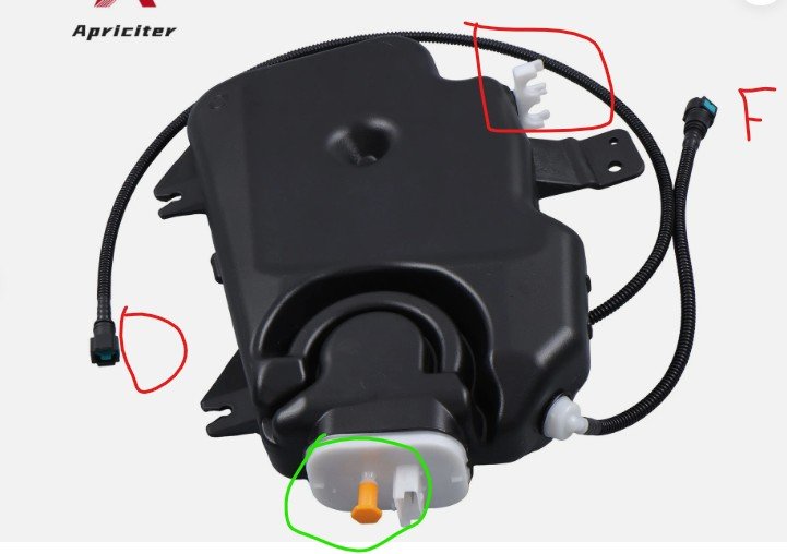

As usual I think I have had to do things the hard way. Attached is a picture of a brand new tank.
I believe what I have marked :
red F is the fill hose
red O is the overflow hose - picture shows it upside down as it comes out of the top of the tank
Green circle at the bottom is the electrical connector supplying power to the pump and the orange fella is where the delivery hose connects.
If I'm correct I need to disconnect that delivery hose - even better if I could do at the other end (which I presume goes into the diesel tank) to perform the additive flow test. Of course to do this I probably need to drop the tank down to get access to where the orange fella is.
Can someone please confirm ?? Thanks .

Re: DPF issues 2012 C8 2.0 HDI
Don't waste time dropping the fuel tank, there's no need.
To check the pipe to the tank isn't blocked, blow through it. I would not do that with your mouth anywhere near the pipes, that stuff is toxic. It's a use for that chinese knockoff mityvac I keep mentioning.
If there was nothing at all coming out of the pump outlet, sounds knackered. It doesn't shift huge volumes, but there should be a noticeable amount - I used a small container to catch the fluid from the test.
Changing the EOLYS tank should be obvious, just look at it. Transferring the fluid is very easy if you have the pipe from a refill kit, only slightly harder if you don't.
1 - Yes, it's the outlet on the tank itself, right next to the electrical connector. Covered by an orange cap in your photo of a new one.parnell wrote: 26 Jul 2026, 17:26 Mate please take a look at the picture I posted above - I think I checked the wrong two hoses - the fill and the overflow. I think I should have checked whether EOLYS fluid came out of the orange stopped bit - marked with the green circle ? Is this what you refer to as the "pump outlet" ? If you confirm this understanding to be correct I will check this tomorow and either way its I will know where I stand. I still have the pipe from the refill kit but a new tank is like 250 euro - which if that gets me out of trouble Im happy enough to pay.
The "pipe to the tank" you mention in your post - I think you refer to the pipe between the orange fellow (again marked with green circle) and the diesel tank - where the additive should be delivered to ? I was thinking I could take one of my sons steel replacement brake cables and pass it through feeling for any blockages. Please again correct me if Im wrong and thanks again - your posts have helped me a lot already.
2 - It's fairly unlikely that the EOLYS pipe to the tank is blocked. Don't risk damaging it by shoving cable through it.
If you do want to test it (or any of the other pipework), a chinese knockoff mityvac is the thing to use, eg, https://www.ebay.co.uk/itm/155499204330
3 - Don't panic, don't overthink it. The DPF and EOLYS systems are actually quite simple once you spend some time working them out.
You have a new pressure sensor, fit it. Check the difference at idle and 3000rpm static.
If those numbers prove the DPF is clogged, take it off and clean it.
Check the EOLYS tank is putting out fluid. If it's not, replace it.
When you're done, tell the car it's had new a new DPF, and the tank refilled.
Brilliant! checked that this morning - delievered EOLYS without hesitation - steady drip as soon as the impeller started - funnily enough the test finished quickly itself and the liquid stopped so thats A-ok.shtu wrote: 27 Jul 2026, 00:35 1 - Yes, it's the outlet on the tank itself, right next to the electrical connector. Covered by an orange cap in your photo of a new one.
I have a 100ml syringe which I used to remove the 200mls of excess oil - if I pushed 100ml of air through that do you think that would be a reasonable test?shtu wrote: 27 Jul 2026, 00:35 2 - It's fairly unlikely that the EOLYS pipe to the tank is blocked. Don't risk damaging it by shoving cable through it.

Good thinking, try that. You might need to bodge up some sort of seal between the syringe and fitting, but that would work.parnell wrote: 27 Jul 2026, 10:29 I have a 100ml syringe which I used to remove the 200mls of excess oil - if I pushed 100ml of air through that do you think that would be a reasonable test?
When all is done, you will then need to prime the line (as it's now full of air instead of fluid), there's a parts replacement process in diagbox that covers it. (tank and pipes iirc)
