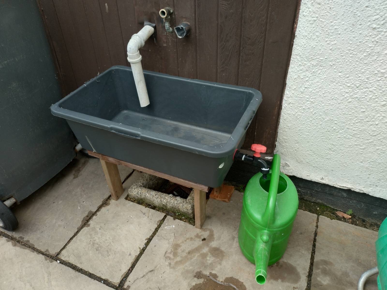

You may remember my temporary leak solution for the garage roof as described here. Having had the roof replaced the system become redundant so I took it all out and popped the tank into the greenhouse pending a future use.
Well today I had an idea for that tank which makes me happy that it is not going to waste (No pun intended, read on!). I am terrible for going into the kitchen, having a drink of water and then rinsing the cup and pouring the rinse water down the sink. It occurred to me that I could install the tank outside in the kitchen waste pipe zone and capture that water to be used on the garden or anywhere else where 'light grey' water is acceptable.

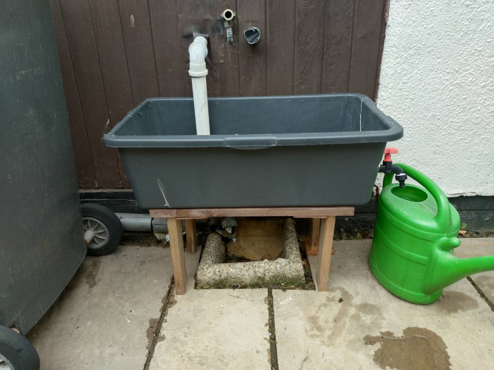

So I cobbled together a stand from another part of the leak system frame and set the tank on it with the watering can to define the height:

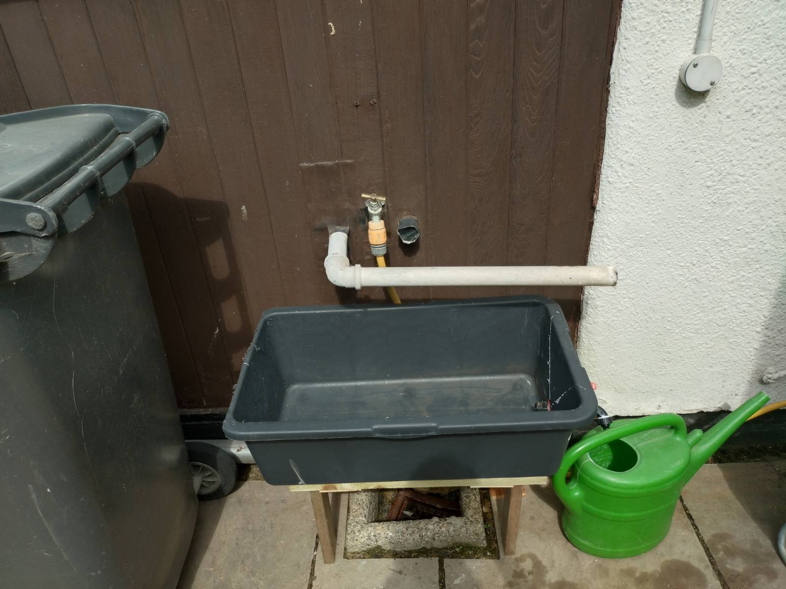

Clearly the waste pipe needed modifying to run into the tank:
Then adjustment of the outlet tap to fit nicely above the watering can:

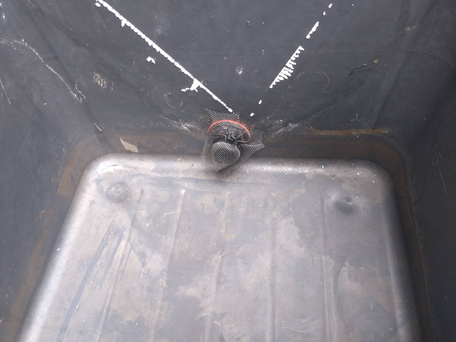

Although we are very careful about not allowing any solids down the sink it did occur to me that there may be the odd bit so I fitted a very fine gauze filter over the outlet to the watering can:

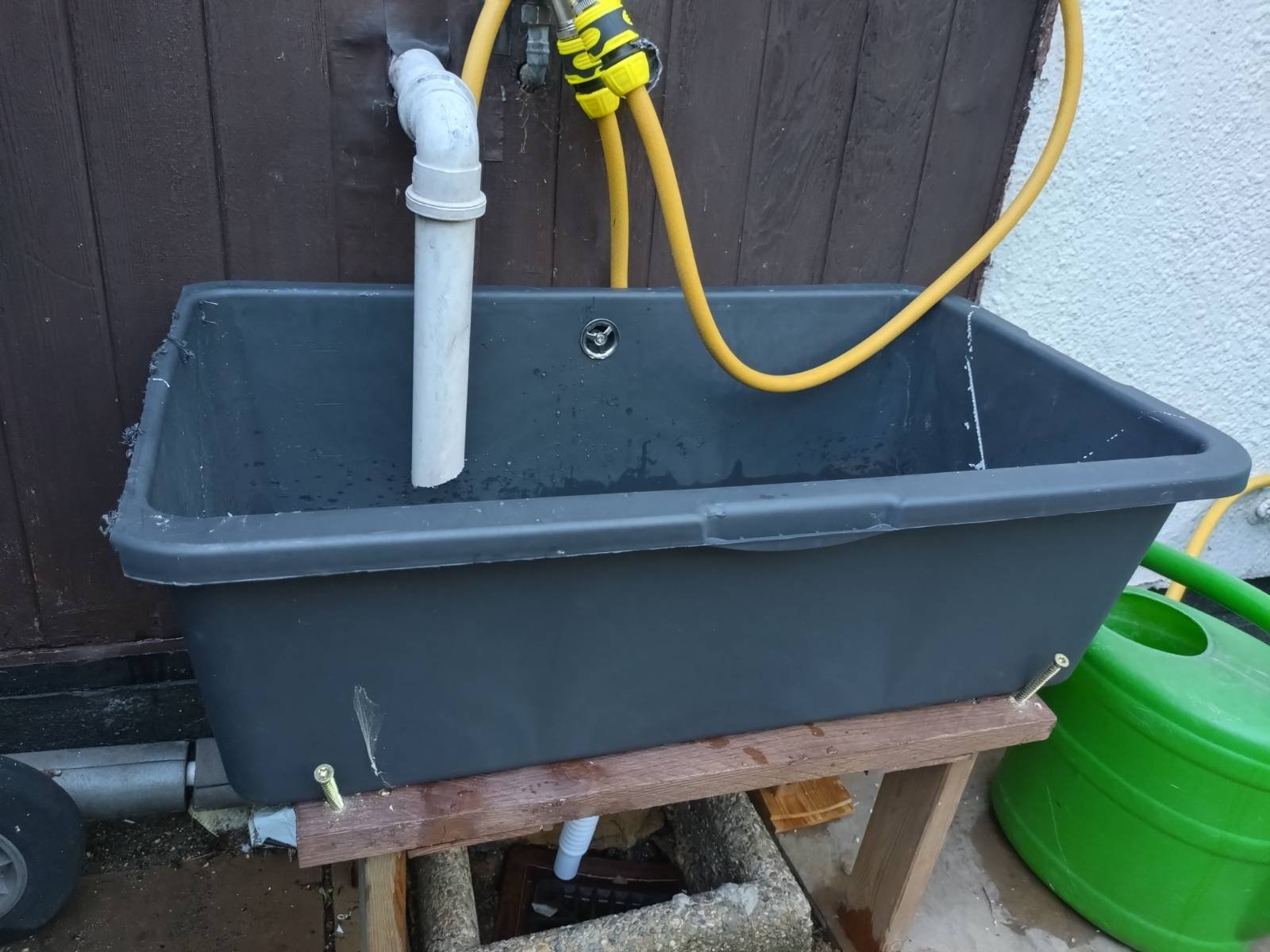

All that remains is for me to install a standard sink overflow into the back of the tank and running down to the drain to ensure that if the tank does get full it will overflow back to the waste water's original destination. As I type I am waiting for that overflow kit to be delivered from Amazon but I'll post a final picture once it is installed and up and running.
It doesn't mean we'll be saving a huge amount but every little helps these days!!

Overflow installed and the system is in use!!
