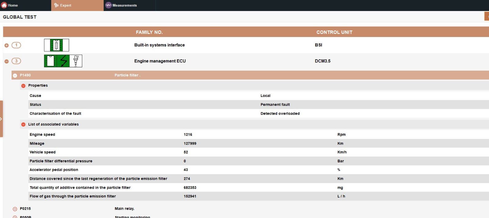

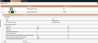

So i finally managed to get a diagbox working on the car and I think its the pressure sensor that is causing the P1490 and P1447 codes to come up - note the differential pressure sensor is reading ZERO despite the car running at 1216 RPM at 52 kmh...
Would be very interested to hear from other members what they thought though. thankyou!!

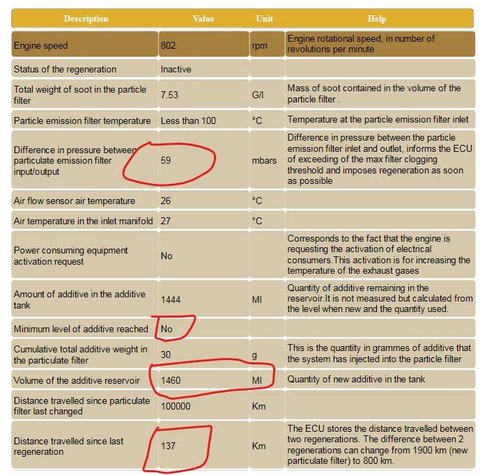

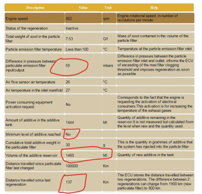

Next clue... I managed to get diagbox into live measurement mode (just ordered the nexas OBD device to make this easier going forwards) and here is what turned up.
Im confused -
1) the pressure sensor seems to work fine but yet when it threw a warning pressure differential was zero
2) I filled the EOLYS tank and reset the tank in the ECU and yet the measurements today indicate minimum additive level has NOT been reached AND 1444 Ml of additive remains in the tank (out of 1460 Ml) which is just mad - I put in 3L which is what Marc (and I believe him) told me is the capacity only two years and 5 thousand kms ago.
All assistance most thankfully received.
Im confused -

You've jumped on the back of someone else's thread, do you want me to split it out?
Roll back a bit, what issue are you trying to trouble shoot on what car?
Minimum additive level means low level, i.e. reached when the additive is nearly exhausted. There is no level measurement, it is only estimated - it looks like although the tank may have taken 3 litres, the factory programmed level was only 1460 ml, and when you perform the 'refill' procedure it just records this as the volume in the tank. This has dropped to 1444 ml, so used 16ml, which is probably not that far off for 5k km. There might be an option in Diagbox configuration to change it to the amount you put in.
I would caution against doing forced regens, this can melt the DPF if there is lots of soot present.

The (reasonably persistent) error codes that I get are P1447 and P1490 - I thought it was a pressure sensor failure as reading zero pressure is just nuts. Now after reading more on the board I am more inclined to take out the whole DPF - although on the C8 its a long welded together contraption (at least its just horizontal under the car) so Im not sure how to use a pressure washer on it directly after I let it steep in some DPF cleaning overnight. Thanks for any support.

Ideally you need to watch the dpf readings when driving to see what the pressure is doing. It could be a blocked pipe or a duff sensor. What is the diff pressure reading at idle and 3k rpm stationary?

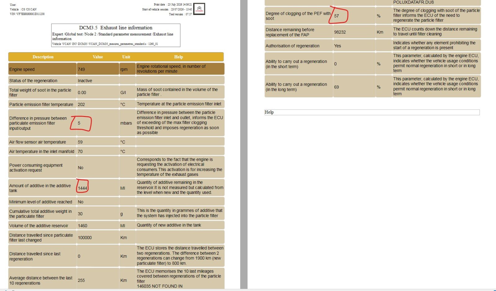

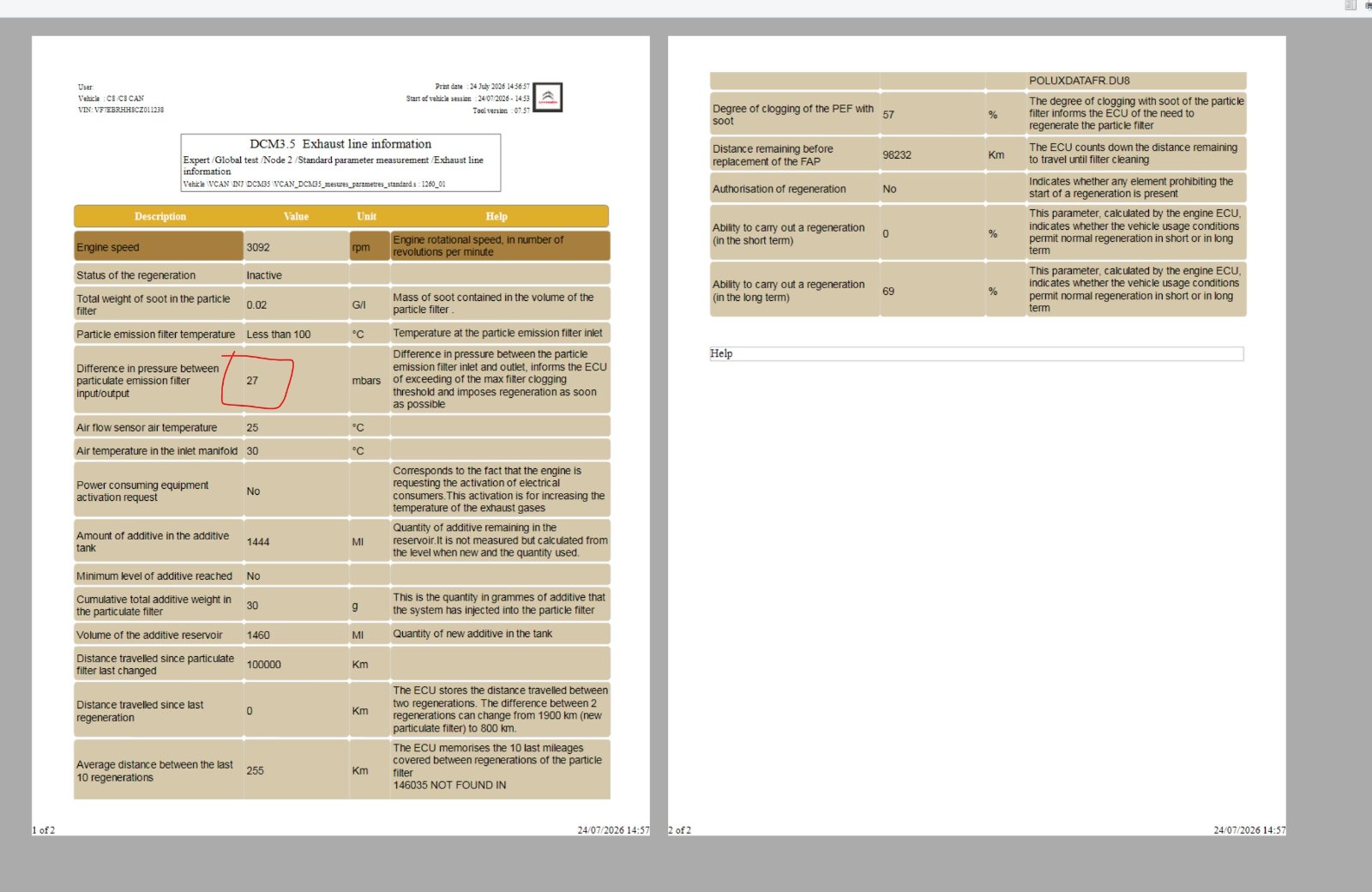

You can use a chinese knockoff mityvac to test the differential sensor, or just suck and blow. The problem might be blocked, damaged, or missing pipework, though the sensors do fail. I had one that read 5mb difference with the engine off.
Forced regens = bad idea. They may burn off soot, but they don't burn off the ash and cerine left behind in the dpf, the only way to get rid of that is to wash it out.
As for pressure washer vs hose, I tried both, and found the hose more effective, with hindsight I would have also used an airline to add pressure to the water in a similar way to the commercial cleaning machines, but it's not essential, I managed fine with just water. Remember that you only need to wash it in one direction - back towards the engine.
I've been through all this palaver myself, so if you hunt in my older posts you'll find more detail.

Ok so Im back with some more readings today... thanks a lot to shtu and Mick for adding in their two cents. I will get to each in turn... here comes the readings at approximately 3.1k revs - so thats 27mbars whereas at idle the pressure is 0 mbars.
I tried to clear the codes using the diagbox but it said "clearing codes failed" without giving further reason.

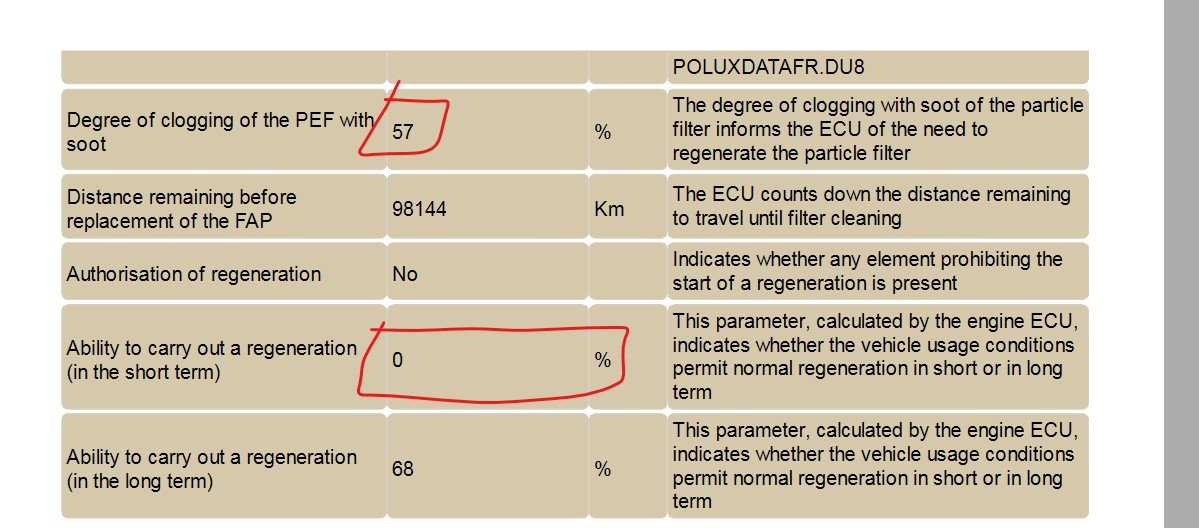

I didnt want to do the forced regen in all honesty - I just couldnt clear the codes and despite spending two hours driving yesterday the car went into limp mode and apparently this was the reason I couldnt encourage it to start a regeration cycle.
