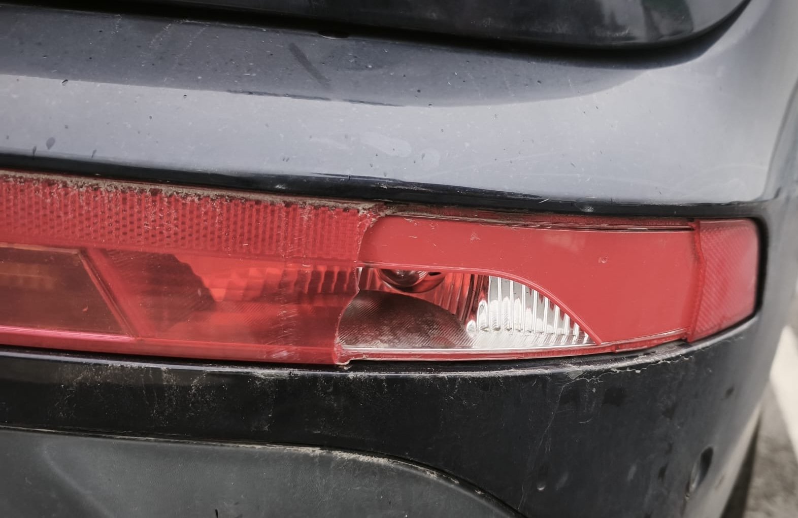

Do I need the entire assembly, no other way? Any idea how easy it is to install?

Rear reflector DS 7 Crossback
Parked in front of my house, found it like this...

Re: Rear reflector DS 7 Crossback
This breaker has a complete rear bumper for sale, it may be worth asking if he'll sell the reflector seperately!!
I have the puretech 225, this one says Diesel...mickthemaverick wrote: 16 Jul 2026, 19:19 This breaker has a complete rear bumper for sale, it may be worth asking if he'll sell the reflector seperately!!![]()
Looks as if you can just buy the light, as an example but not in the uk https://www.ebay.co.uk/itm/395410216416 ... gJTW_D_BwE
I bought it last week for around 188 euros from citroen spain directly and replaced it myself, extremely easy you only need a slightly long Torx 30 key. You can find it for much cheaper than 188 euros if you look for something second hand
