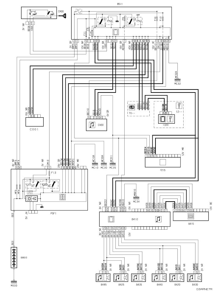

The radio receives permanent power from Fuse F8 in the BSI, which goes to pin D12 of the black 8pin connector on the back of the radio.
The radio receives switched power from Fuse F9 in the BSI, which goes to pin D15 of the black 8pin connector on the back of the radio.
Item 7215 is the central display. It has permanent power and is completely controlled from the CAN BUS.
Item 8415 is an optional CD stacker.
