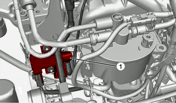

Hi Wolfgang
If this fault is present, then official guidance is to replace the turbocharger pressure regulation electrovalve (1).
I believe that is part: 1618X2.

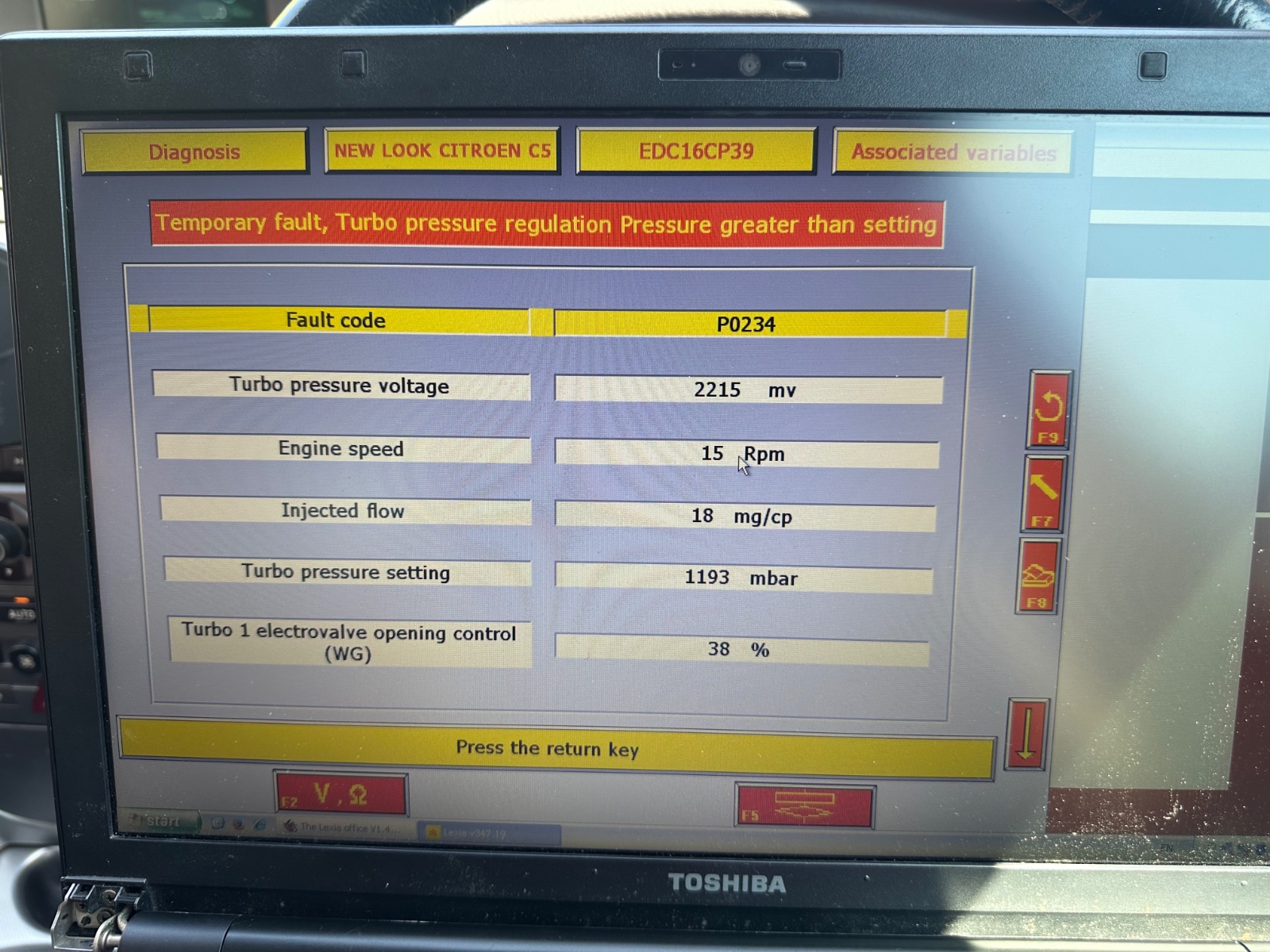

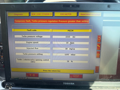

For the record this is the Lexia screenshot of the fault (see attachment)
