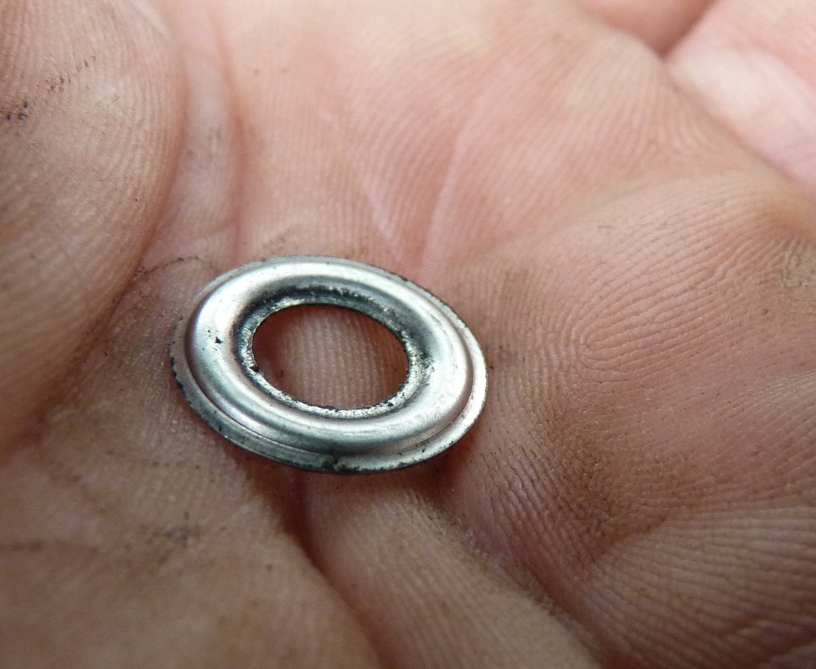

I wonder if the cylinder head have been changed. Are the injector correct for this cylinder head?
It was taken to MOT and didnt pass because number one injector had a leak (in between the body parts).
I took it out. In that cylinder the heat shield was positioned correct and was loose.
I took also out the rest of the injectors.

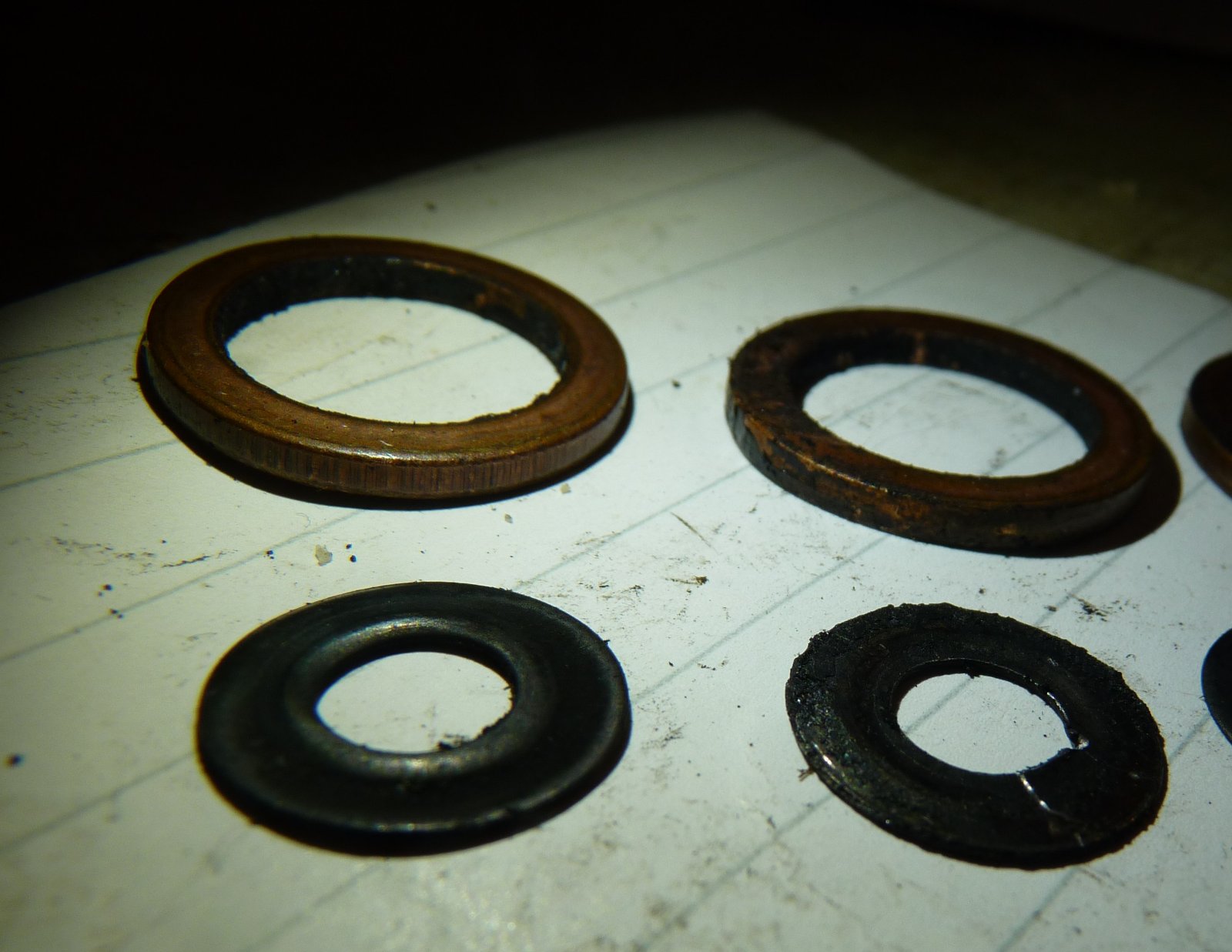

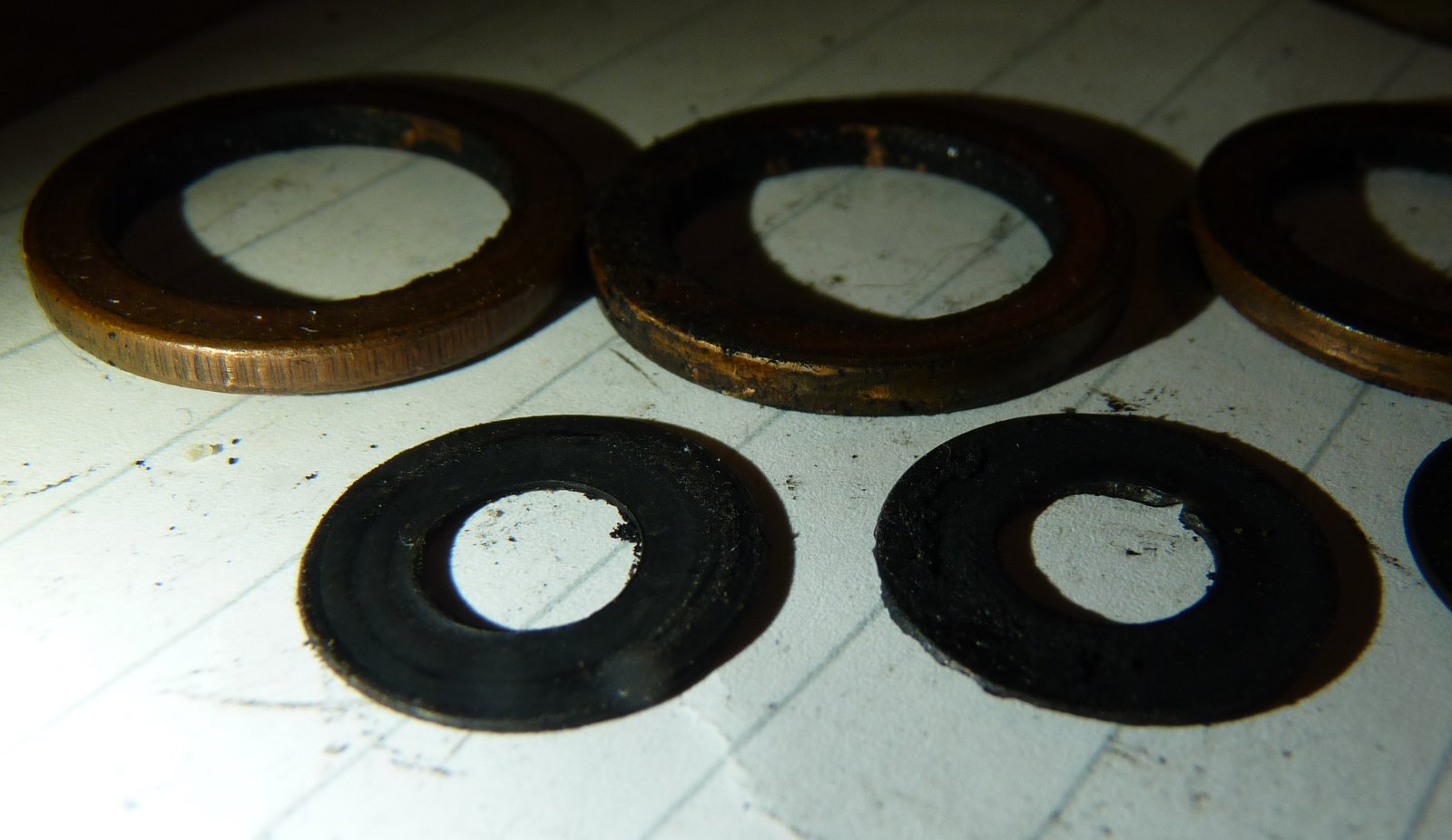

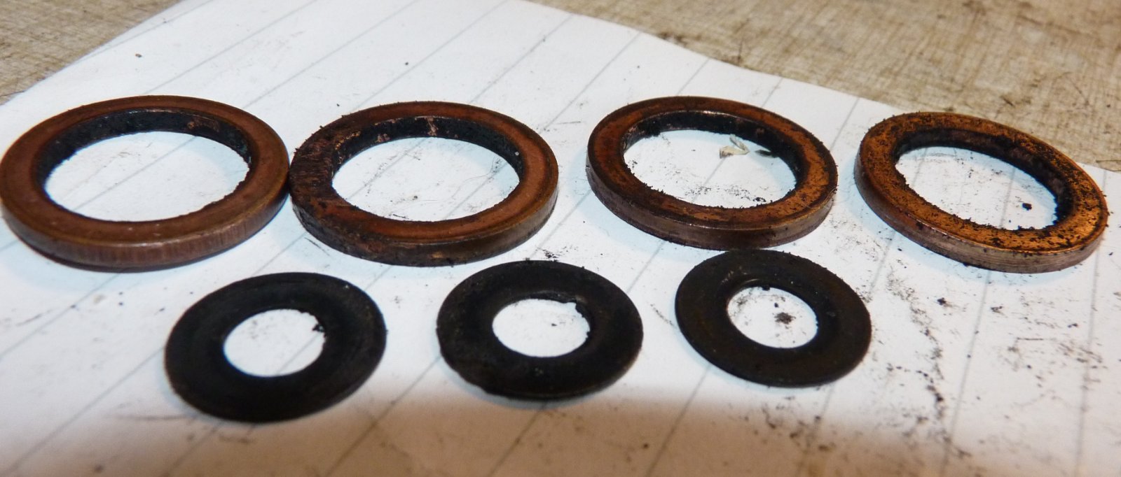

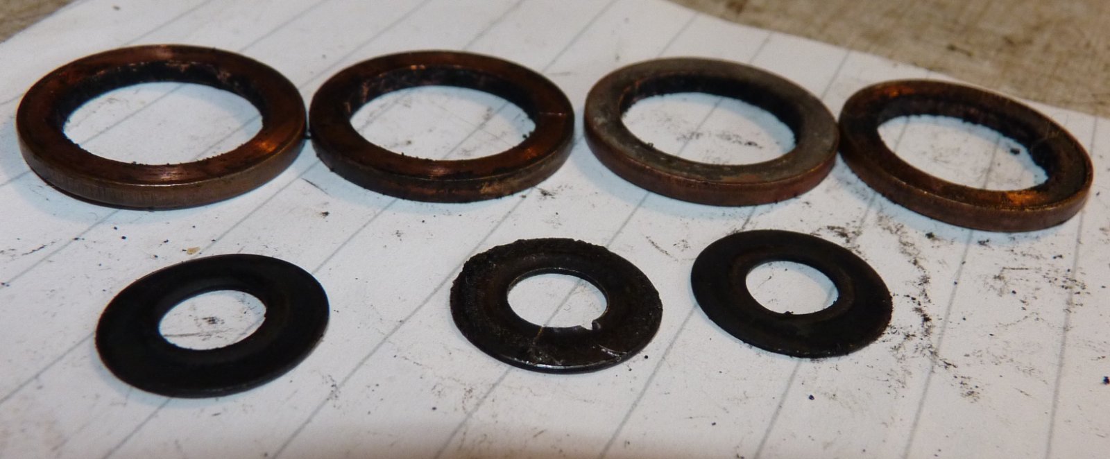

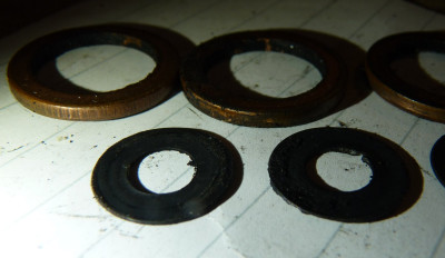

There was only two more heat shields and both was turned up side down. As far I could see.
All the heat shields are crushed flat!
I ordered new injector heads and gave them all to a friend to refurbish (clean, we dont have shims or other internals to change) and pressure test them. He said that the number one injector should not have leaked from inside.
Well, I put all back together with new copper washers and heat shields and the engine run even worse at idle. Sounded like air leak.
I wonder if the injectors are correct for this engine or did I do something wrong.

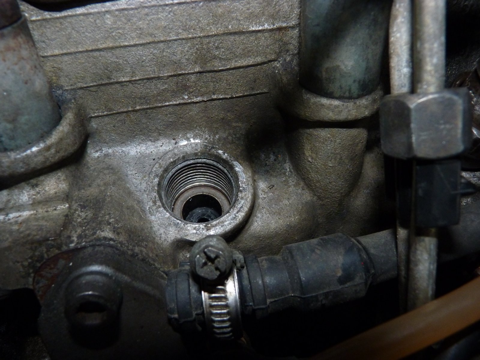

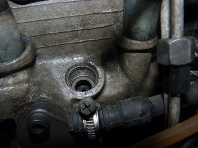

Second question is - what is the correct torque? I took out an other injector and the heat shield was totally crushed flat. Its like the injectors are too long for the cylinder head.
Tried to take pictures of the old heat shields. The one on the left is the number one.
One of the copper washers (I do think it came out of the cylinder that didnt have heat shield) have signs of compression loss.

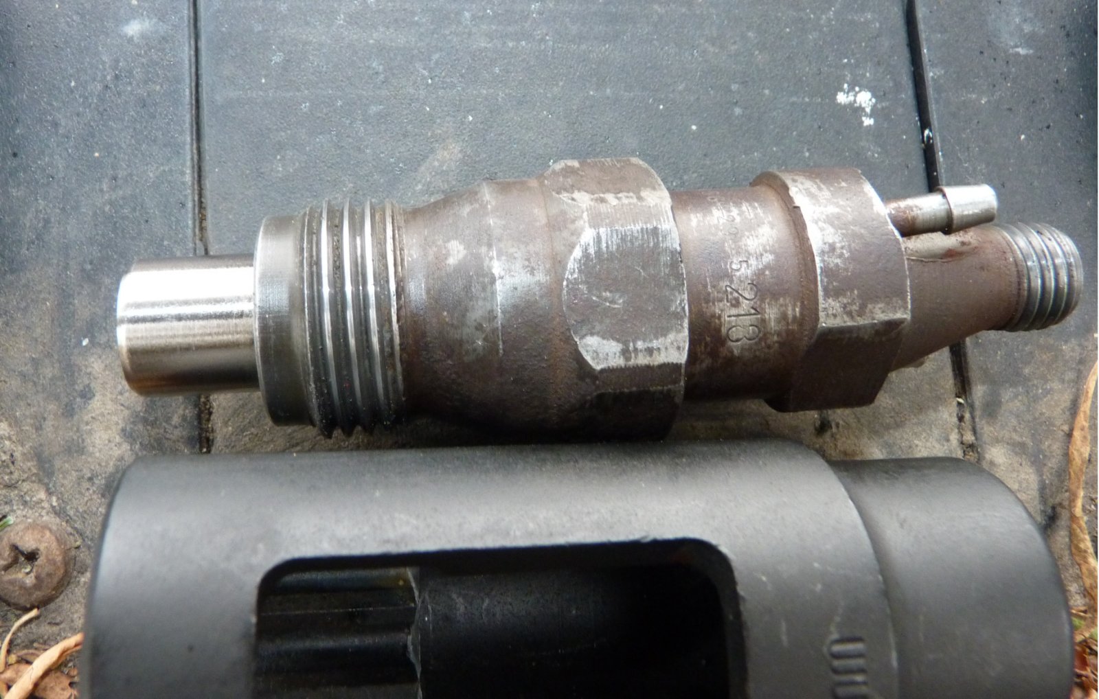

Does someone know what injector is correct for this cylinder head? The head has 7-8 threads. The injectors have 4.
I called Peugeot and they gave me this OEM number for the injector: 1980-H0 - but that number is almost impossible to find info on. What that injector actually looks like. There are several different types.
Also - what would be the correct tightening torque for the correct injectors? 40 -70 - 90 nm?

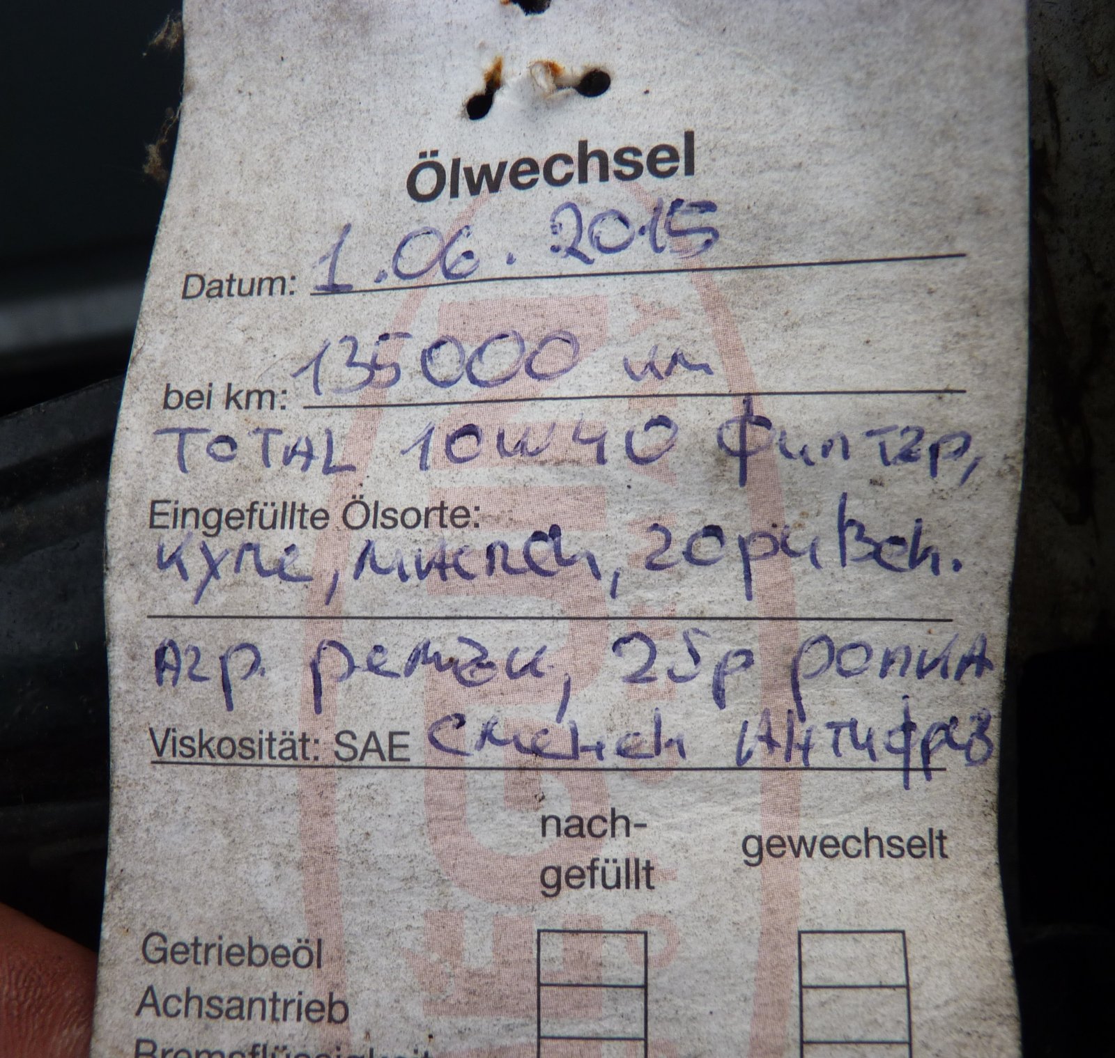

This is all the service history there is and most likely been done since 2015:

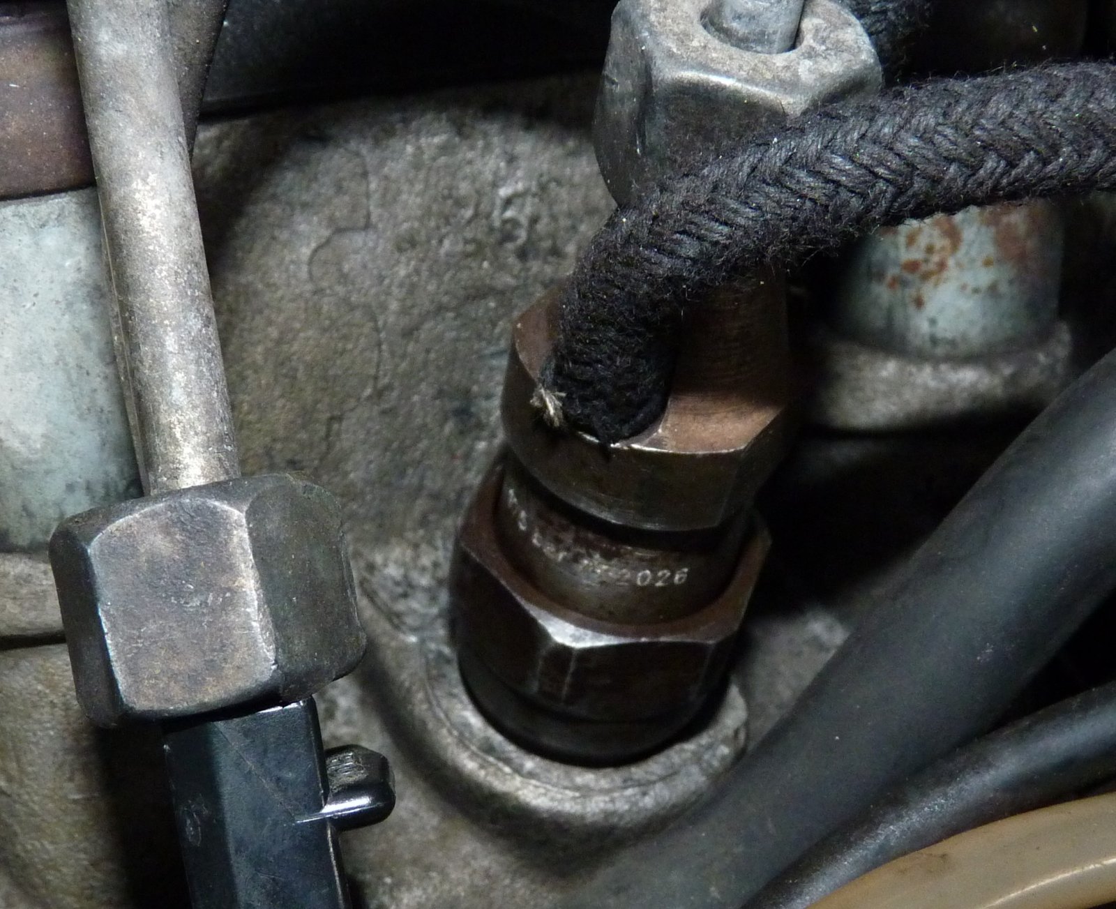

So it seems that this van has the earlier engine in it.
And that means the nozzles I ordered after talking to Peugeot - are wrong.
And the nozzles installed in the van "originally" (when it came here) were the same, wrong ones.
I have ordered yet an other set of four nozzles - and we will see.....
VIN number says this engine should have 3 of 1980-H0 (nozzle 1984-95) and one one with needle lift sensor 1980-G9
But instead engine has four: 1980-G6 (nozzle 1984-60)
