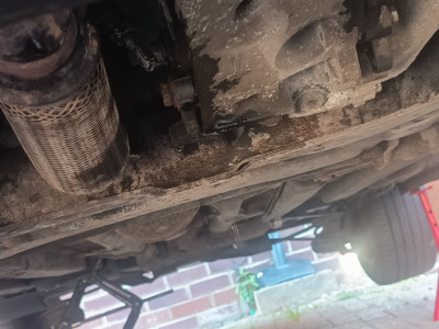

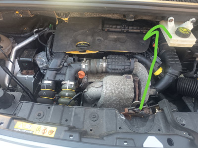

Peugeot 3008 1.6 active HDI 2016

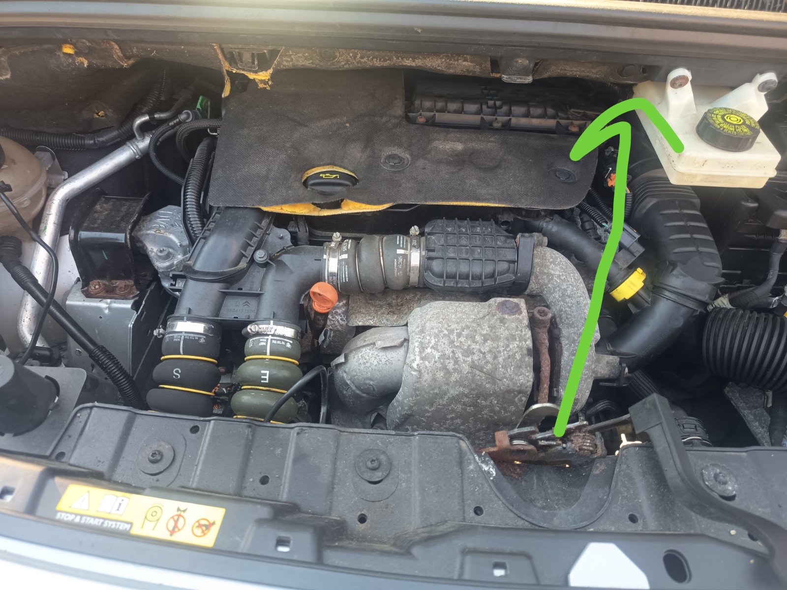

Water coolant leak at the back of the engine towards the right side (battery side)
Started small now having to top up every time I use the car

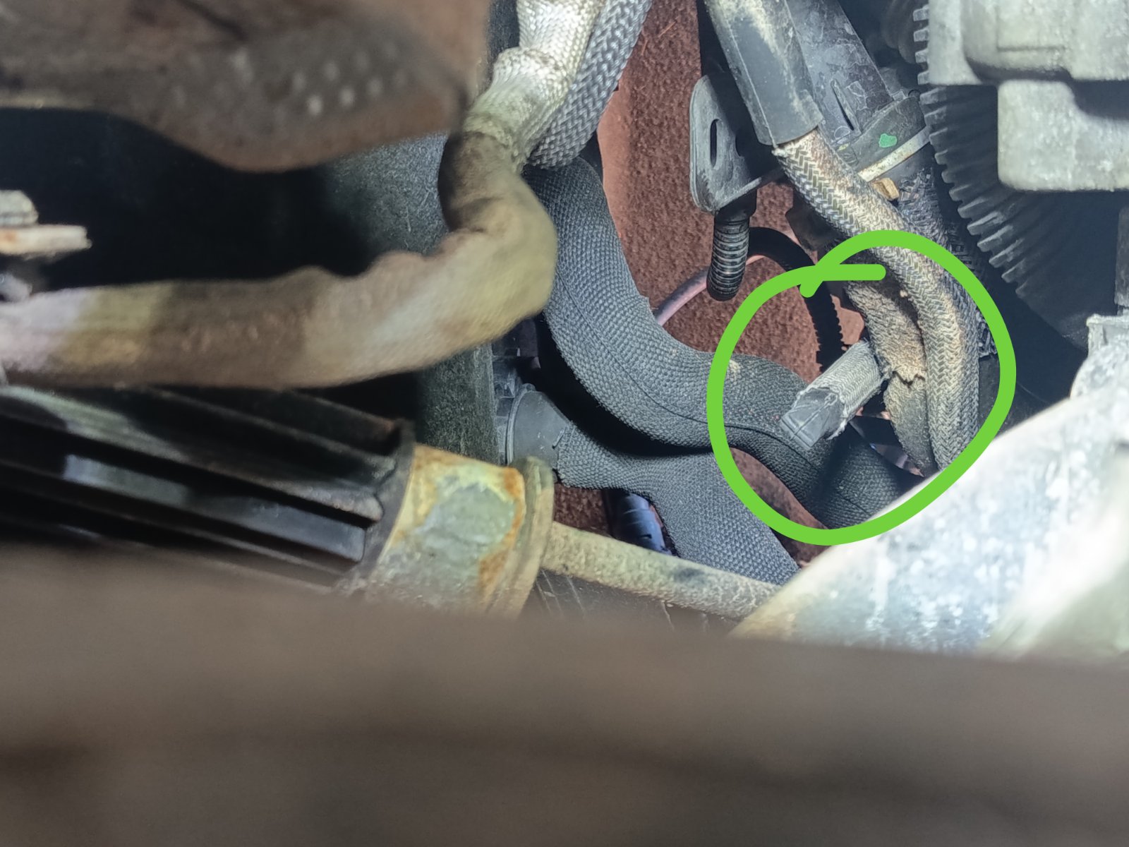

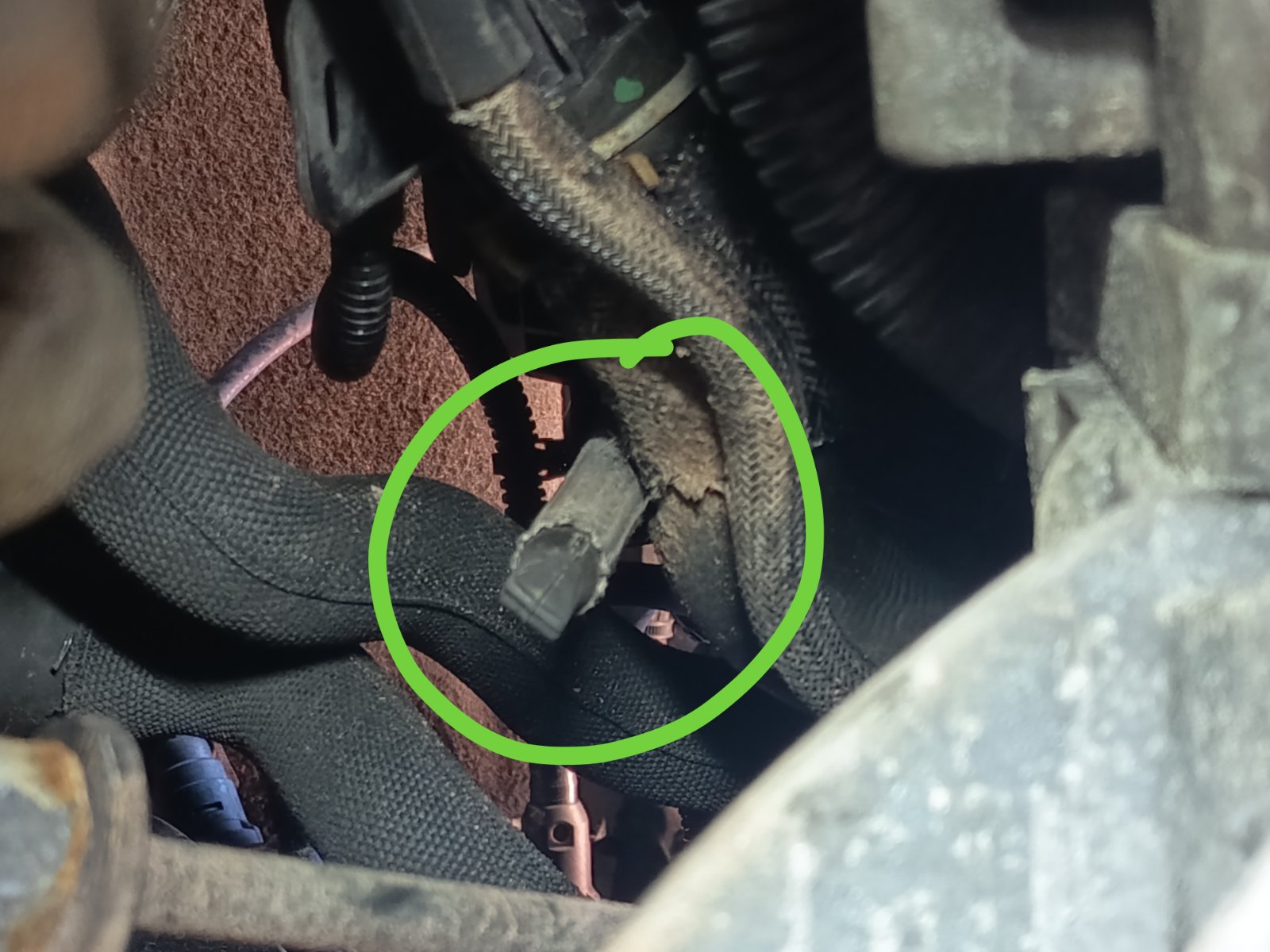

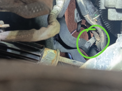

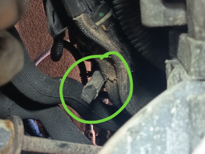

I think its coming from the pipe in the photo ,if not is just above it but really difficult to access
I thought it might be the thermostat housing?
If anyone can tell me what it is please?

I don't understand the green line in the top picture? :)

The pipe circled in Pic's 2 &3 is a drain from the airbox and should be like that. The most common leak in this area is from the thermostat housing. Its plastic and warp's or the seal fails
