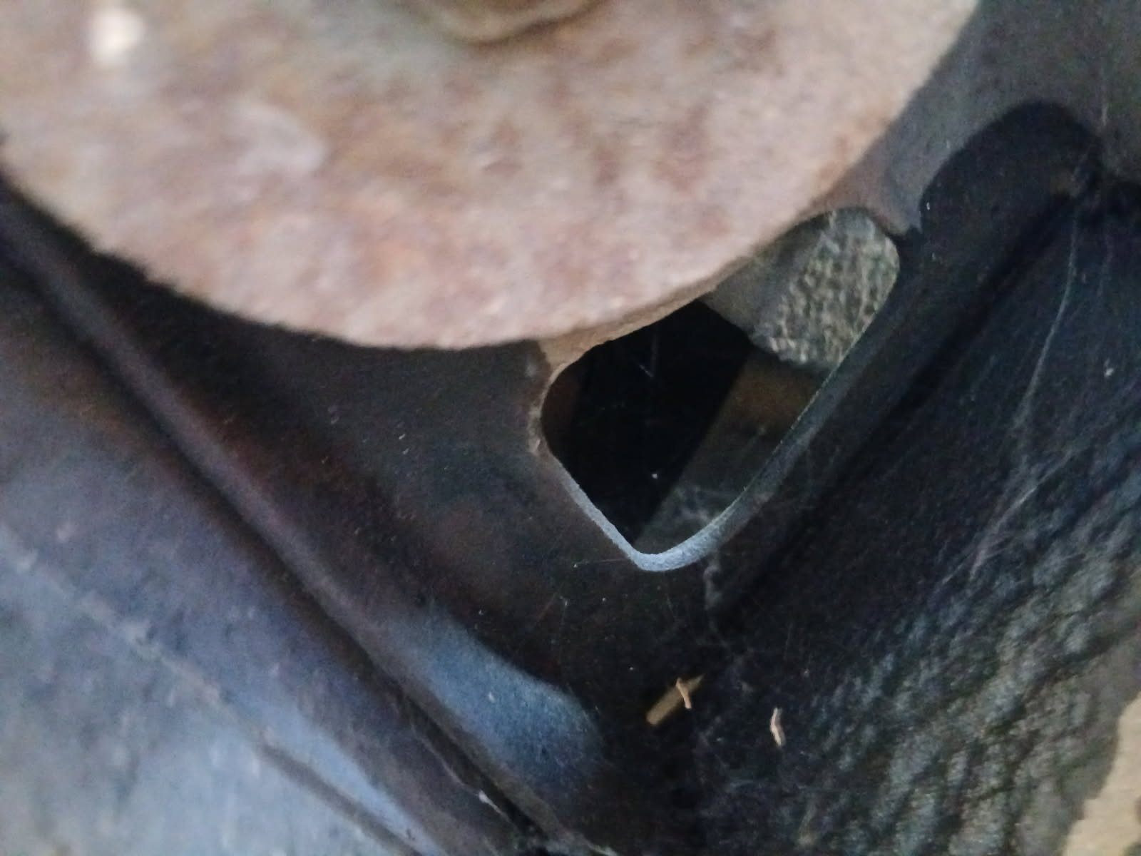

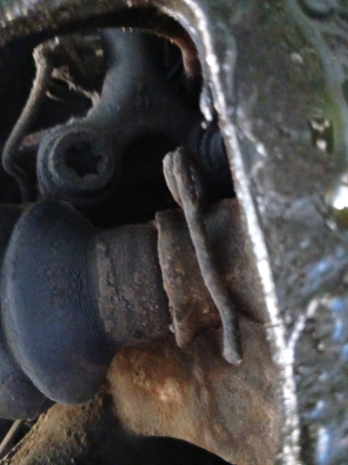

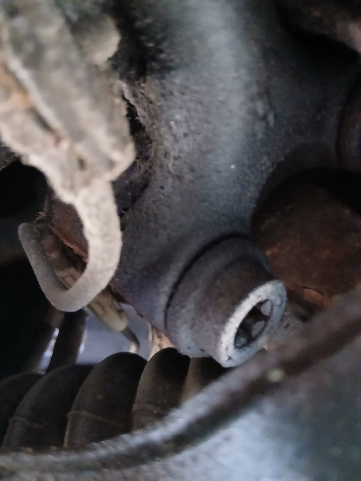

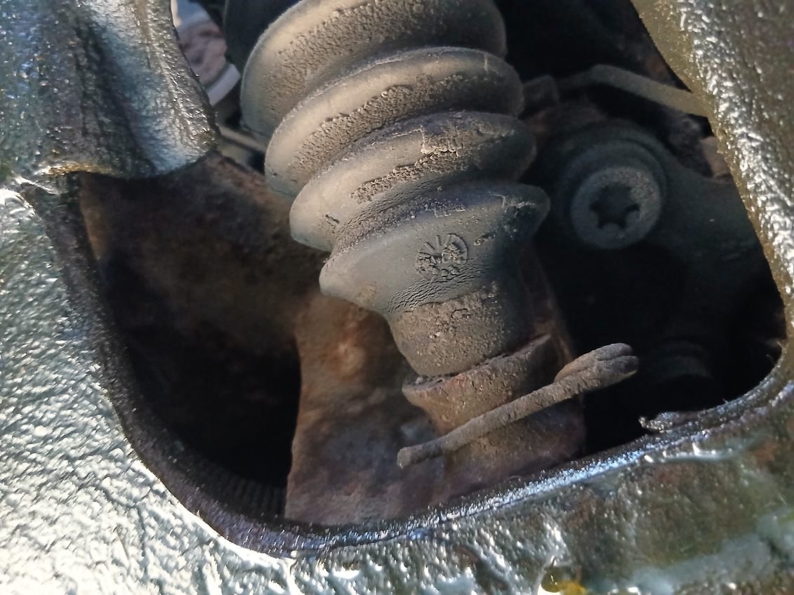

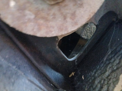

My Xantia (phase 2 2.0 HDi 90, 1999, non hydractive, not activa, and left hand drive if that makes any difference) has sprung a leak. There is hydraulic fluid pooling behind the left rear wheel while it's parked. It's really hard to see where exactly it's coming from.
It looks like maybe a hydraulic hose gone, but it's pretty well hidden, above the axle maybe? She had all new spheres maybe a year ago and the main hydraulic loom/octopus was replaced with what I bet was one of the last OEM looms before they ran out!
Can anyone tell me where a leak in that position is likely to originate, and better still, which part I am likely to need? I don't mind buying multiple parts and using what I need, since all the hoses back there are the same age so if this one has gone, the others will too at some point!
I'll attach the photos my pal took of the surrounding area but I am not sure they are much help tbh. I am hoping one of you fellow Xantia fans will say "oh yeah, I had that, I know what that is" :-D

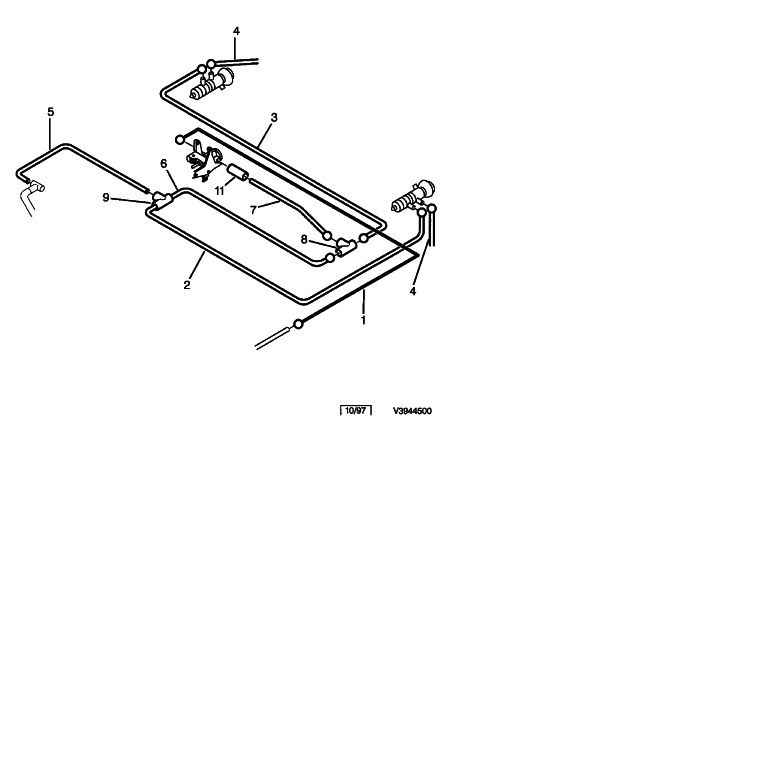

There are Y connecters in the LHM return lines above the subframe. The connectors are made of rubber and will have split.
To access them you need to loosen the 2 bolts holding the subframe and drop that side.
After-market connectors are available, but the quality varies. They are colour coded for the tube diameters.

Part 8 is 5280E2 (red)
Part 9 is 528087 (blue)
This photo is hydractive subframe, but the arrows point to the connectors.

Thanks so much everyone! You were right, it was the orange Y piece. Looks like it has gone hard and broken ....
Thanks a million :-)
