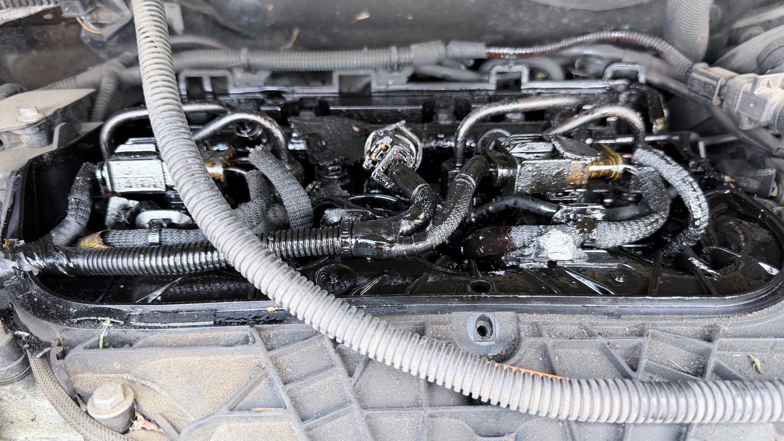

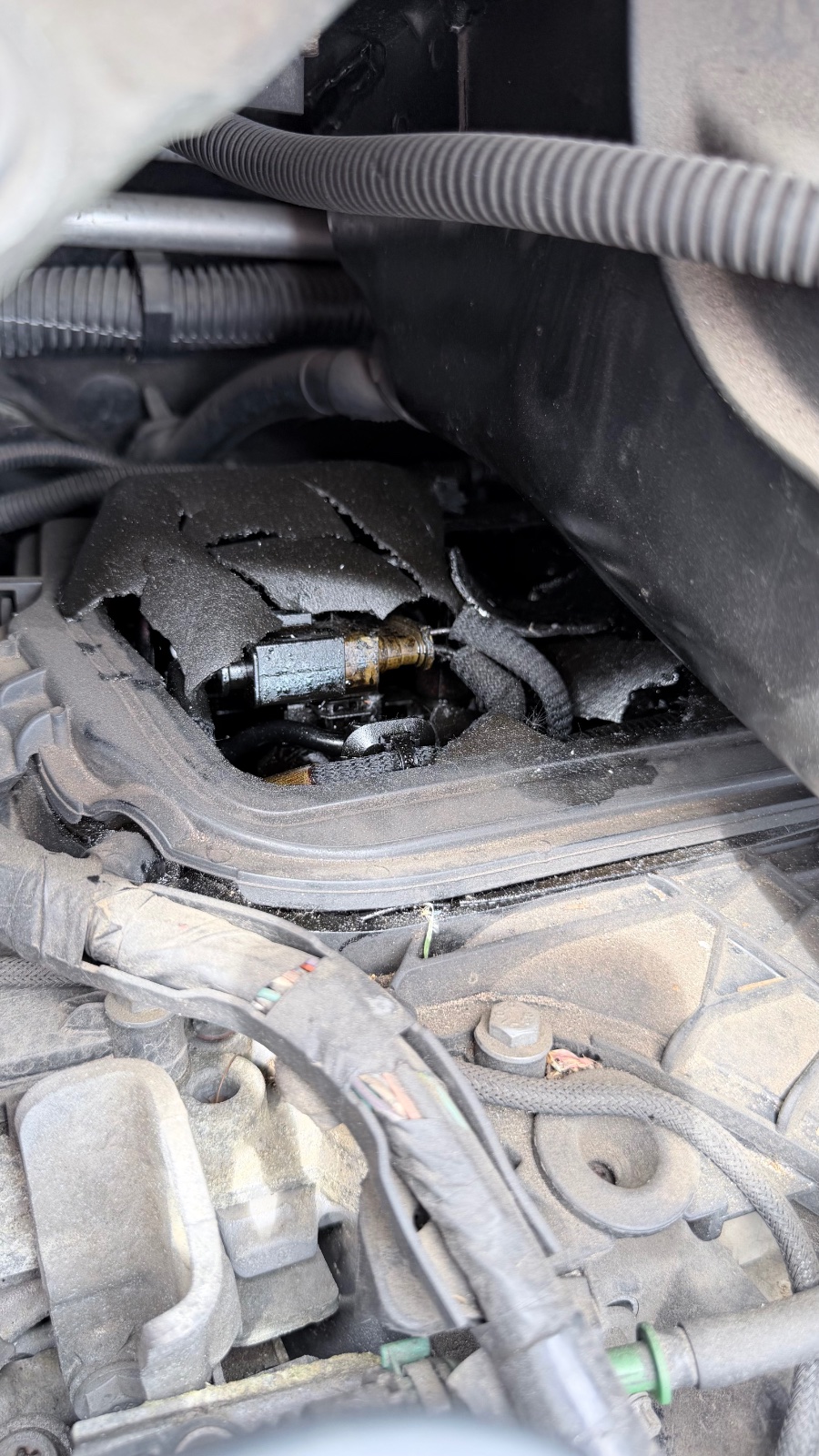

Hi guys,
I would like to get some opinions about what i am dealing with at the moment before I take my van to the garage.
For a while I could smell burning oil now and then but ai couldn't find a source.
Today I open a bonnet and noticed that rubber cover on the top back end of the engine is in pieces, it does look like its melted.
Sny idea what could cause that ?
Thanks in advance

The engine looks quite oily. Perhaps some oil reaches the exhaust manifold occasionally and burns off? A risky situation.

Possibly an injector seal is leaking where it goes into the cylinder head. Are there any unusual noises ?

PaulC5 wrote: 07 Jul 2026, 20:09 Possibly an injector seal is leaking where it goes into the cylinder head. Are there any unusual noises ?
Yeah, especially on idle.
