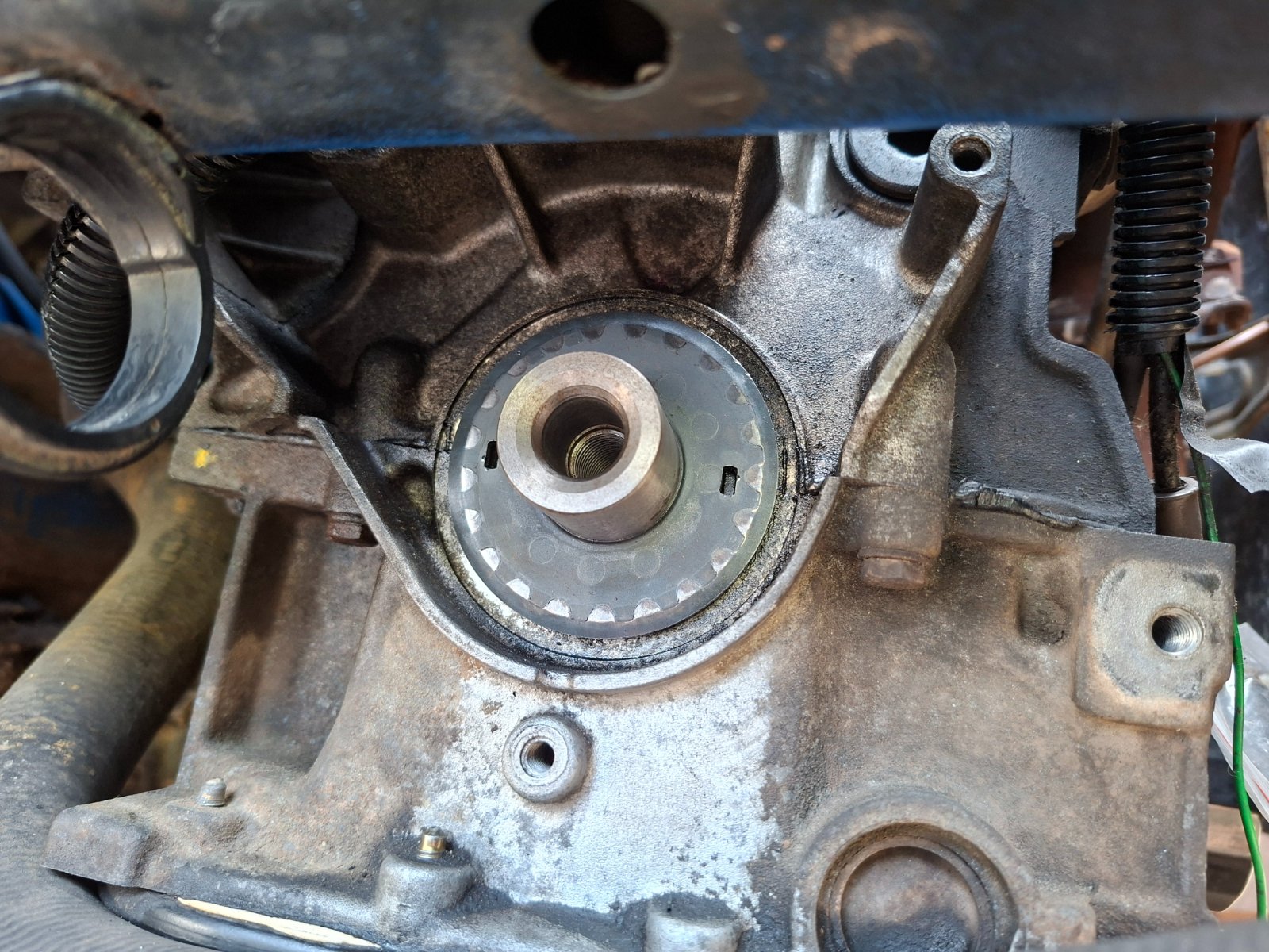

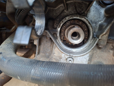

The crank oil seal replacement went very smoothly
My rattle-gun made short work of the (tight) crank sprocket bolt and the seal flange did not even need my special puller to remove it..

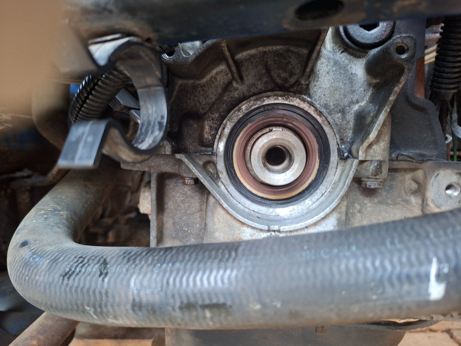

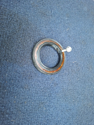

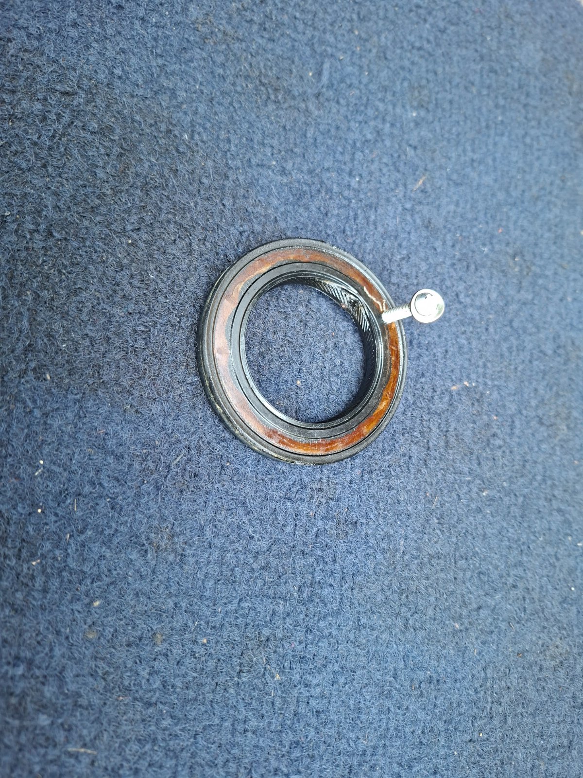

The old seal came out easily using the old screw trick...

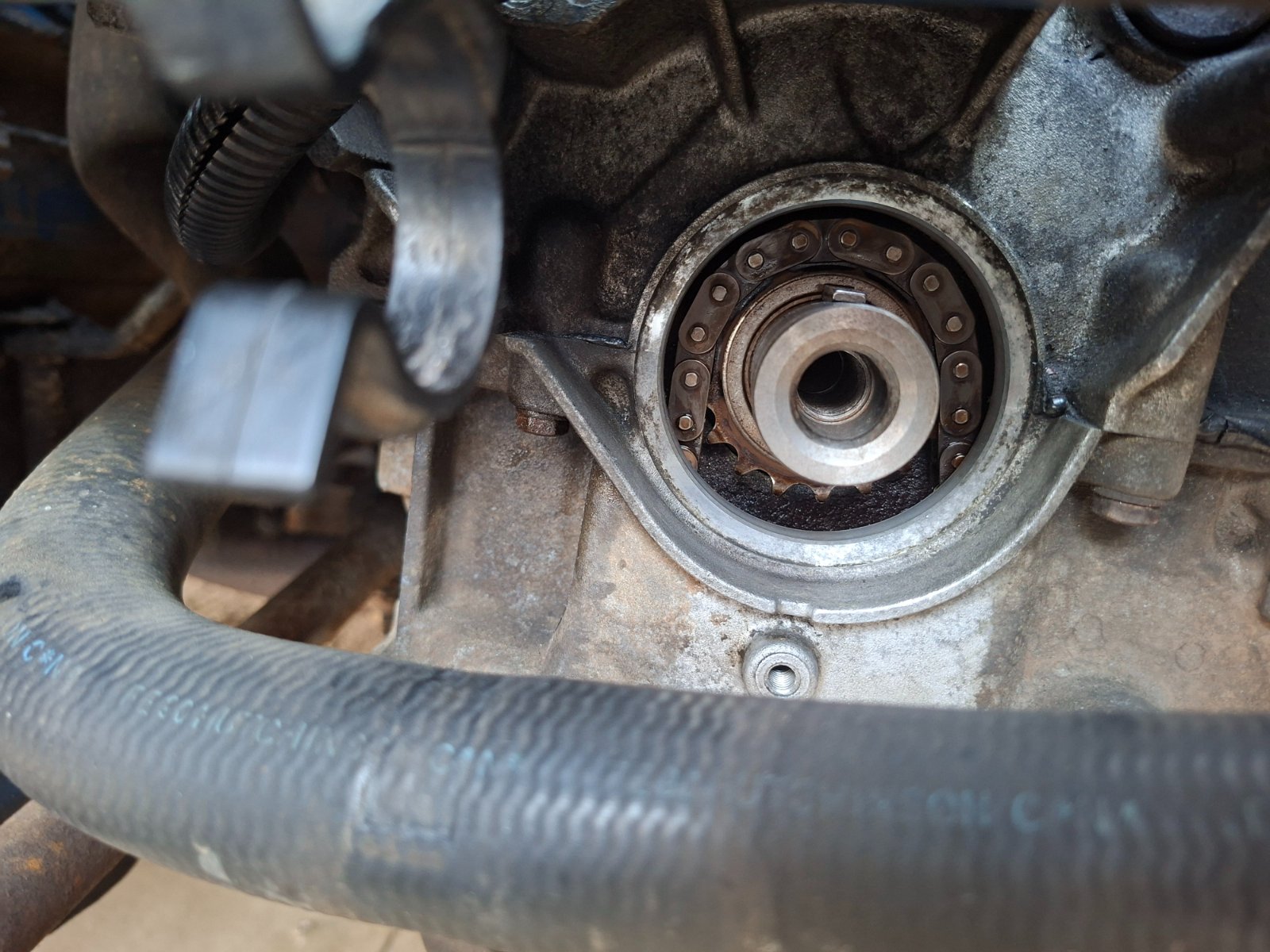

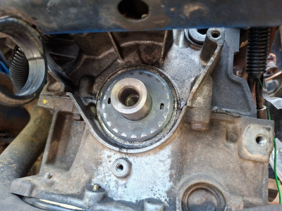

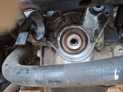

All cleaned up..
New seal in...

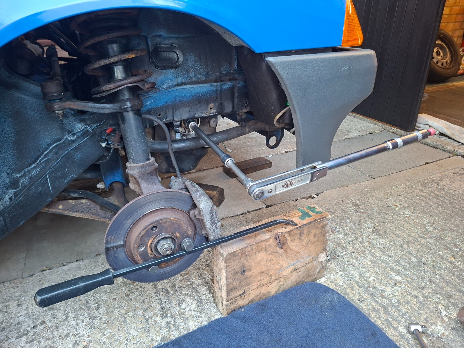

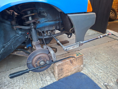

And my own patent method to torque up the crank bolt to 81 ft lbs
All cleaned up..
New seal in...

Nice set up in the last photo Jim , once you get the other parts you need your all sorted then. You do a great job looking after your fave 2 little citroens
