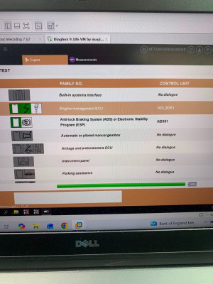

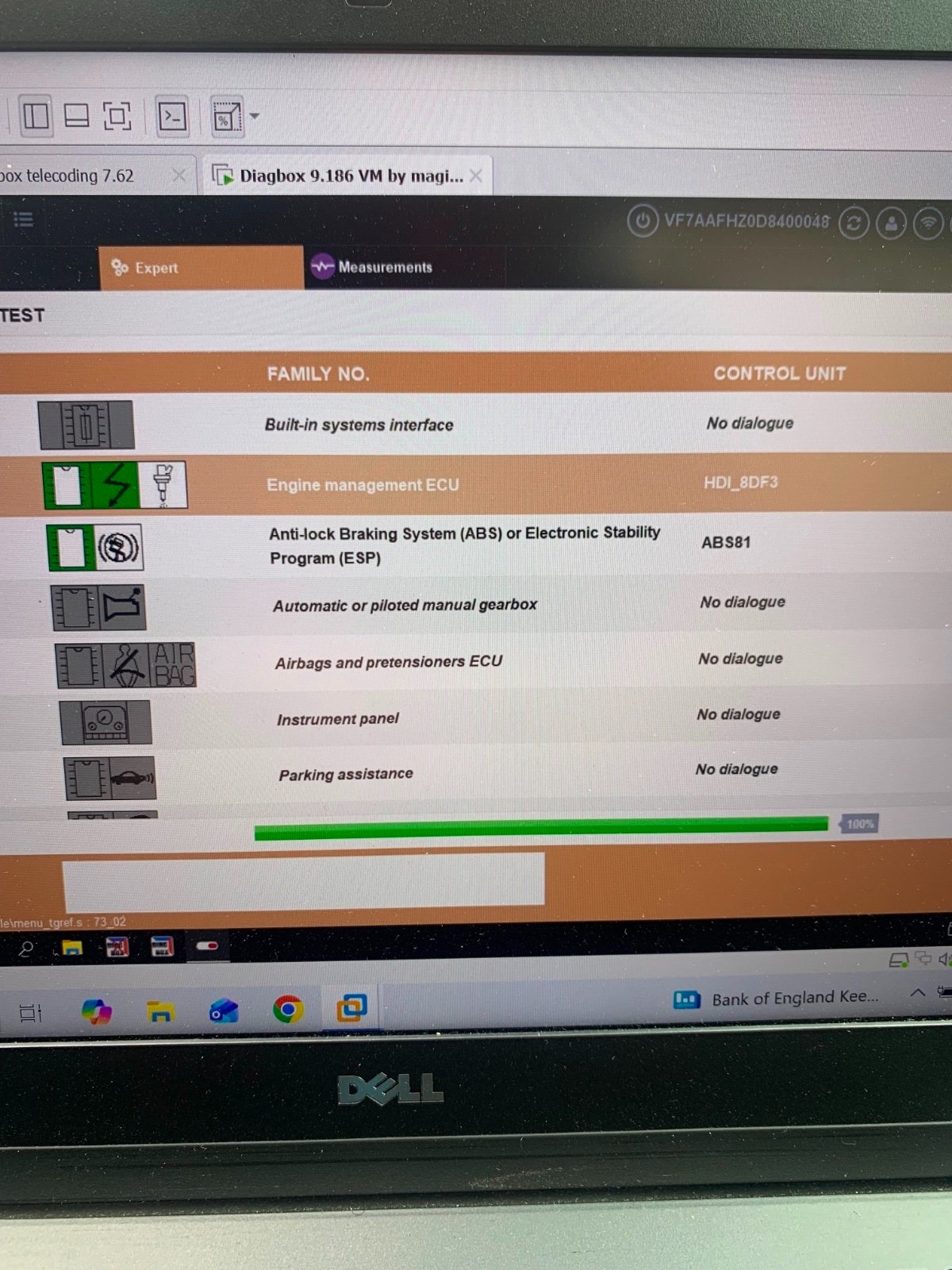

Ive got the free version with full chip adapter and the add on S1279 box as the nemo engine is a fiat
It wont read airbags why is that? See pic
Is there a definite out there that does?

Try doing a BSI reset according to the procedure in the link below and then rescan.
viewtopic.php?p=601679#p601679

What does this mean?
Disengage the motorised function

Have you got the ignition on? There seems to be no coms with most of the ECUs. Do you know the interface works on something else?

Yes, reads ecu no faults, airbag light on but wont read unit no dialogue
