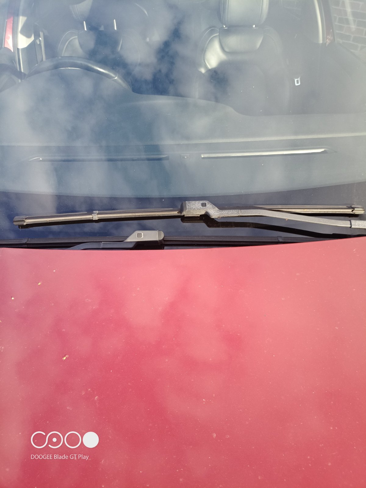

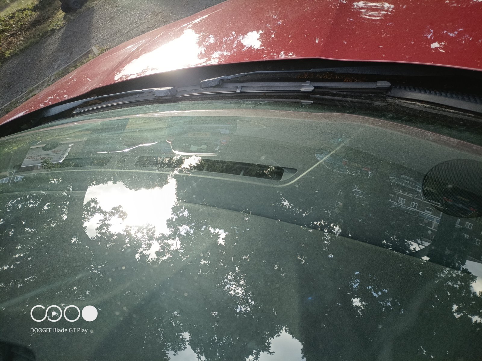

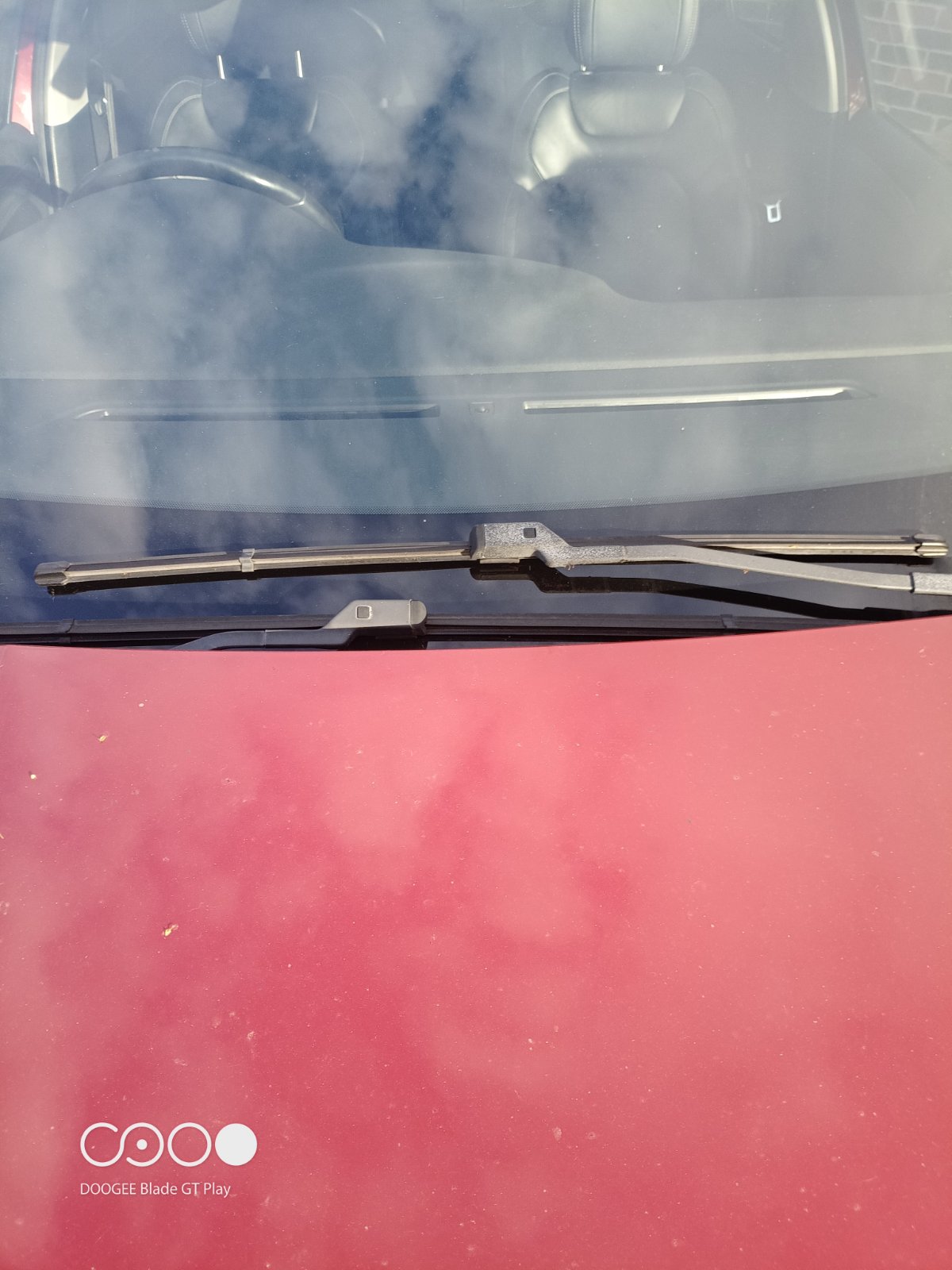

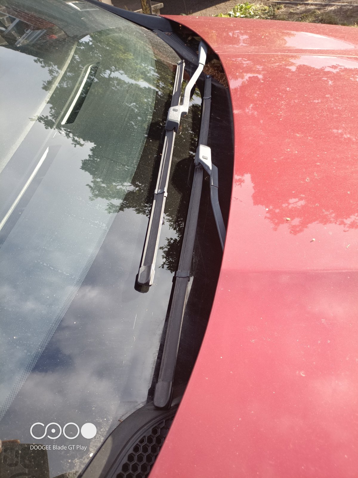

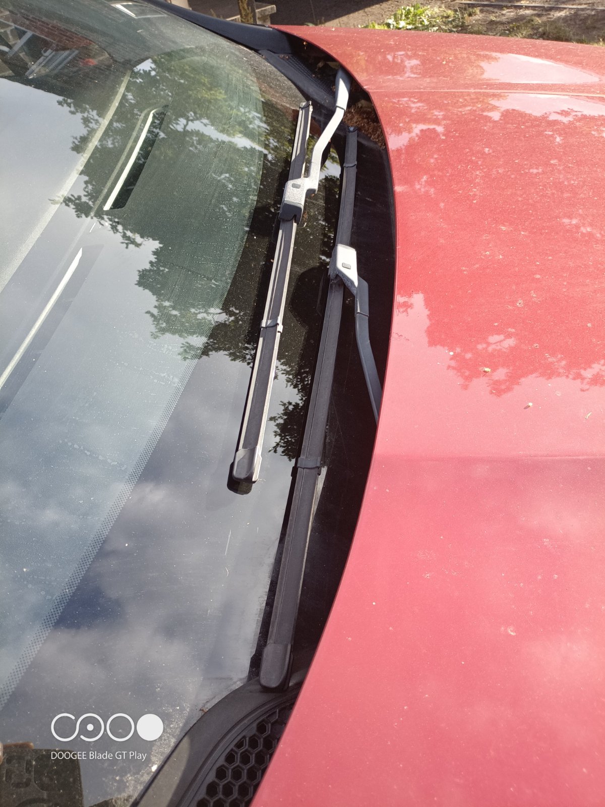

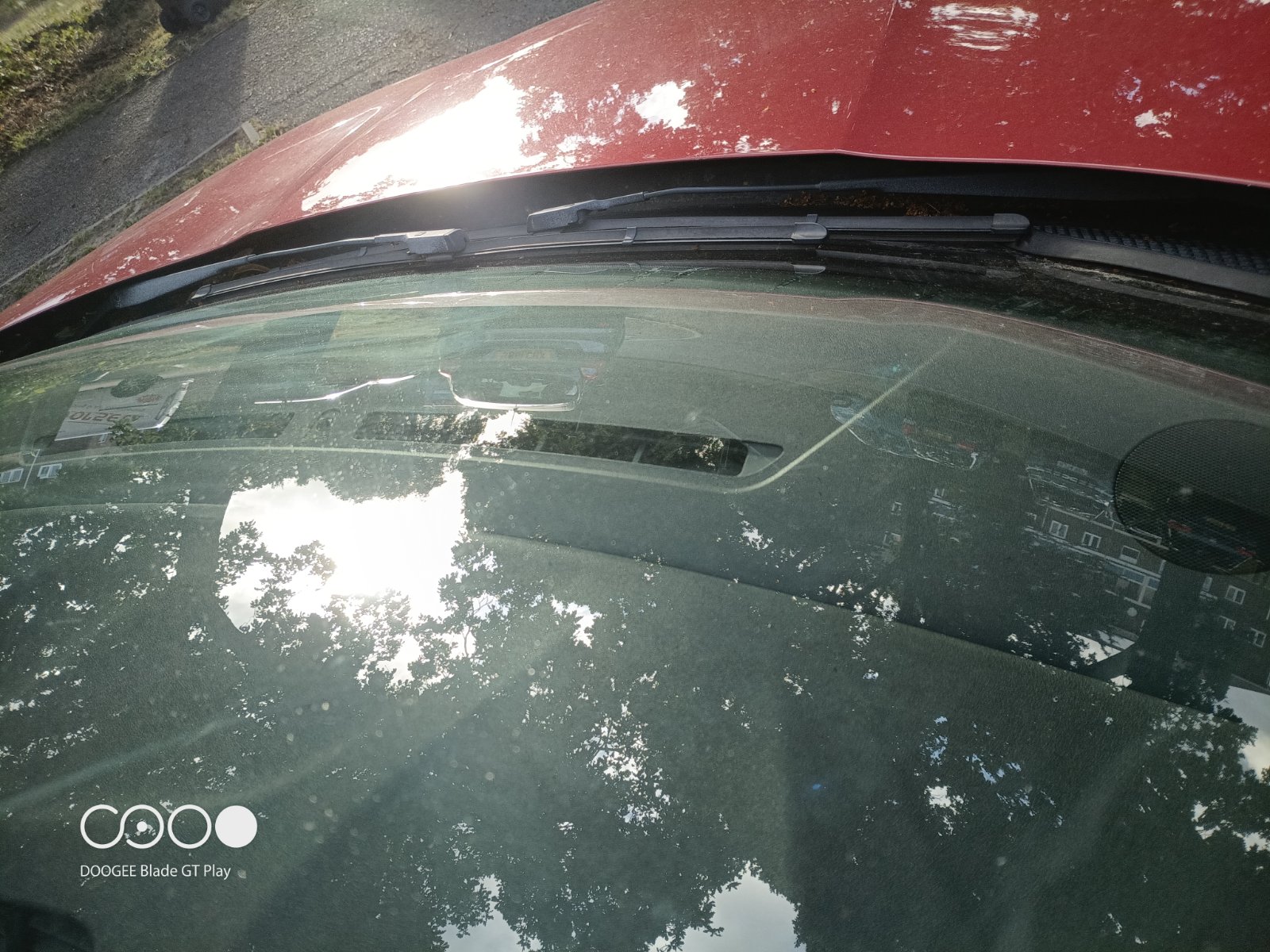

This may or may not help but taken a few pics of how my C4 B7 2010 wipers sit.
Side picture is from drivers side.

Brilliant thanks for the detailed pictures that a great starting pointadmiral51 wrote: 30 Jun 2026, 19:38 This may or may not help but taken a few pics of how my C4 B7 2010 wipers sit.

Well finally something i got right on the ballache of car, the windscreen has to very faint white lines I used that to line up the passenger side wiper the set the drivers just below, seems to work fine gets full sweep to the edges of the screen and parks as per the pics above.
Thanks all for the help
