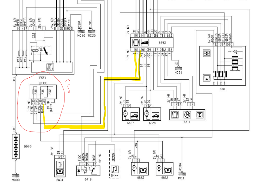

Looking at the diagram and reading posts on this forum I.e. viewtopic.php?t=73076
I hear of/see a fuse referred to as F40.
If fuse F40 is blown (as described in the post) I would not get any power to the roof. Which would/could be the source of the issue.
But where is fuse F40?? I can´t find it anywhere. I have looked (almost?) everywhere and the internal fuse box on my left side underneath the steering wheel has no F40?

I am not sure where this (interior) fuse box (BF00) lives, but it gives a clue what to look for...
c3_pluriel_fuses.pdf
(193.6 KiB) Downloaded 40 times

Here you go: Image
It looks like it is behind the glovebox (inset C, which is in inset B).

xantia_v6 wrote: 30 Jun 2026, 18:30 Here you go: Image
Hi @xantia_v6. I have the non-UK version which mean the fuse box is next to the steering wheel. Already looked there.

Yes for LHD the fuse is behind the steering wheel. It be above (maybe behind) the normal fusebox.
